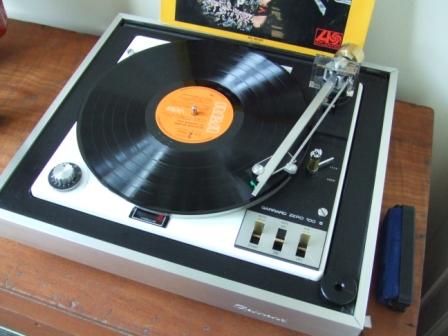

Help, I am falling in love with a Garrard Zero 100S!!!
The question is at the end, first my story.
After almost a year orientating for a new tt I decided to buy a Garrard Zero 100 S from EBay. I choose the Garrard mostly because I want to try an idler drive and less for the arm with the zero angle fault because with a normal tt the fault is only a few degrees. And off course its price, it’s a steal, much cheaper than 301 or 401.
When I opened the package I also felt for it looks. The arm and platter looks great, even my wife agreed, this is a nice piece of audio equipment. But from a total different design than his famous brothers 301 and 401.

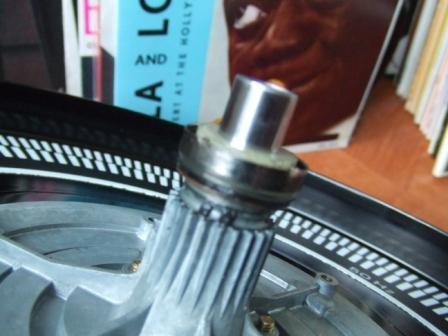

Worst than I expected. A big disappointment, what a rumble, unbelievable!
But wait, this is no rumble, something is wrong! After a while I discovered the fault; bad connections in the tone arm, there is a sliding cartridge holder with some metal strip connectors. I cleaned and bend them a little to make a good electrical contact.

About the rumble. There is some, when I turn the amp volume at 70% level and with silent passage of for instance classical music. It is more than the direct drive Sony, there is more detail so also more rumble. But is rumble the only thing to the quality of an tt?
The reason for choosing this Garrard with (obsolete?) idler drive technique is that I am aiming for a more controlled drive which hopefully results in a tight base a good quality mid but probably a messy high because of the bad bearings of the special arm of the Garrard. And of course there is rumble to expect.

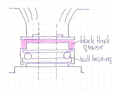

I have a Garrard 100 too. I replaced the arm on mine as I didn't like it.
The Garrard is a good performing idler but it isn't great. The bearing is a ball bearing race and this is noisier than a standard bearing.

The bearing and the arm IS a problem but these can be replaced or tweaked to make them into something acceptable by audiophile standards.

I think the main bearing isn’t a problem. But the bearing is a bid strange to me. Seems to be a combination from a grease slider and a ball bearing. I cleaned the ball bearing and re-greased it. It is maybe not the best but it was and still is dead silent. Can someone explain how it works?
But there is a tweetie sound somewhere. I am using my stethoscope to locate noises. Probably next weak ill have some more time.

Triumph said:The bearing in a drawing. Can someone explain the greasy part?
I can't quite follow your drawing, i.e. whether the grease part
is part of the thirust bearing, it appears to be, and then you
ask with the ring ball bearings what is its point ?
Can only guess here than somehow the grease is slowly pulled
onto the main shaft and down to the ring ball bearings, so the
purpose of the larger square section of grease is a reservoir.
🙂/sreten.
New drawing. It is more complicated than I thought. I also discovered an ‘O’-ring. There are different sliders from bronze and plastic and a ball-bearing.
The grease part puzzles me. All together it seems to me a delicate piece of technical design. But still simple and not really high tech, like ceramic balls or in that order.
