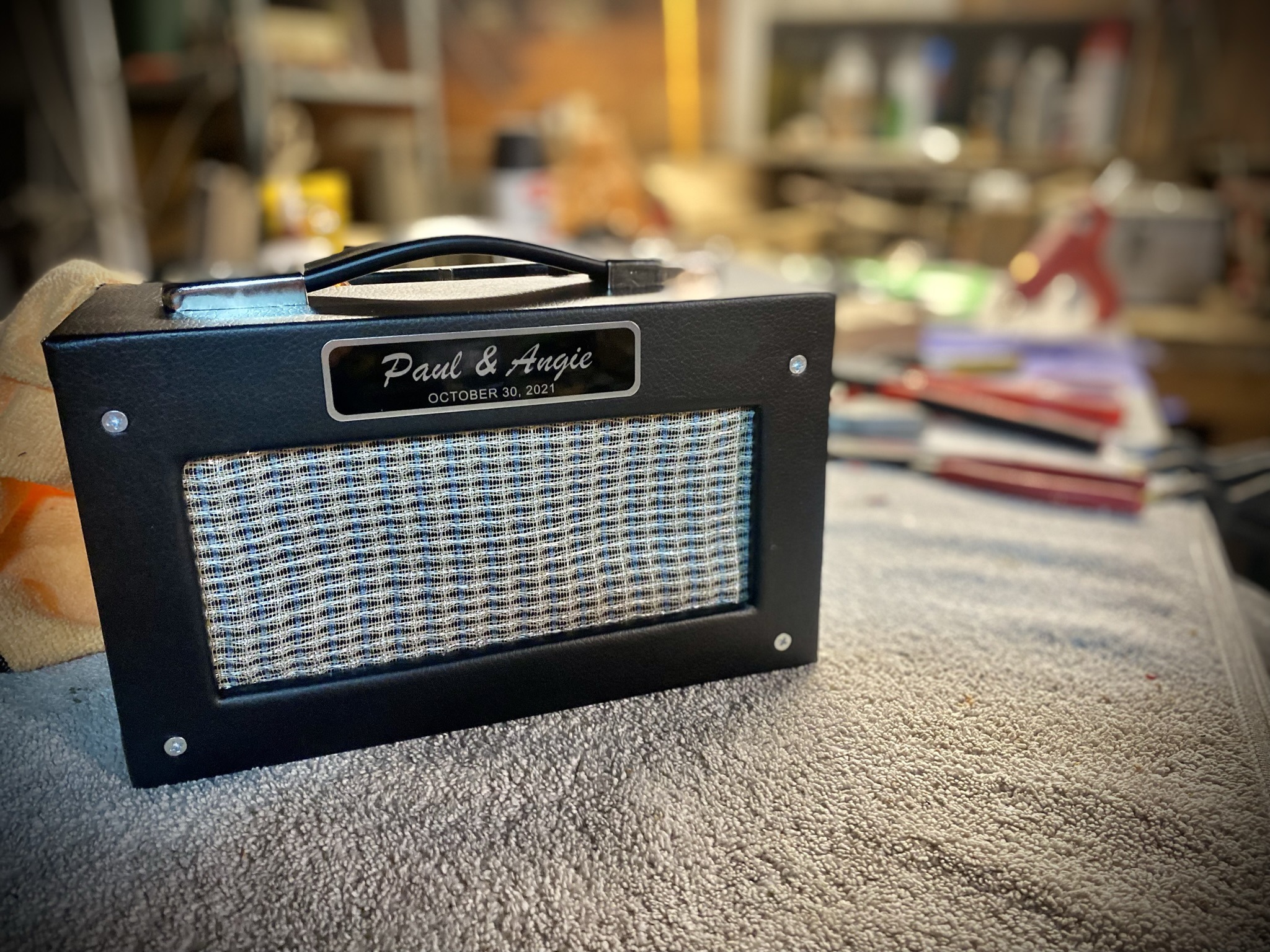

Hey y’all, I got busy and forgot to post an update…

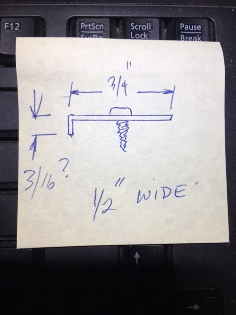

I decided to try some particularly strong hot glue, and added 4 small wire clips (they’re basically pressure-mounted to the speaker rim, basically a safety) with some very shallow screws.
So far so good! I’ve been testing the hell out of the whole unit with zero problems. And most of all, the desired look of the speaker baffle is what I was going for above all else (for this particular recipient, anyway. He’s a style over substance kinda guy)
Currently powered by a basic TPA7492 board running at 19.5V/4A (to best suit the 4ohm drivers/tweeters). Sounds pretty damn good, but I’ve got a cheap NVArcher DSP-equipped TPA3116 on its way from AliExpress. Excited to play with that board and see if the DSP can make much
difference in this build.
Meanwhile, here’s a few updated pics.
