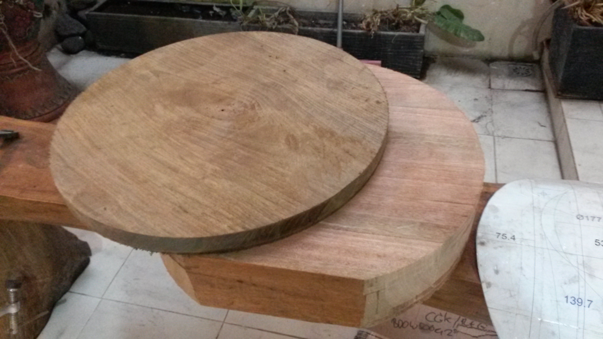

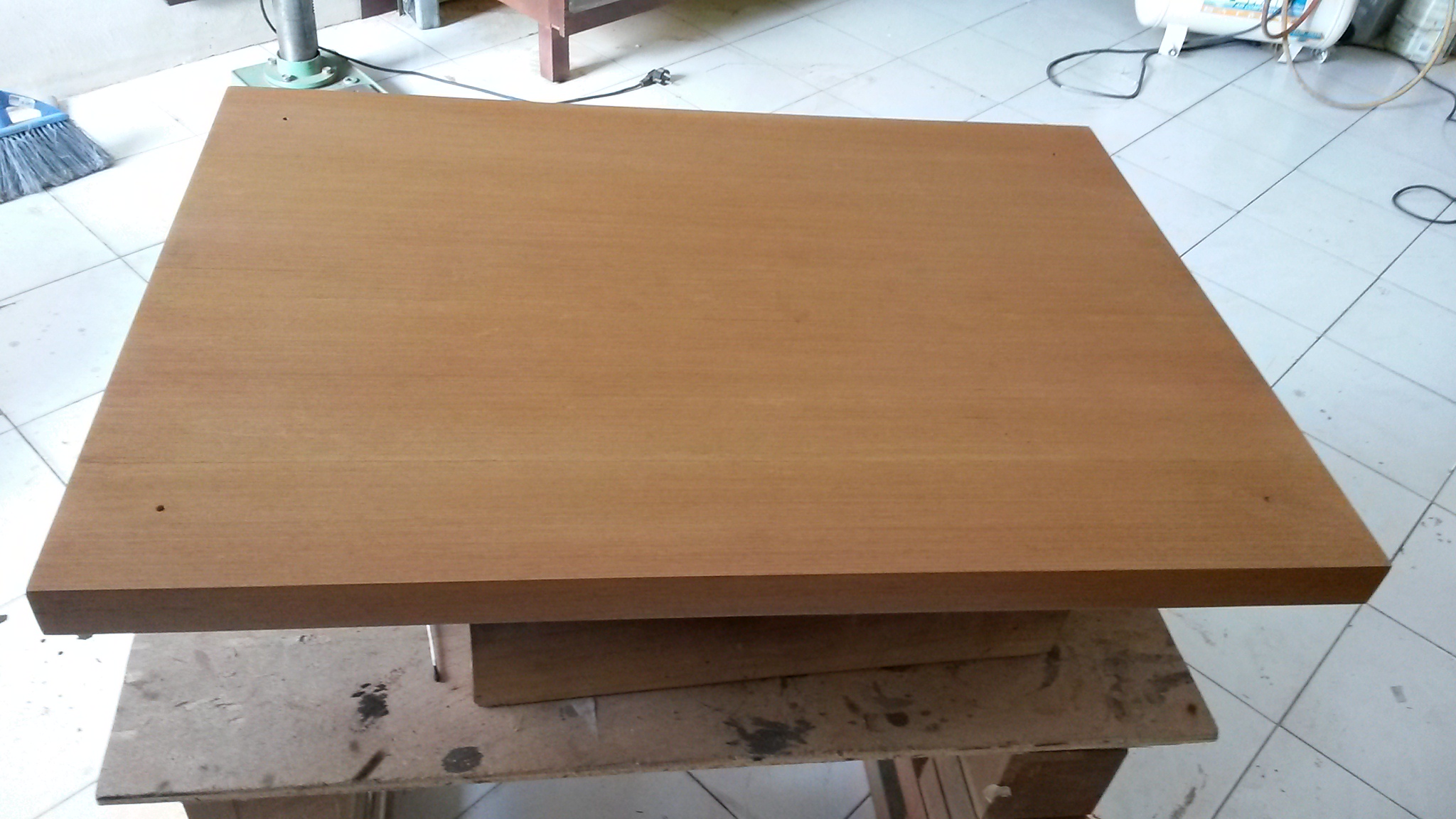

Hi Rolf.
thank's Rolf.

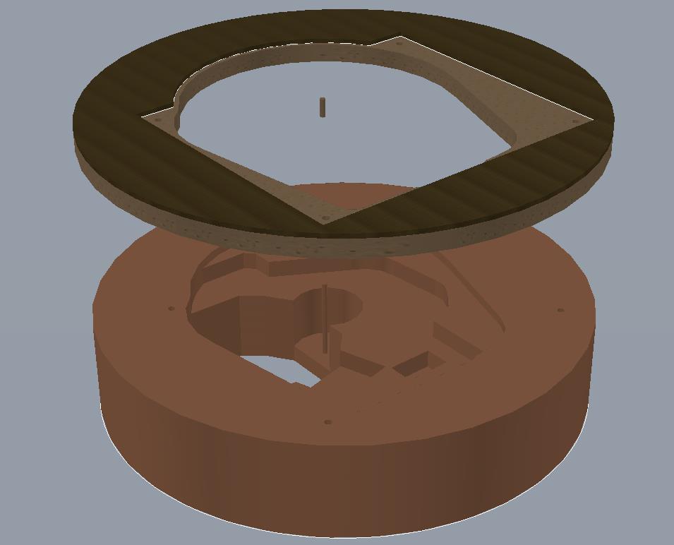

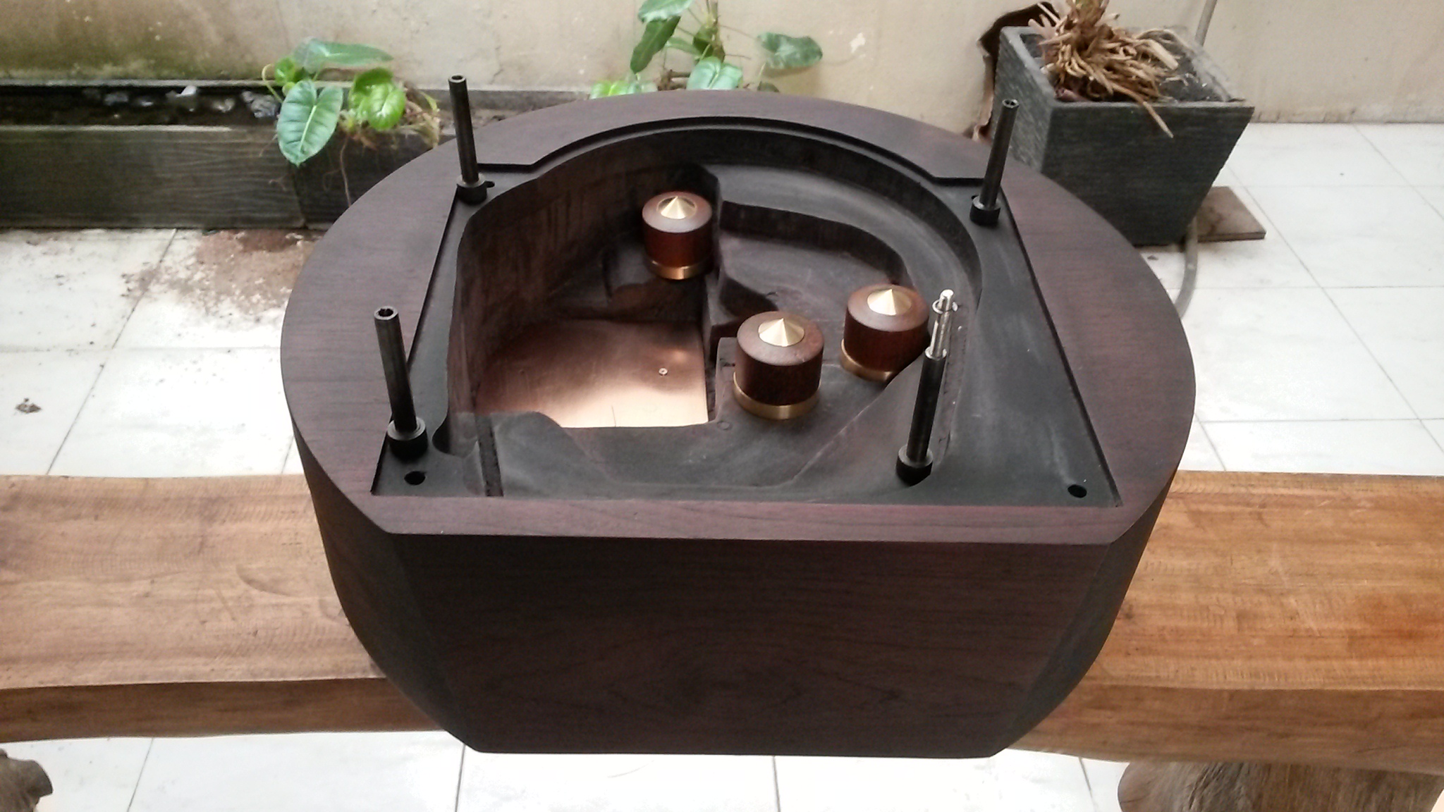

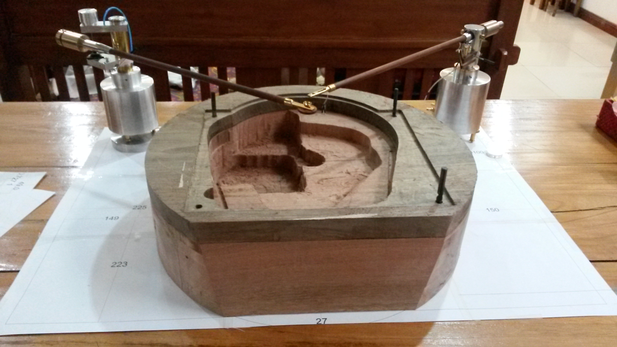

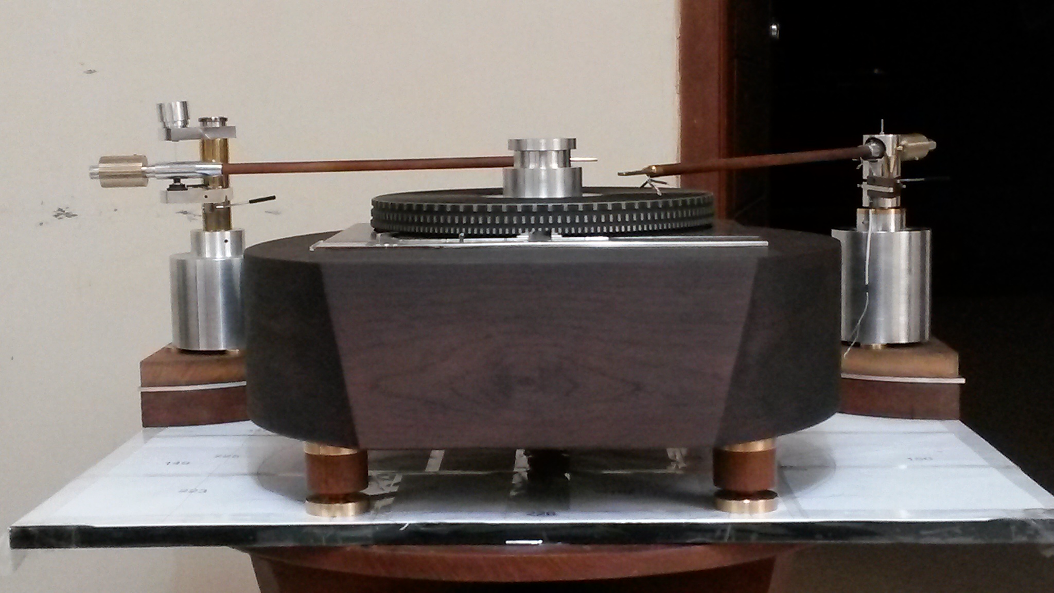

i'm a newbie, not experience make plinth, this my first project.
Micro vibration, i do not know this is wrong : D
Because when i play the vinyl (more Bass / low) and i turn the volume to high, rise like hum ... (low) and i think the cantilever like tremor ....
and i think this may be resonance from the lower sound.
when i turn to low volume (NORMAL) or i lift the arm the hum disappear.
my diagnosis from symptoms ...: D: D: D
DD (differential diagnosis):
lower resonance vibration from sound
humble from the motor.
and i do not know what happen? confused: D
and opinion from "Stanton" my plinth need to repair.
regards
ed
Dear ed,
you should go for rubber rings between Garrard´s motor deck and your plinth as it is mentioned in the Garrad manual also. This limits any mechanical resonances to be transported from the motor deck to the plinth.
If you recognize any resonances after you inserted these rubber rings then you need to work on the motor.

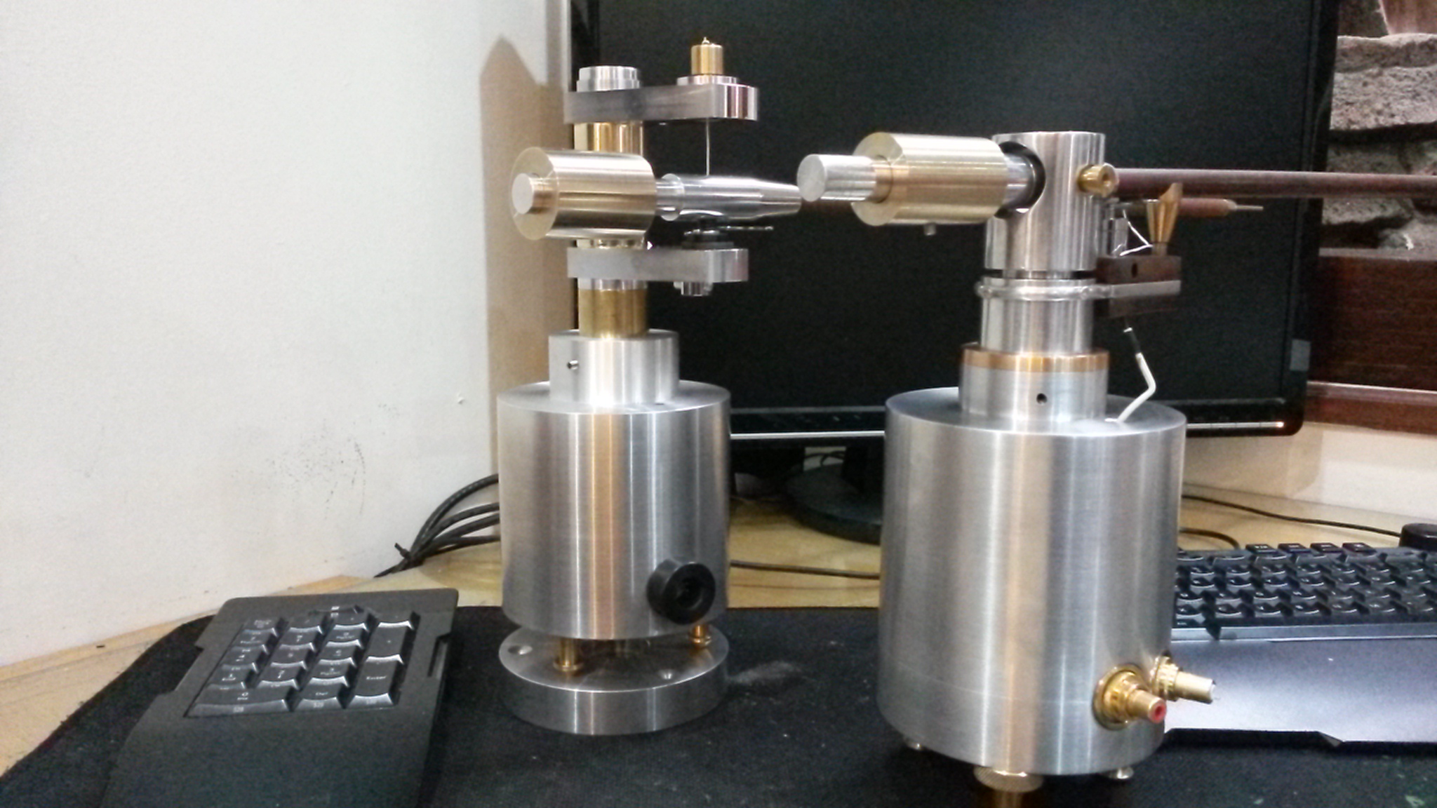

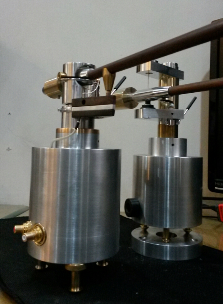

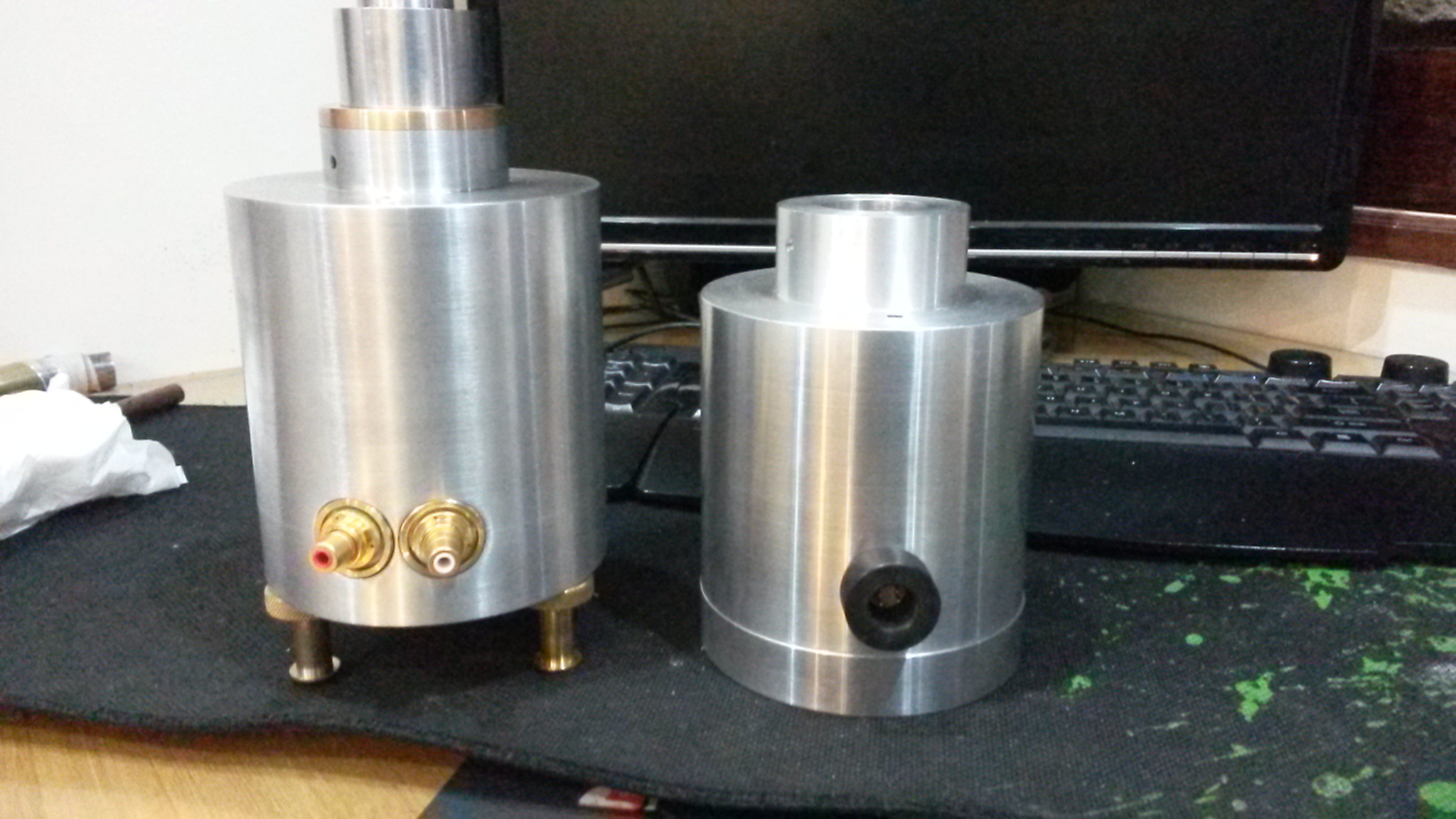

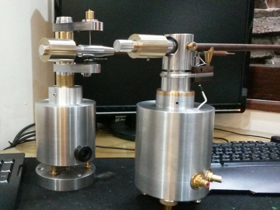

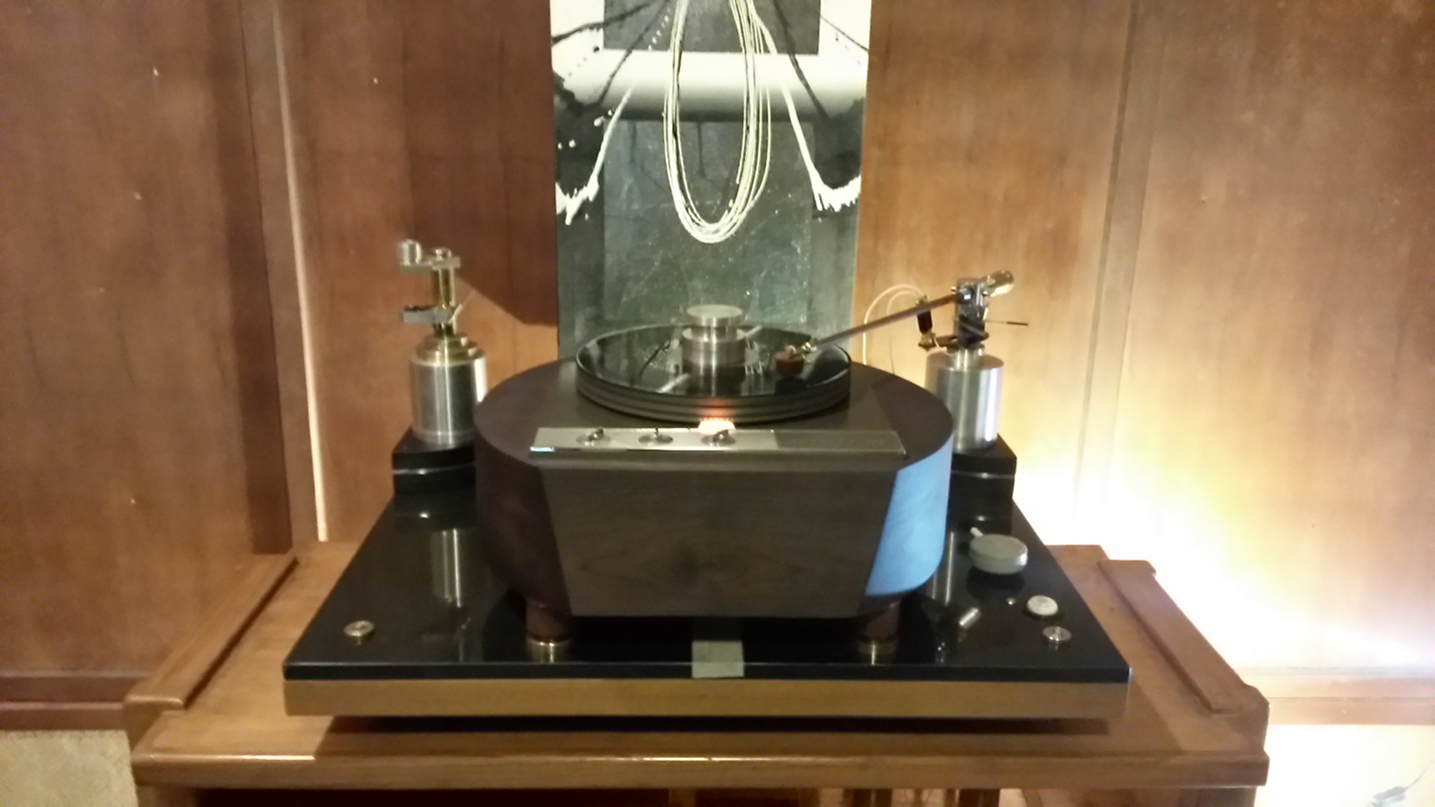

I just finished wiring, tonearm magnet version Schroerder and finished trying.
regards
ed
this is my upload video of DIY TA magnet cloning schroeder.
My DIY tonearm version schroerder.... magnet, put in pivot to hole of arm base.... go down very slowly.... vacuum..... pneumatic

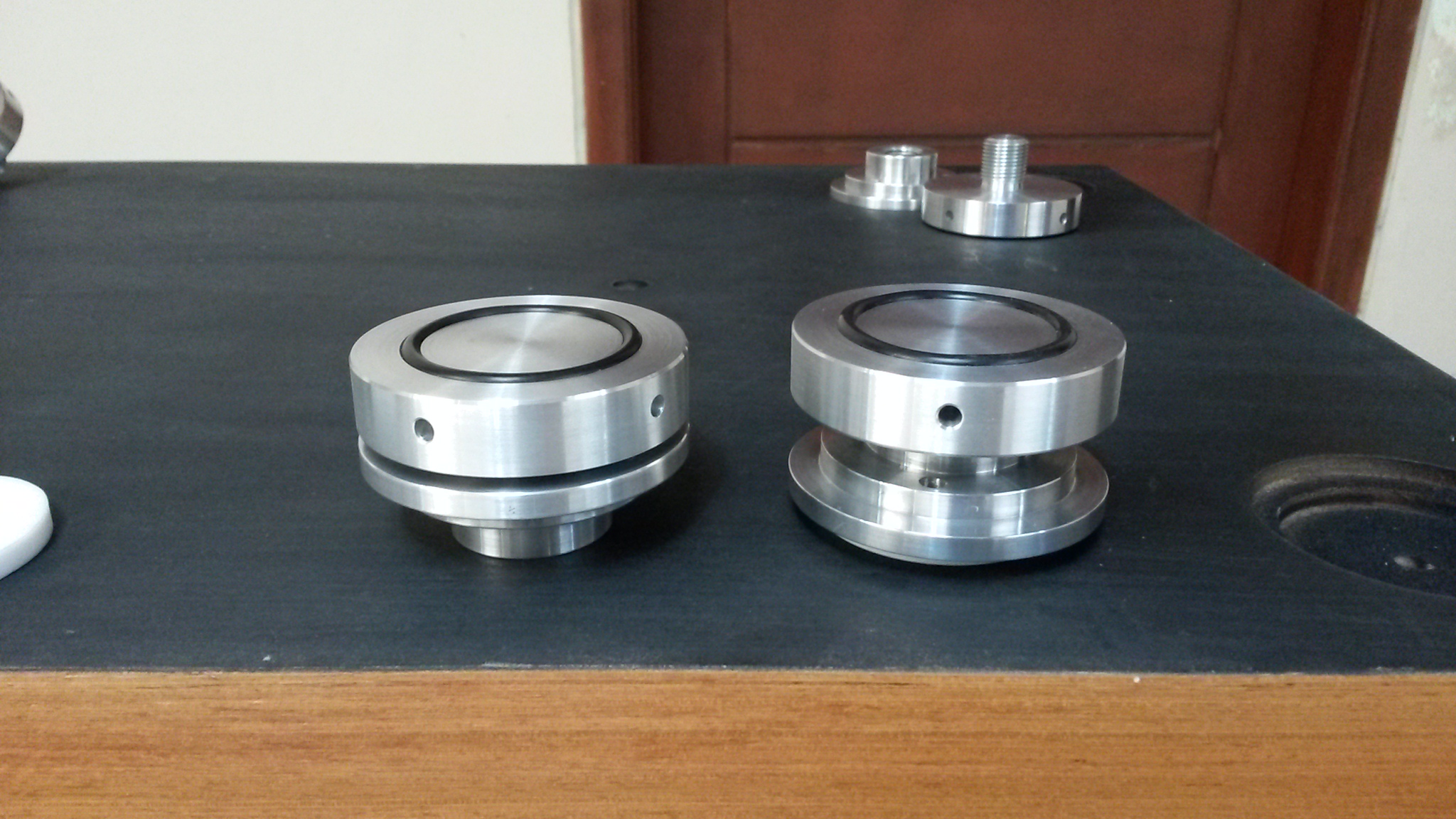

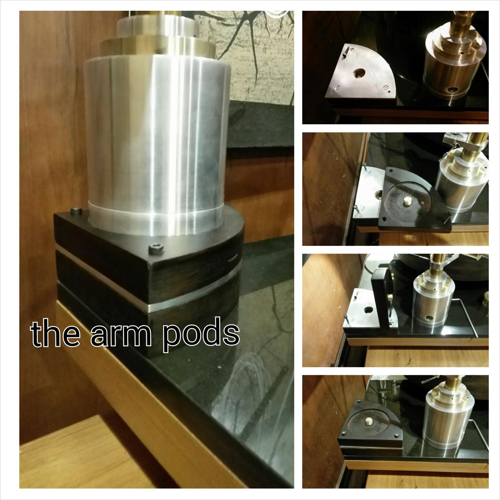

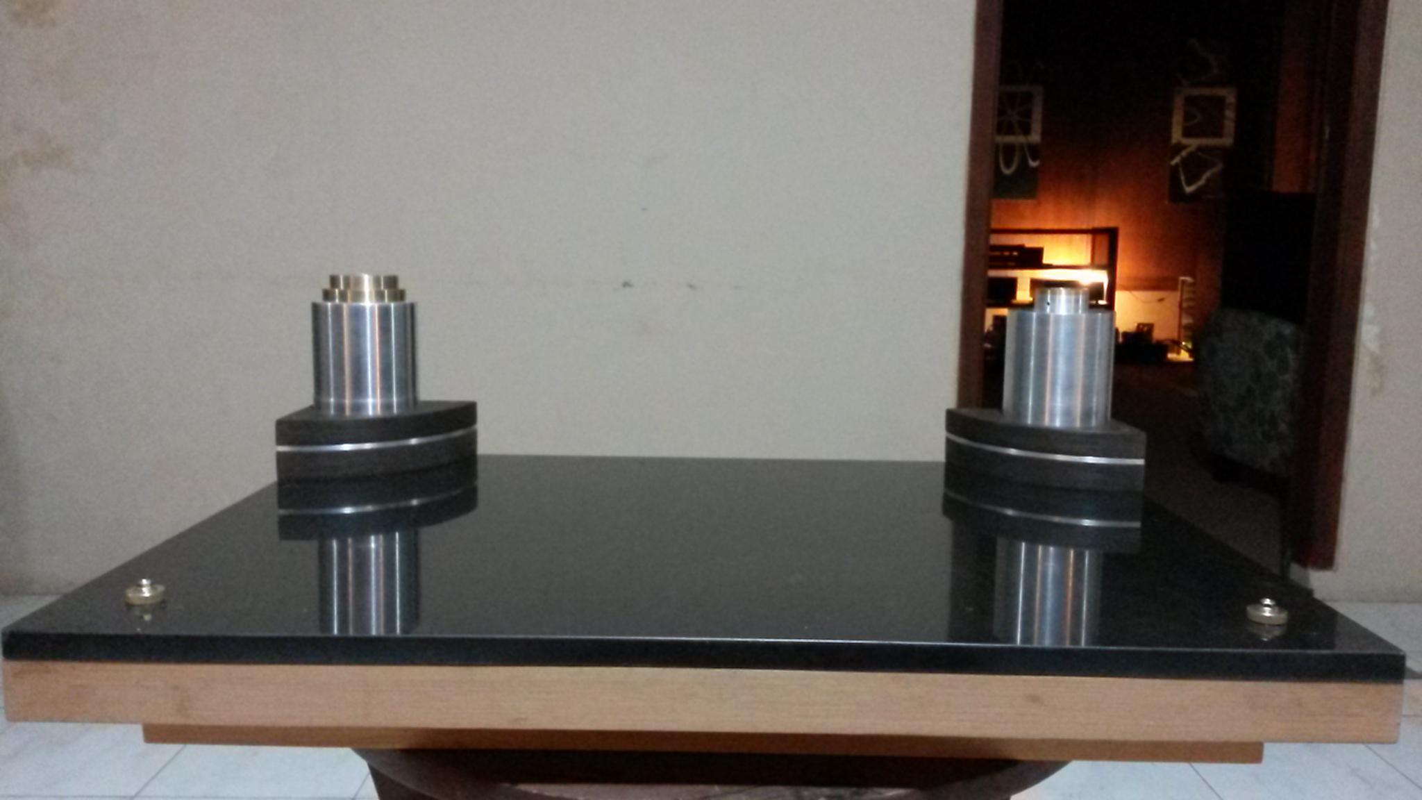

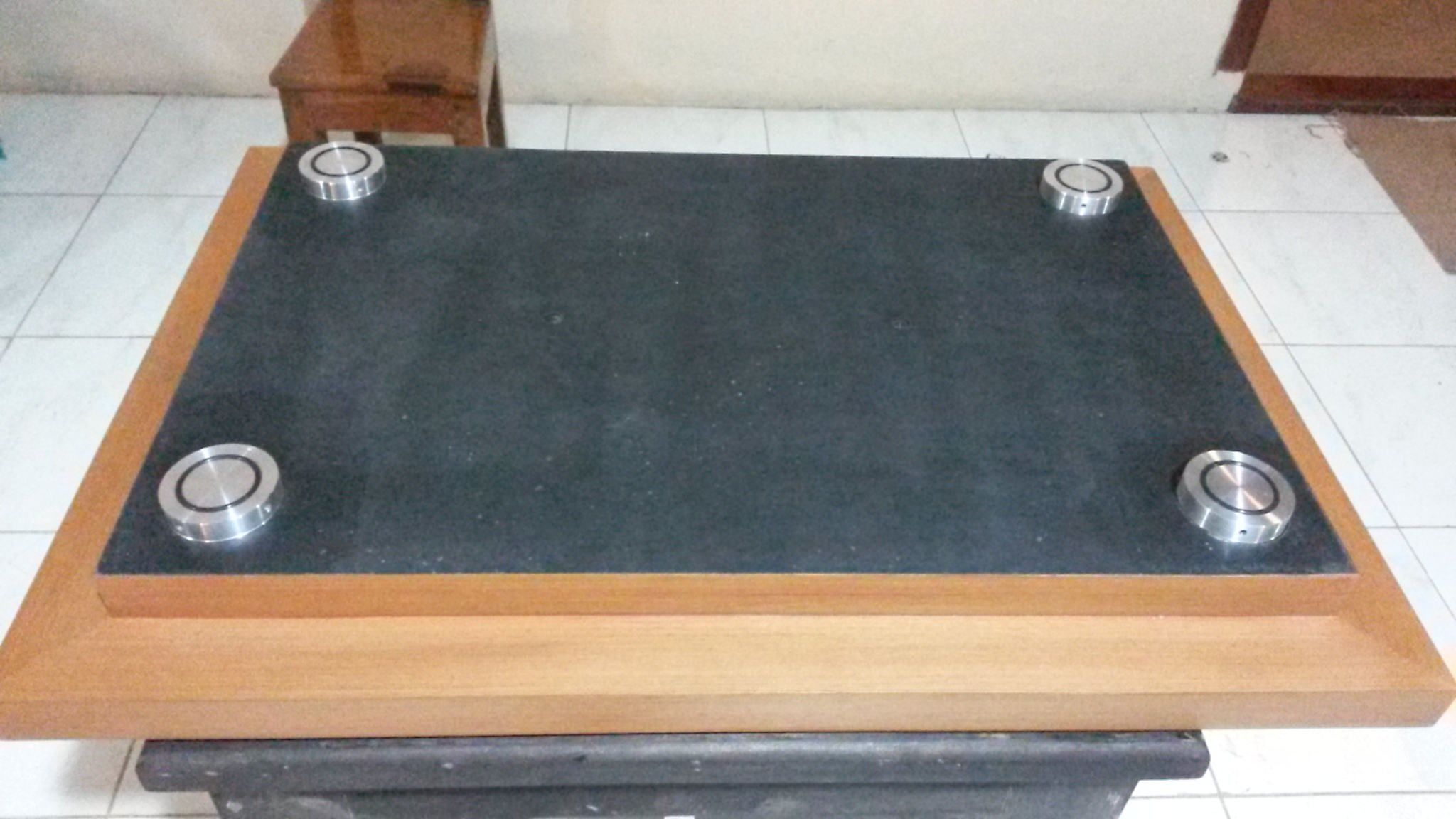

Hi "Stanton"
Last day i have tried to full attach wooden base arm to plane granite.. and i give 3 ball bearing Between the basearm and pod basearm. Become space and not body contact.
This is give up a sound become detail. And for attachment of plinth to plane i still planning how i do.
Full contact or with center spacer contact .

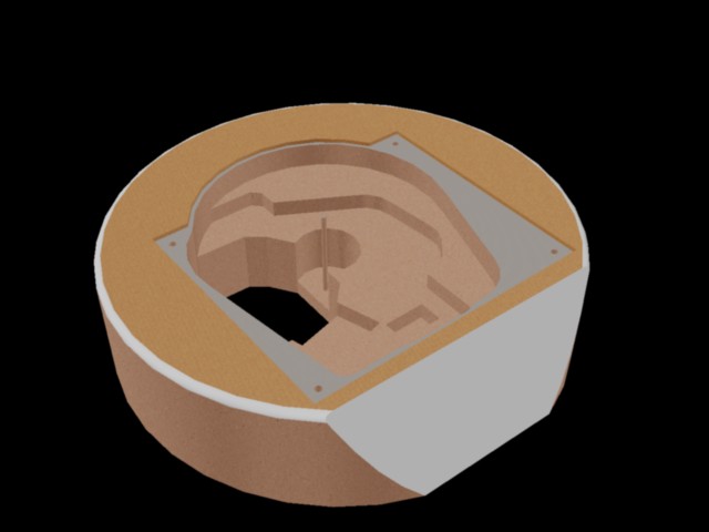

Garrard 401 Plinth measurements
To get a better insight about what the plinth does to motor vibration from a Garrard 401 drive I did two vibration measurements with a testrecord .
ref.signal 315Hz at 5.42cm/sec. and motorvibration on 100Hz .
A better build console gives an improvement of 15 db !
First one with a four layer 15 mm plywood .
Second one with four layer 18mm birch plywood and one toplayer 18mm mdf.

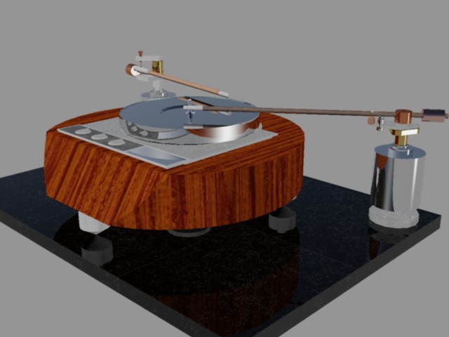

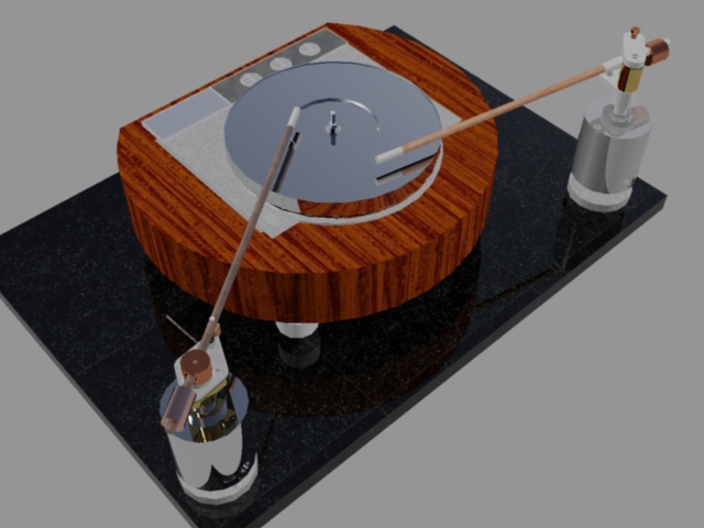

how about which i apply granite and mdf ?
in my mind garnite give rigid.. and leveling. but that have large resonance effect , for that i give at below 4 layer MDF for damping and reduce resonance from granit.
for temporary attachment granite to MDF with bolt.
if i sure. i will give glue (full attach) . i have done to my "pods" armbase , that become detail.
i have not good measurement.
and i have cek and setting a motor and pulley to idler , and tight bolt magnet to chassis and not contact to a part of motor or chassis.
Maybe I'm not sure never tried it save bet on several layers birch ply !
