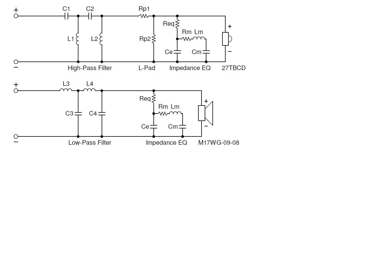

Hi I just finished the design of the cross over by LR-4th order for the 2way system. I did by the software Xover Pro which produced the tradition parallel design. However, I need spend a lot for caps and inductors. Is it possible to help me to change it to series design which the tweeter and woofer can share the component. I can then make a save Please
That is completely the wrong way to design a crosssover, acoustically
it will not be 4th order L/R and it will not very good either due to lack
of baffle step compensation.
Study the first few links and FRD Consortium tools guide
rgds, sreten.

series are a pain to design above 2nd order, and not worth the bother (& have the same component count as the same order parallel).
I wonder why you need 4th order xovers anyway?
if that's a Seas tweeter, 2nd order is ok & it won't need all that 'impedance eq' stuff,
& Sreten is right, you need to factor BSC into the 1st LP inductor (L3)
Thanks sreten and PeteMcK for your comment My purpose of this xover is to test and taste! I have no experience in design a xover. I also have no experience in auditing the speaker by 4th design. My existing PMC TB2 is likely a 2nd order design. I want to change it to 4th order and listen. I can then see/listen the difference in the sonic performance under 2nd and 4th order. That is the purpose to modify it sreten I don’t know what is happened about this design not a 4th order. I just click the button on the software. Just select the order and cut off frequency at 2000hz but the design is mainly basis on the DC resistance of the driver instead of the driver impedence About FRD, I tried already before the xover but I can’t see the difference… About the diff compensation, I did! I allowed 2 to 3 db more at L-Pad at tweeter due to 3 to 4 db drop of woofer side PeteMcK The reason of selecting 4th order instead of 2nd due to my wanna try! I have no experience in auditing speaker by 4th order After I finish the design, I just discover quite lots of the components. If series design will make a pain for the design over 2nd. Let me think about whether saying in 4th order or going back to 2nd order! The reasons of the lots of filter, like notch, impedence stabilization…etc. is…listed above. I have …no experience in auditing…just trial and error. sreten and PeteMcK anyway, thanks for your advice! Apart from the design process, could you advise what will the sonic performance be basis on my design? Pls and thx!
re:'the design is mainly basis on the DC resistance', you need to use the impedance of the driver at the crossover frequency for these calculations. Looking at the frequency response graphs of those drivers, I don't think 4th order would make much difference.

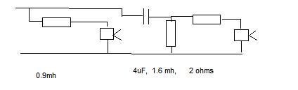

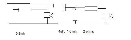

Usually most people want simpler crossovers! Here's the lowest part count xover I could come up with, not including BSC, which isn't needed if the speaker are up against the wall...
PeteMcK Thanks for your comment. I will redesign the xover by the driver impedence. I know the theory for the less better than more. However, when I plot the graph by the software, the response curve is not flat or level. It varies up and down. That is the reason I add lots of filter to make the response curve flat. Since I want the xover to be connected by the different wire at difference driver, say copper for woofer, silver for tweeter, that’s why it is a parallel design. I know it may create the phase difference problem. If it is happened, I can use jumper at cabinet side to connect the drivers together! Pete, I know the performance of the driver in free air condition may not be same as driver inside the cabinet, either vent or sealed. Could you advise how to make a good sound!? Anyway, Thanks for your comment.
