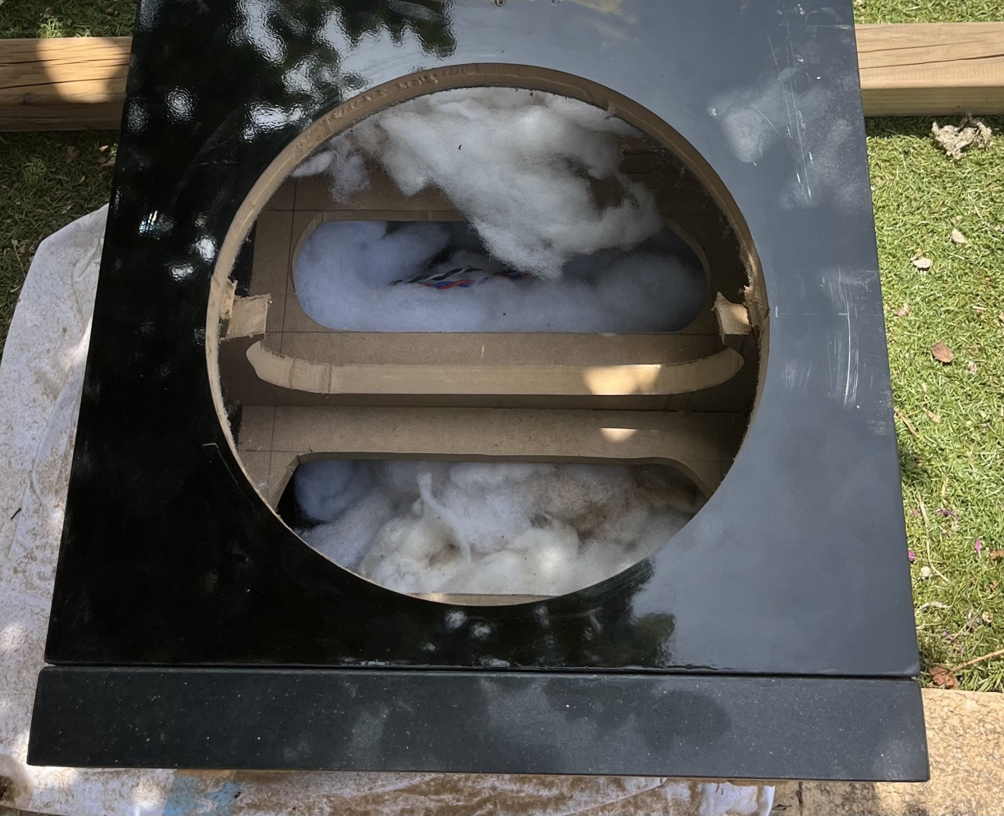

Thanks Toni. BTW can we see your scanspeak sub images for better detail ?
To shrink cabinet volume adding braces and corner blocks does both positives.
Also doubling wall thickness on open walls if its possible. Only if it can be done where it makes sense.
You can never make a box too strong.
You can only do so much with such a large box. Adding a second seas a way to go .
But that may cause some headaches for you to tune. Going to the drawing board and creating two new smaller sealed cabinets would be my choice. Experience tells me everything will improve x2. System integration, smoother, more balanced bass thats easier to tune. I get away with no EQ at all just a simple analog crossover and I'm fully happy with results currently with similar. I run this way for years with dsp. But I used to run ports. No more ports for me I might never go back
Theres some work involved yes but there's enough positives to make it worth doing.

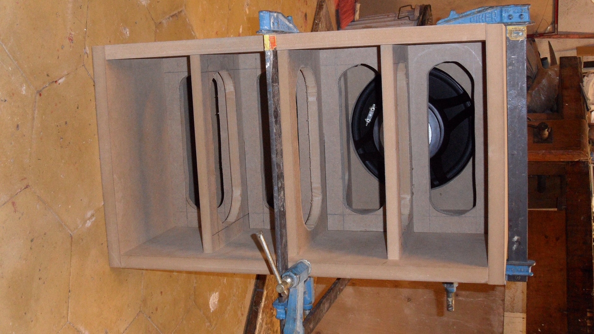

Due to the structure of the box, I think it is viable to separate it into two sealed spaces of about 40/45 liters. Des this way you could install an additional scanspeaker in each box and have "two subwoofers in one". I must study in detail if I can actually do it since access to the interior can only be done through the wofer hole.

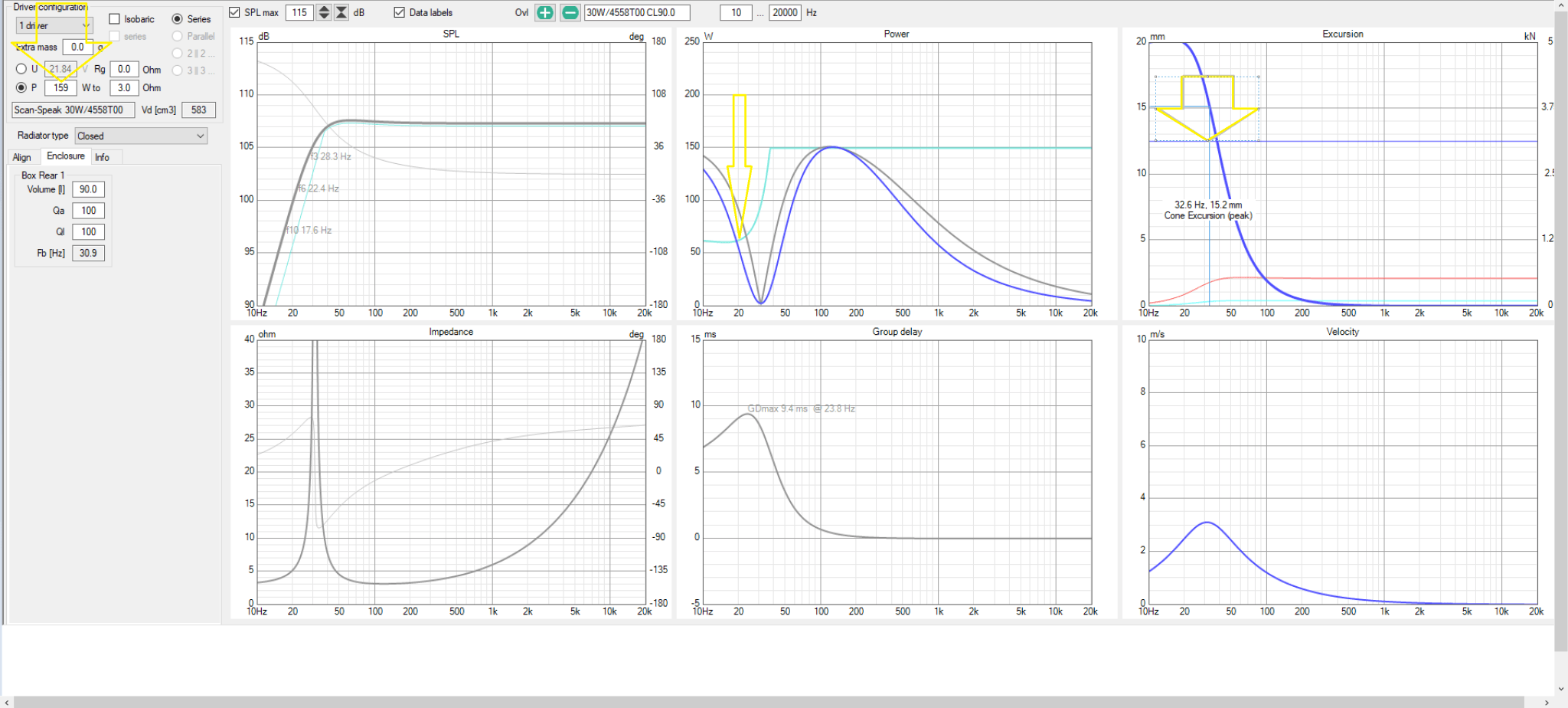

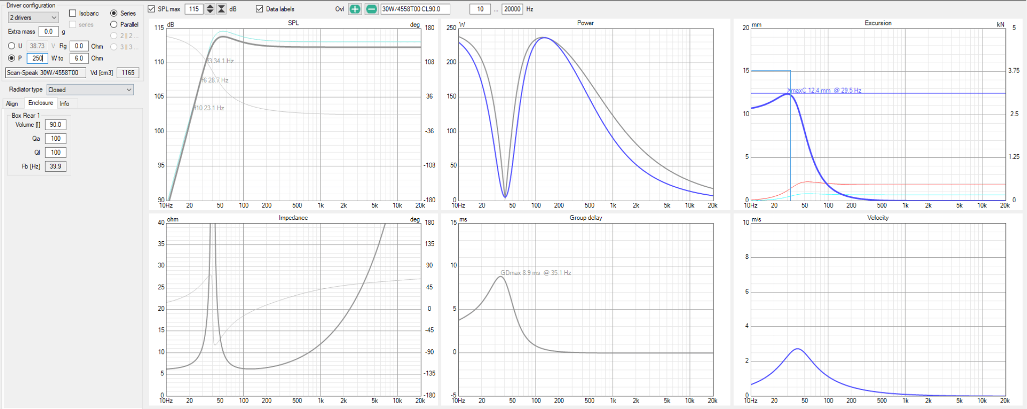

If I manage to separate the inside of the 90-liter box into 2 of 45, do you think that would be the ideal solution?One 30W/4558T00 in 90L box-

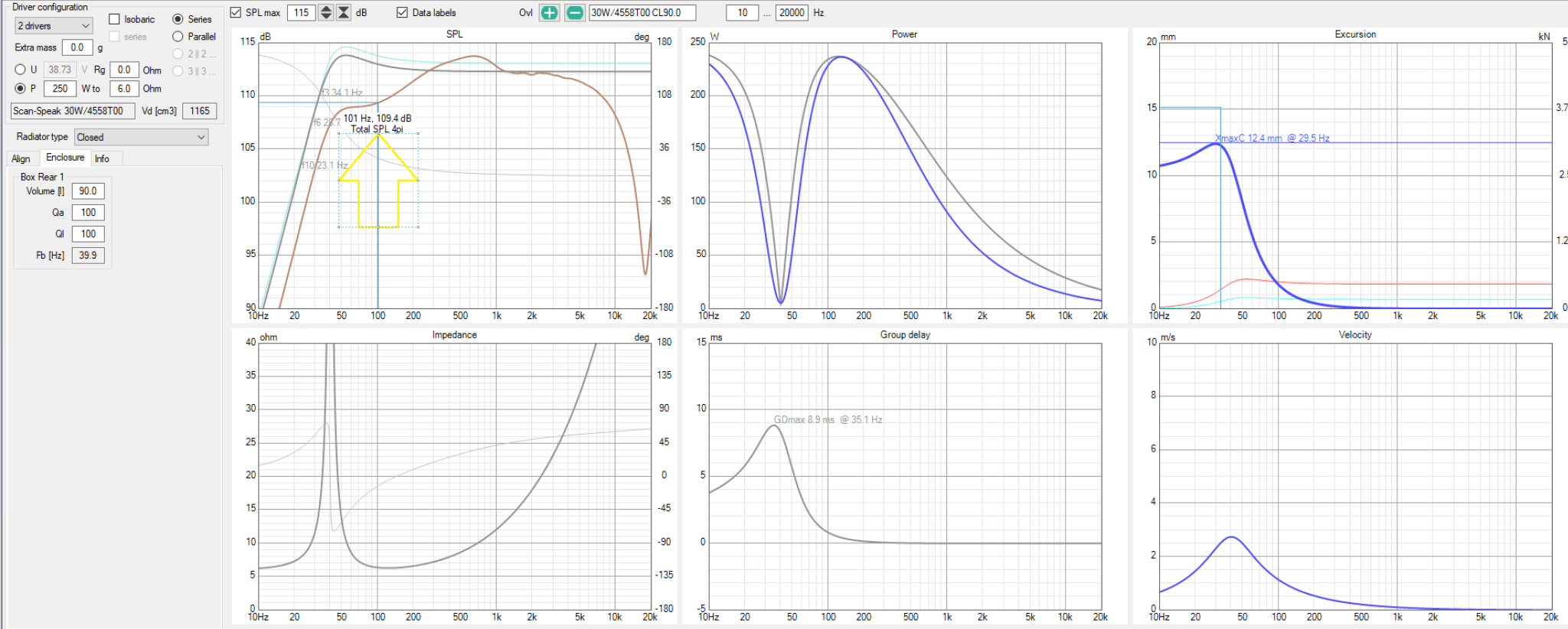

Whoops- thermal and excursion limits exceeded with just 150W (see cursors)
Now 2 of the woofers in series in on 90L box. Alternatively 1 woofer each in a 45L box each, wired in series with the plate amp (piggy back series connection)
Makes better use of Hypex amplifier power (250W in nominal 8 ohm load), and gives more SPL and doesn't exceed thermal or excursion limits.
You may say... "Oh that's not audiophile quality. But bass shows lump at 50Hz.
These are all 2pi simulatations.
Option 1) Model with baffle dimensions, to simulate baffle losses.
In a typical 35-40cm wide cabinet the brown line is closer to what is achieve in 4pi (free field/anechoic)

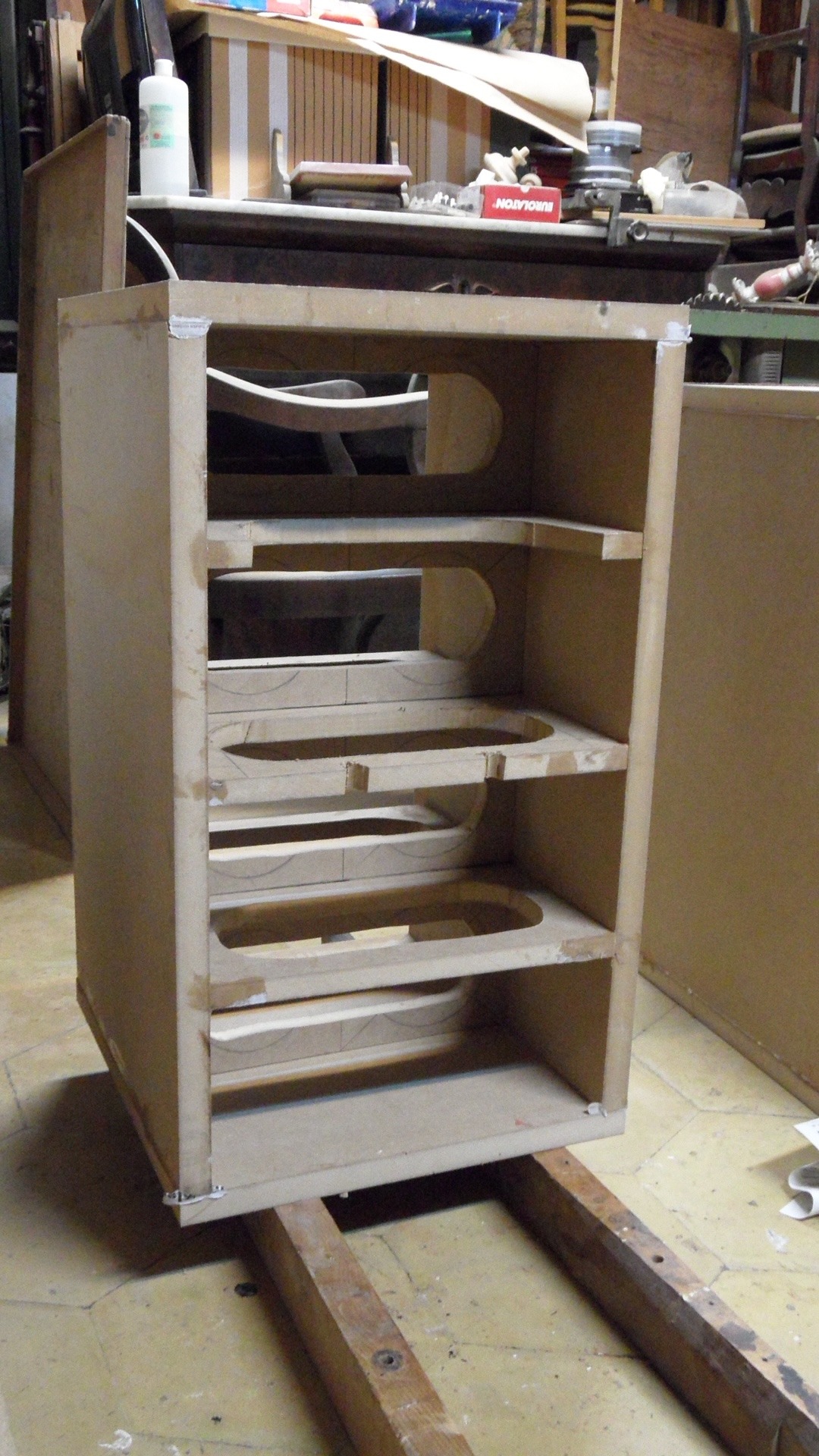

Nice looking cabinet. But no screws in there Toni? I didn't notice any construction screws. In that case I might approach the existing baffle with some type of saw and a router tool with cutting carbide. One with a bottom bearing would ride the inner walls and make a nice close accurate shave. Perhaps use a hand saw of some kind near bracing.

If you keep a single 90L box, and load it with 2 subs, there is No advantage to have two separate interior 45L spaces.
A potential advantage of having 4 x 45L separate boxes allows smaller subwoofers which may allow easier placement in the room, and reduction of room modes causing irregular frequency responses.
Removing the midwoofers need to play below 200Hz will reduce intermodulation distortion. And thus a cleaner midrange. However, adding high pass and low pass filters and effectively creating a 4 way system is best done with measurement equipment, either automated or manual, does if on your level of experience.

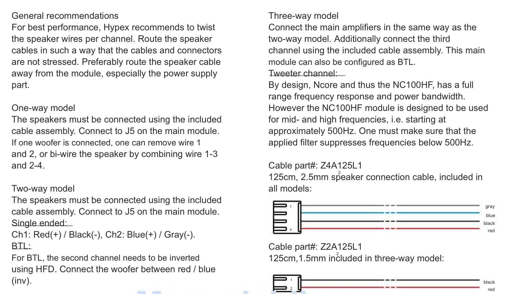

It's preferred to parallel 2+ woofers which share a common volume, and avoiding a 2ohm load could be an advantage. With a series connection, the FA501 should have headroom beyond Xmax here, so divided Vb makes sense if it's practical to implement....there is No advantage to have two separate interior 45L spaces...
Simulation already completed.
I recommended series connection with shared volume:

On the other hand, the 501 module allows you to connect a pair of wofers since it has two pairs of connection cables.

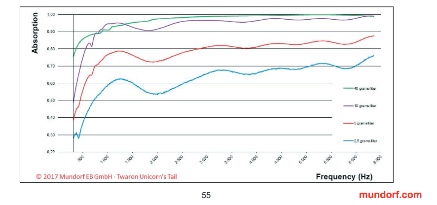

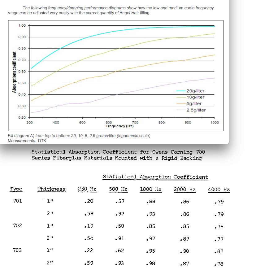

If you are into buying high cost damping material, you should be buying the "Unicorn Hair" rather than "Angel Hair":
"Owing to the endless fibres strings used in TWARON® Unicorn Hair, the effective functional frequency-range is lower in comparison with the TWARON® Angel Hair".
My experience with chasing unicorns has found it to be expensive...
Whether TWARON® fibers absorb acoustic motion energy in a "fundamentally different manner than other known materials" is debatable, but it appears the absorption coefficient of 20 grams per liter of "Angel Hair" filling is about that of 2" (50mm) of Owens corning 700 series fiberglass.
"Angel Hair" and "Unicorn Hair" does more absorption per weight than other damping materials, but considering it's cost per weight is around $200 per kilogram it's still no bargain.

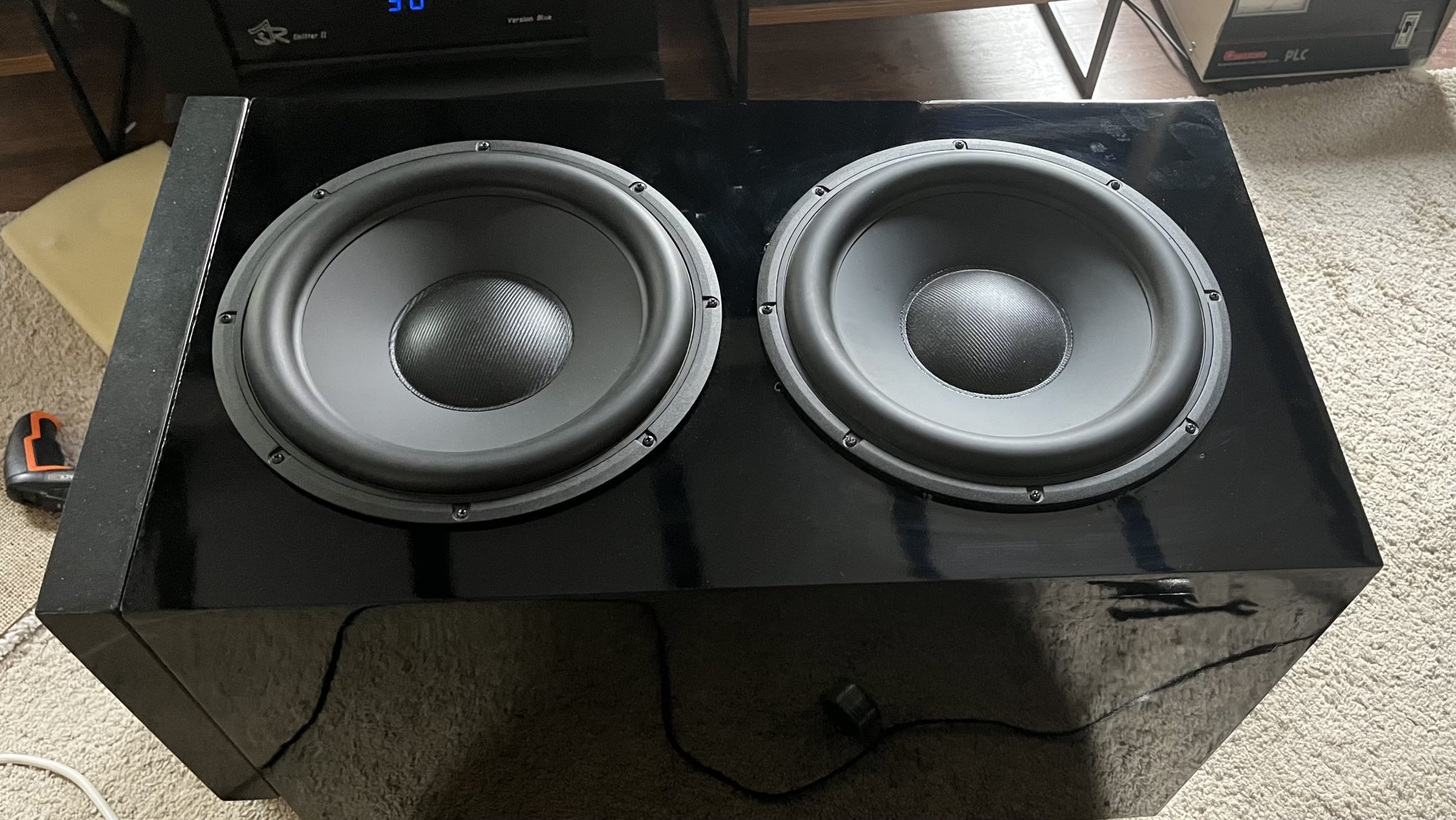

Hello. I received the two extra subs and this weekend I was able to drill the two holes in the box and install them. So far the results are promising. I have had to lower the power output of the Hypex by 10/15%. This makes the wofers work very relieved. The membranes hardly move and the sensation is of a clearer sound and without shocks. Now it's time to experiment. See what happens if I eliminate the cut at 25 hz to protect the sub when it only had one... thank you very much to all of you who have contributed your opinion and help.
