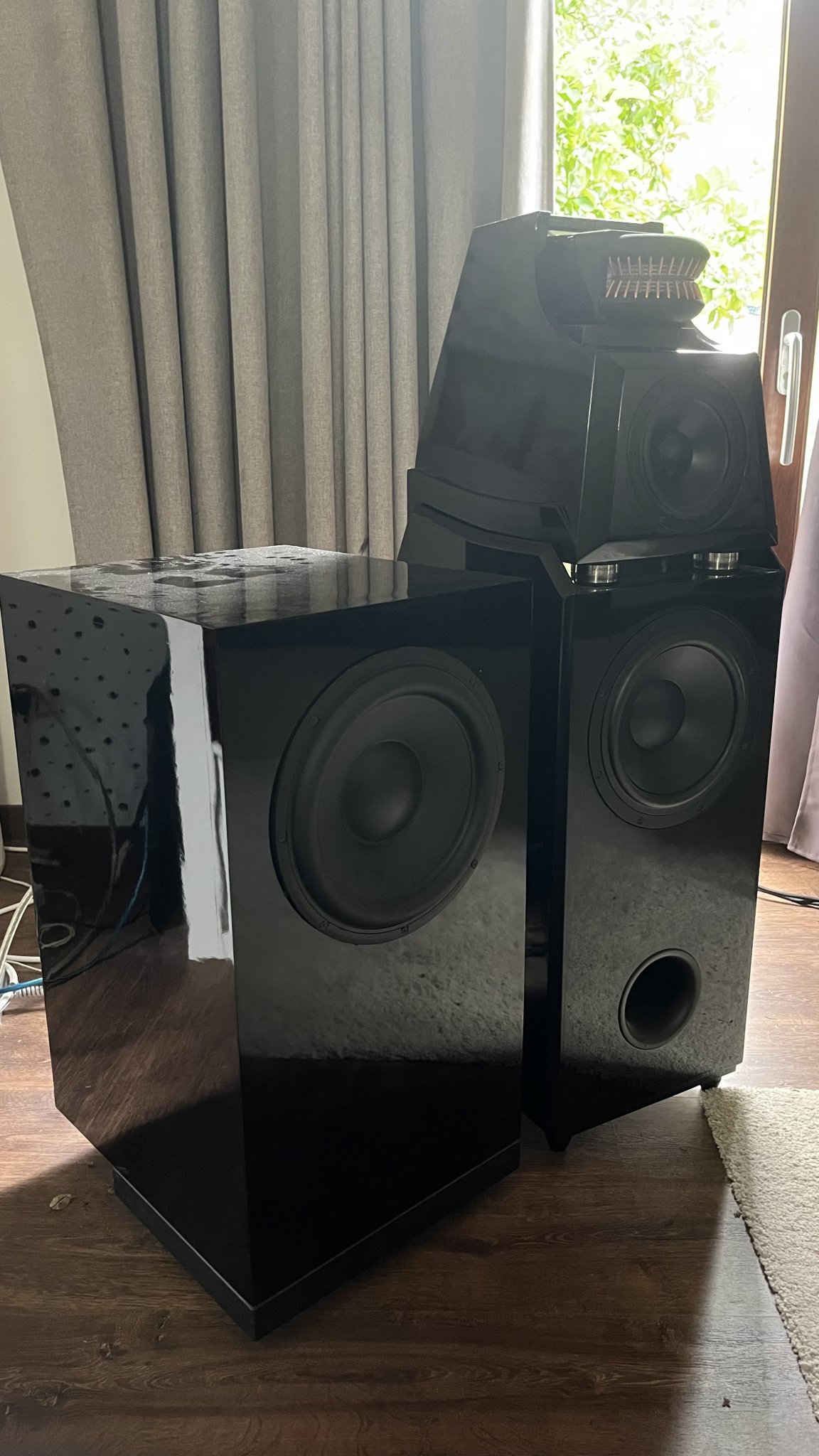

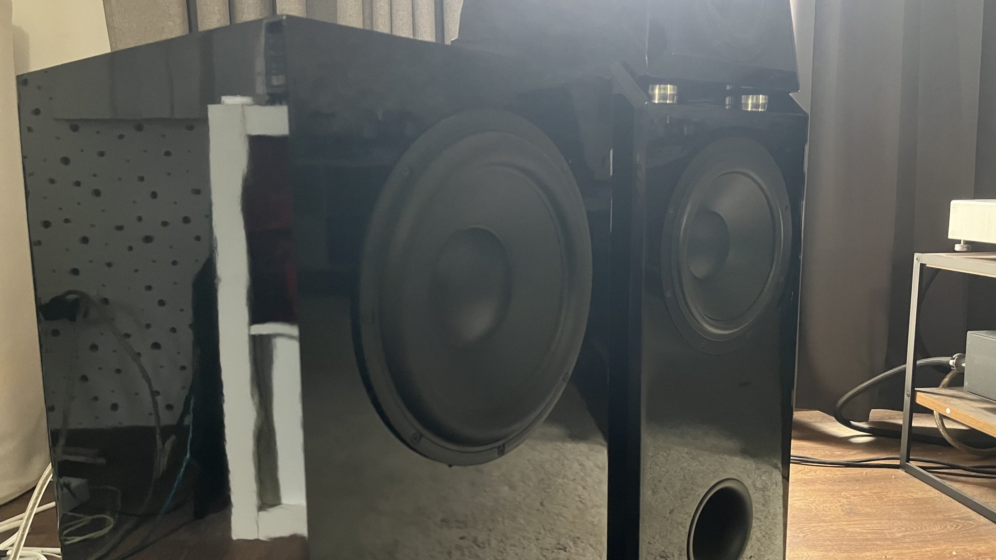

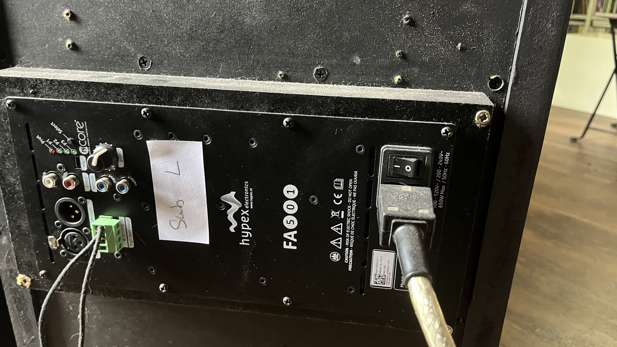

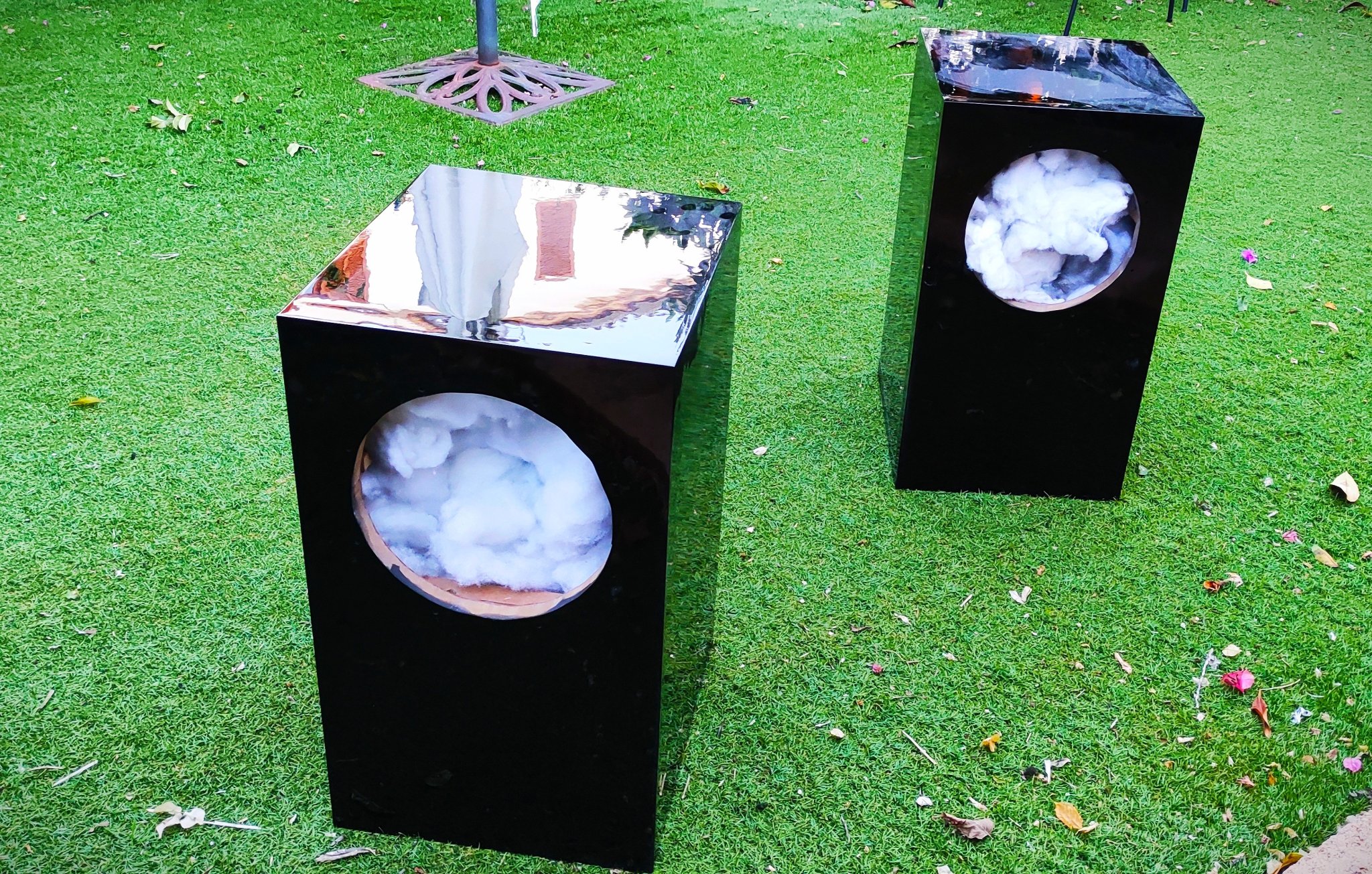

Hello, I ask for help here. I am currently happy with the sound of my pair sub diy subs. I used a 90 liter sealed box with a Hypex FA 501 500w 4 ohm module and a Scan-Speak Discovery 30W/4558T00 Subwoofer. However to get a long response below 50hz at high volume, scanspeak suffers and is close to its physical limit. I would like information on other 12” speakers that will fit into a 90 liters sealed box, preferably 4ohm capable of going down to 30hz comfortably. I listen to all the options although I prefer not to exceed 500 eur per unit. The crossover frequency used can vary between 80 and 40 hz to reinforce a 10” wofer from my loudspeakers. If there is already a topic like this, I apologize and accept the link.

Actually I am already using two subs in the estuary (see photos). Thanks for the help.Totl Dayton are a really good value. I bought one, that will lead to multiple. If you can eat up some of the cabinet volume https://www.parts-express.com/Dayto...-Subwoofer-22-ohm-295-291?quantity=1#speclink As you can see its built heavier and beefier than the scanspeak. And handles more power.

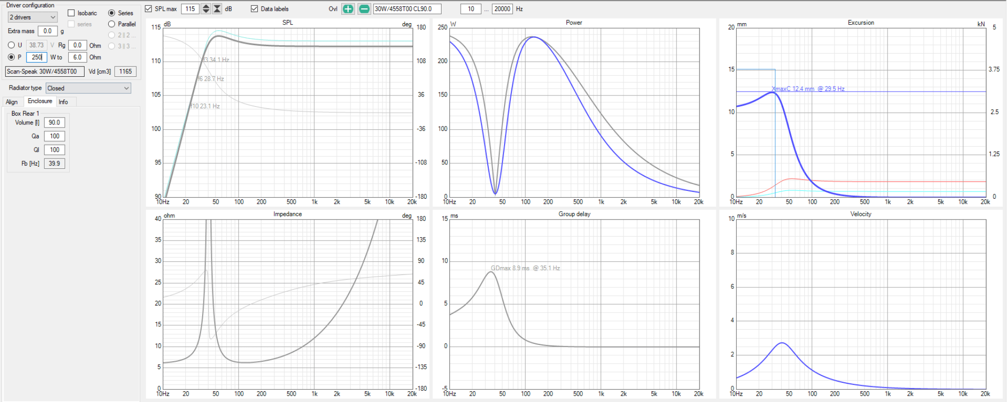

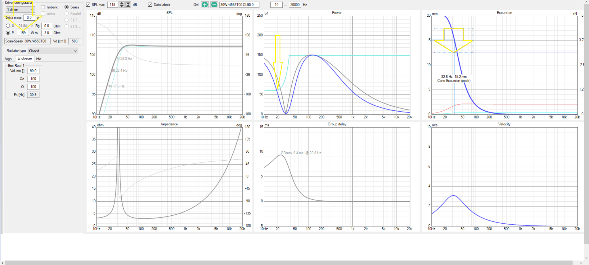

this is a misalignment as in 90L that drier will easily exceed x-max.
The woofer cabinet and amplifier needs to be matched so that the speaker can use all of its available excursion but not more, using the least amount of power necessary.
You heard of people putting subs into incredibly small boxes and needing incredibly large amount of power? You got it the other way round-too big a box and easily exceeding x-max .
The 30W4558 does much better in 40-50L.
It may sound counter intuitive, but it’s much better to have 4 of those subwoofers, each in 45L.

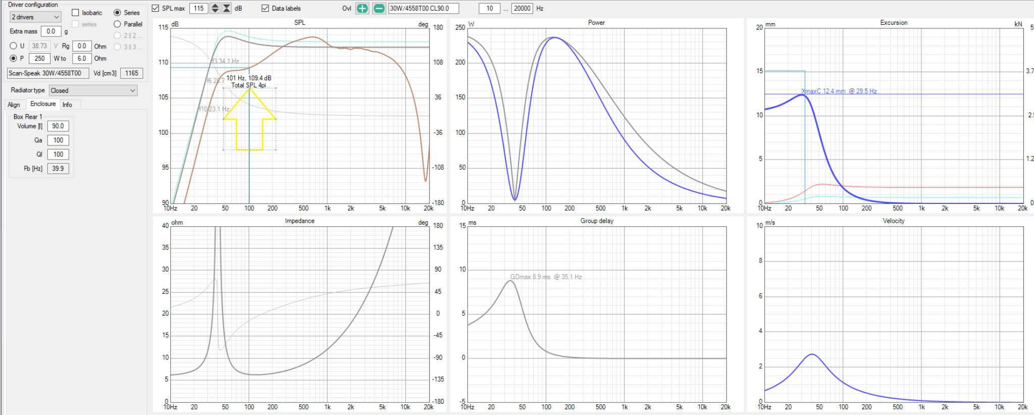

One 30W/4558T00 in 90L box-
Whoops- thermal and excursion limits exceeded with just 150W (see cursors)
Now 2 of the woofers in series in on 90L box. Alternatively 1 woofer each in a 45L box each, wired in series with the plate amp (piggy back series connection)
Makes better use of Hypex amplifier power (250W in nominal 8 ohm load), and gives more SPL and doesn't exceed thermal or excursion limits.
You may say... "Oh that's not audiophile quality. But bass shows lump at 50Hz.
These are all 2pi simulatations.
Option 1) Model with baffle dimensions, to simulate baffle losses.
In a typical 35-40cm wide cabinet the brown line is closer to what is achieve in 4pi (free field/anechoic)

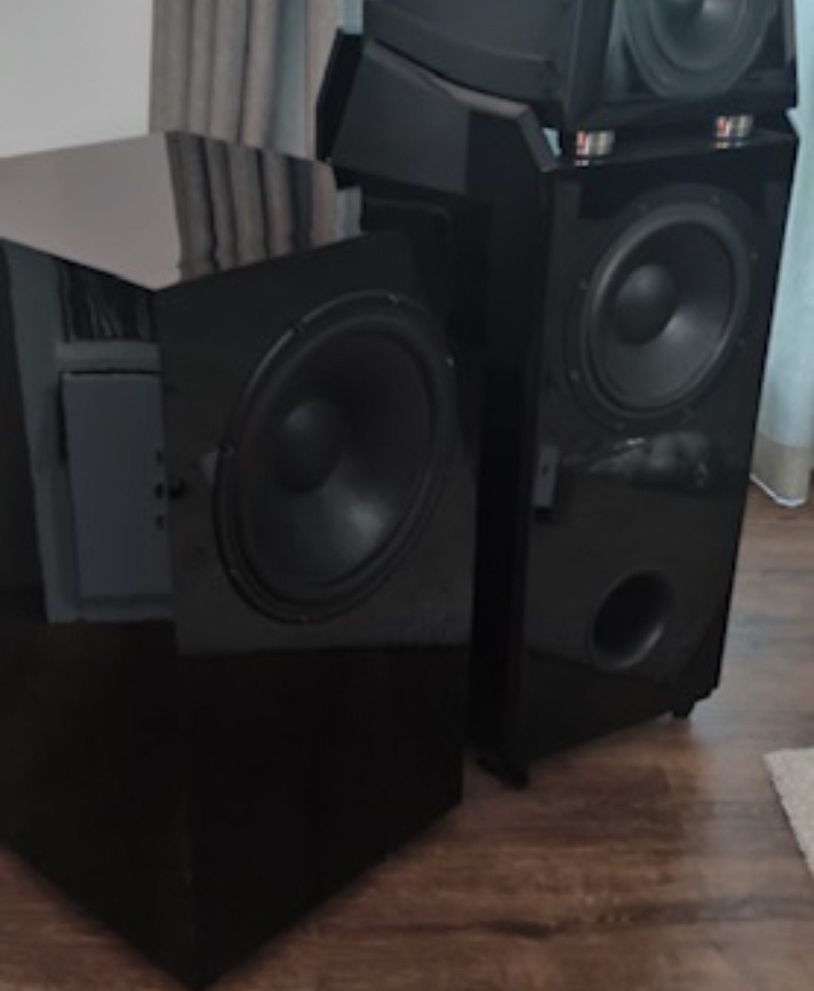

Hello, thanks, I have a version from de ATS Troels Gravesen loudspeakersWhat subs did you use here ^? Very nice speaker set. More detail is nice. Those remind me of Wilson's, you also made the full rage?
