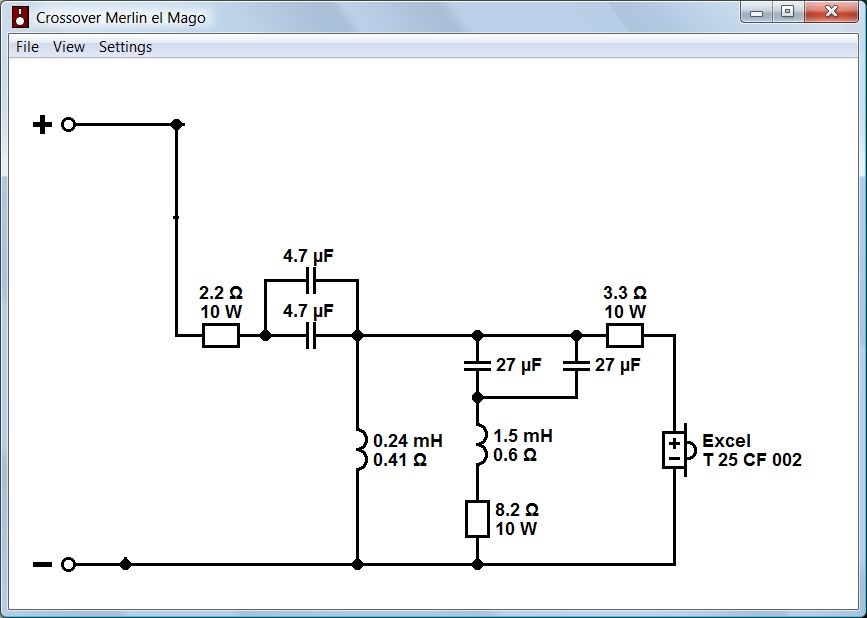

I need to know what the xo looks like on your mid and tweeter.

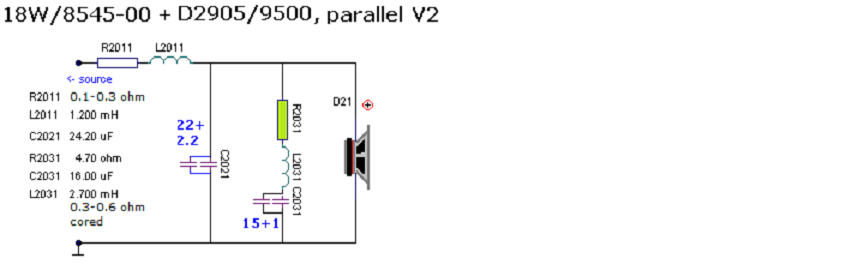

mid xover
tweeter xover
I found in other thread the xover for the woofer SB Acoustic SB 23NRSX45-8

Well no, I think the right place to start is with a proper simulation. I'm working on it. Just be patient.
And no, I also wouldn't start with a 4th order. I'd start with a 2nd order, see how that works out and then add more components only if necessary.
Also, you are going to have to add a high pass circuit to your mid too.
