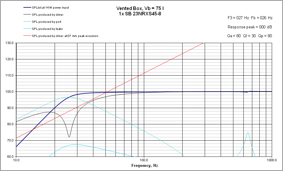

For 1 SB 23NRSX45-8:
Vb = 75L
Fb = 26Hz
F3 = 27Hz
F10 = 20Hz
Port inside diameter = 7.65cm (3")
Port Length = 26.86cm
Stuffing = walls covered
xmax is not exceeded until 100dB 1W/1M at about 23Hz.
Port size and Vb can be slightly adjusted if desired. Actually, there any number of different ways to tune this - this is just one.
Port Volume (L) = (pi*r^2*l)/1000, where r = 1/2 the outside port diameter (cm), and l = the length inside the cabinet (cm) (divide by 1000 because 1L = 1000cm^3)
Be sure that Vb of 75L excludes the volumes of the port, driver, bracing, xo's, etc.
Here's what the response looks like:
Vb = 75L
Fb = 26Hz
F3 = 27Hz
F10 = 20Hz
I can't get BR tube of 3" 7.65cm, can I use two BR tubes in other standard size?
I can get 85mm adjustable lenght 125-275mm MBR-80M - Bass reflex tube 54cm² - Europe Audio
If Vb is actually 75L, that port will do fine. You will need the full length, 274mm.

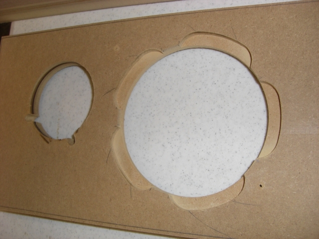

If I wanted to go the extra mile (or km), I would probably consider doubling up the thickness of your front baffle and go with 19mm thick bracing of good quality plywood instead of MDF, but you may need to change cabinet dimensions and/or the port if you do so. Otherwise, your plans look correct and sufficient, but you should do an accurate calculation of the net internal volume to be sure of the port length.
I would also suggest when you route out the chamfer for the driver on the rear of the front baffle that you do not cut out the material where the screws/bolts go. So you get something like the picture below, although the 45 degree chamfer that I think you did for your mid is preferable.
