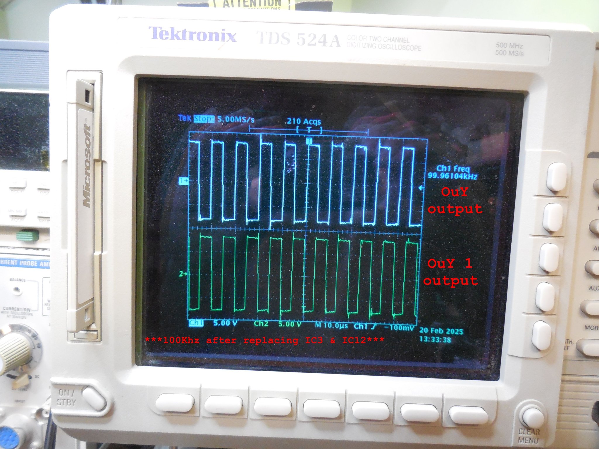

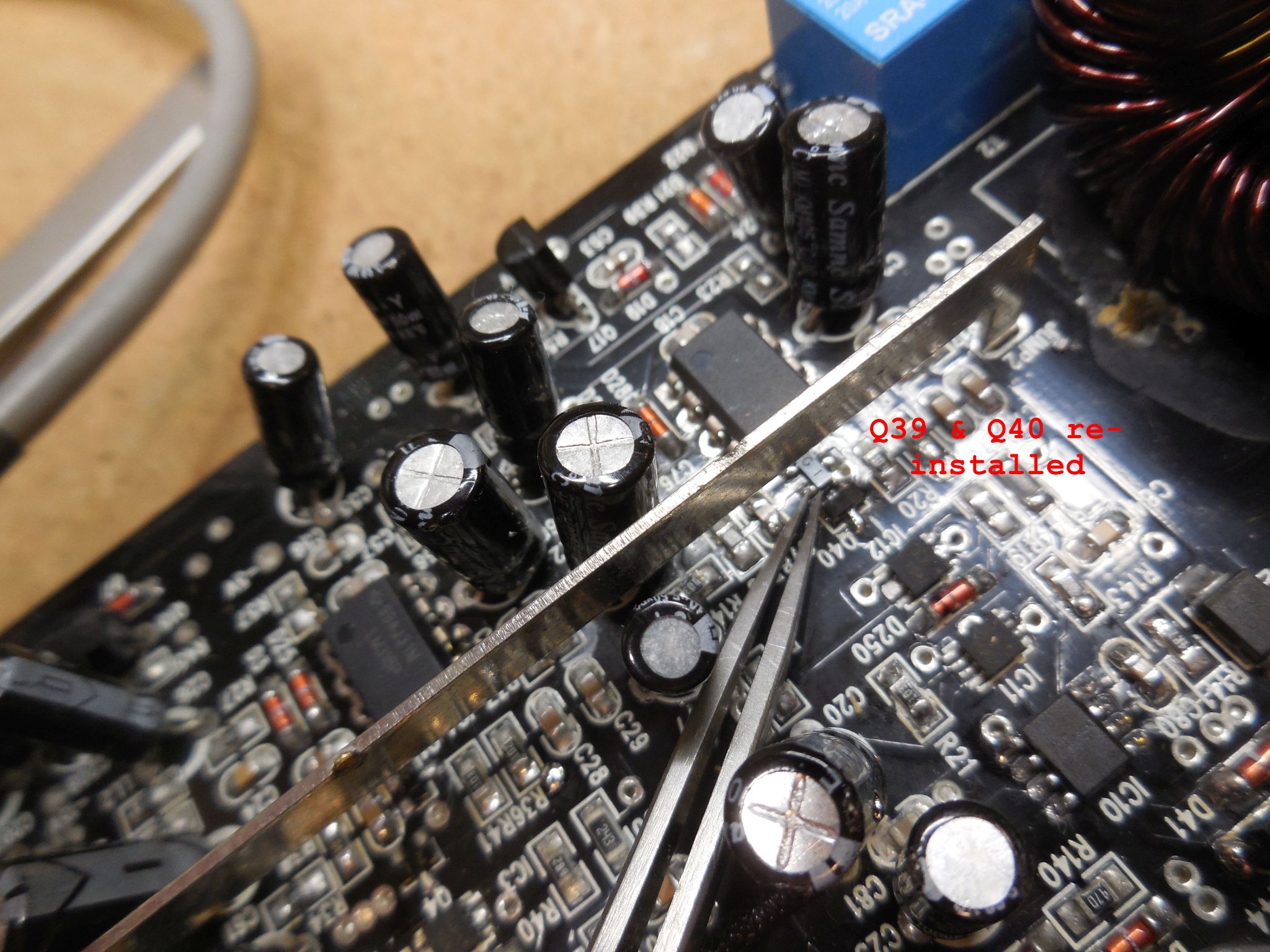

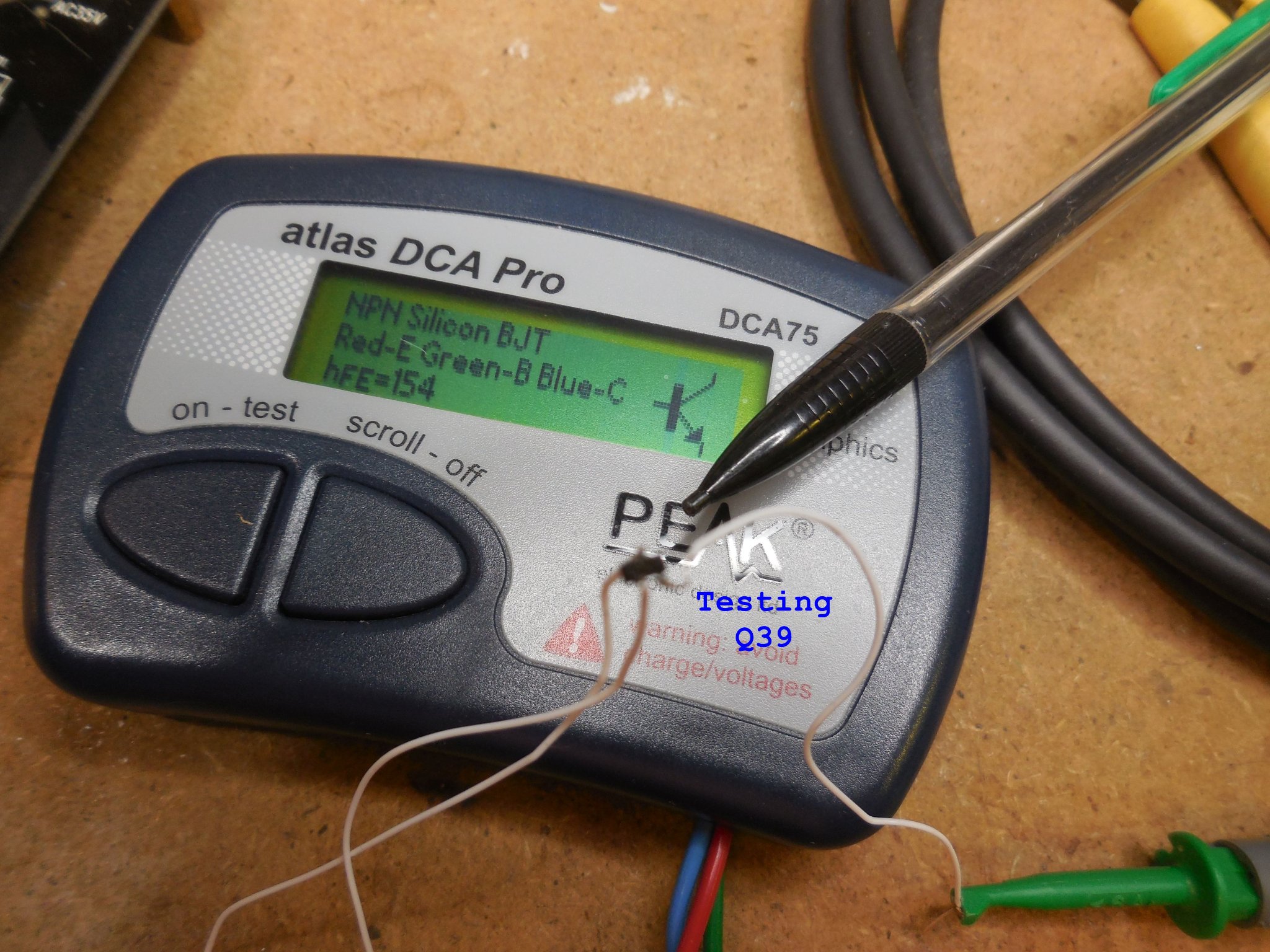

I spent the morning meticulously verifying and testing everything between IC13 and IC12 and painfully removing the transistors (SOT-23) to test out of circuit. Before retesting I installed new "F04's" (IC12 & IC3).

Hi, I'm not sure on this. My scope agrees with my Fluke meter which is accurate. The rails are +/- 62v. I do remember measuring 80v somewhere. One problem is my scope is grounded to the chassis ground as the dc reference is not tied to chassis. I need to get differential probes but the Tektronix ones are very pricey. I replaced the F04 inverter chips and that's what got it running. The F04 may not be getting a valid TTL transition or it failed. When I measured 80v I may have used chassis for reference. It's risky to probe that oscillator as the thing blows up if the oscillator stops. I did buy more of the chips.
