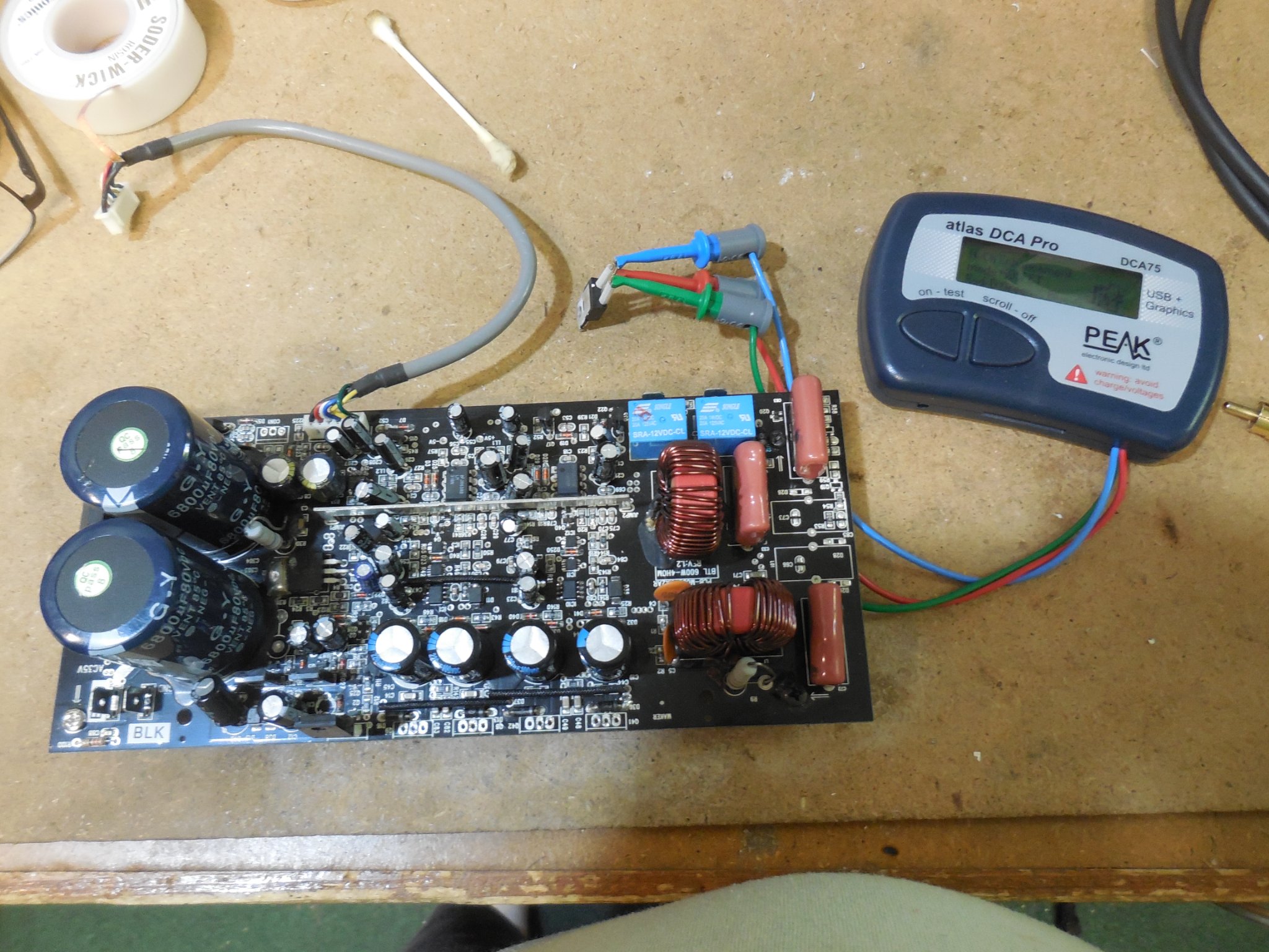

I am repairing a "James" subwoofer model 6 amplifier "see schematc". I got it running, but it has 13% distortion and the output filters are hot, 100 degree C.
It is a bridged design and the (pos side) pwm is 1.8 khz IC13 pin 6 while the (neg side) pwm IC 4 pin 6 is 360hz. Shouldn't these signals be the same?
Thanks, Gary

I pulled Q8, Q9, Q13, Q14, and Q41 - Q44 and tested them out of circuit with my handy little tester (recommended). Anything else I should look at while it's apart? I checked most all the resistors, and they verify fine.

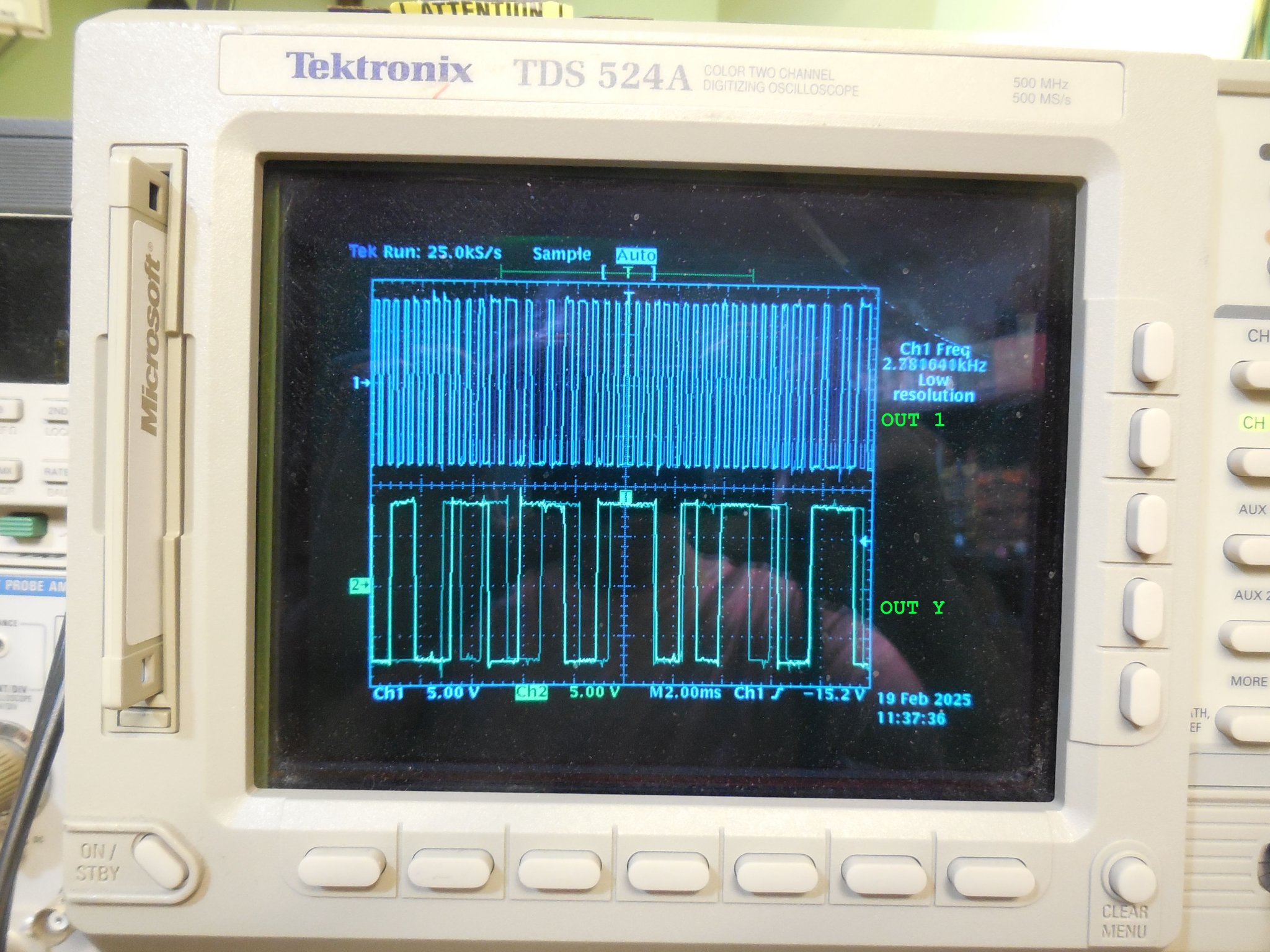

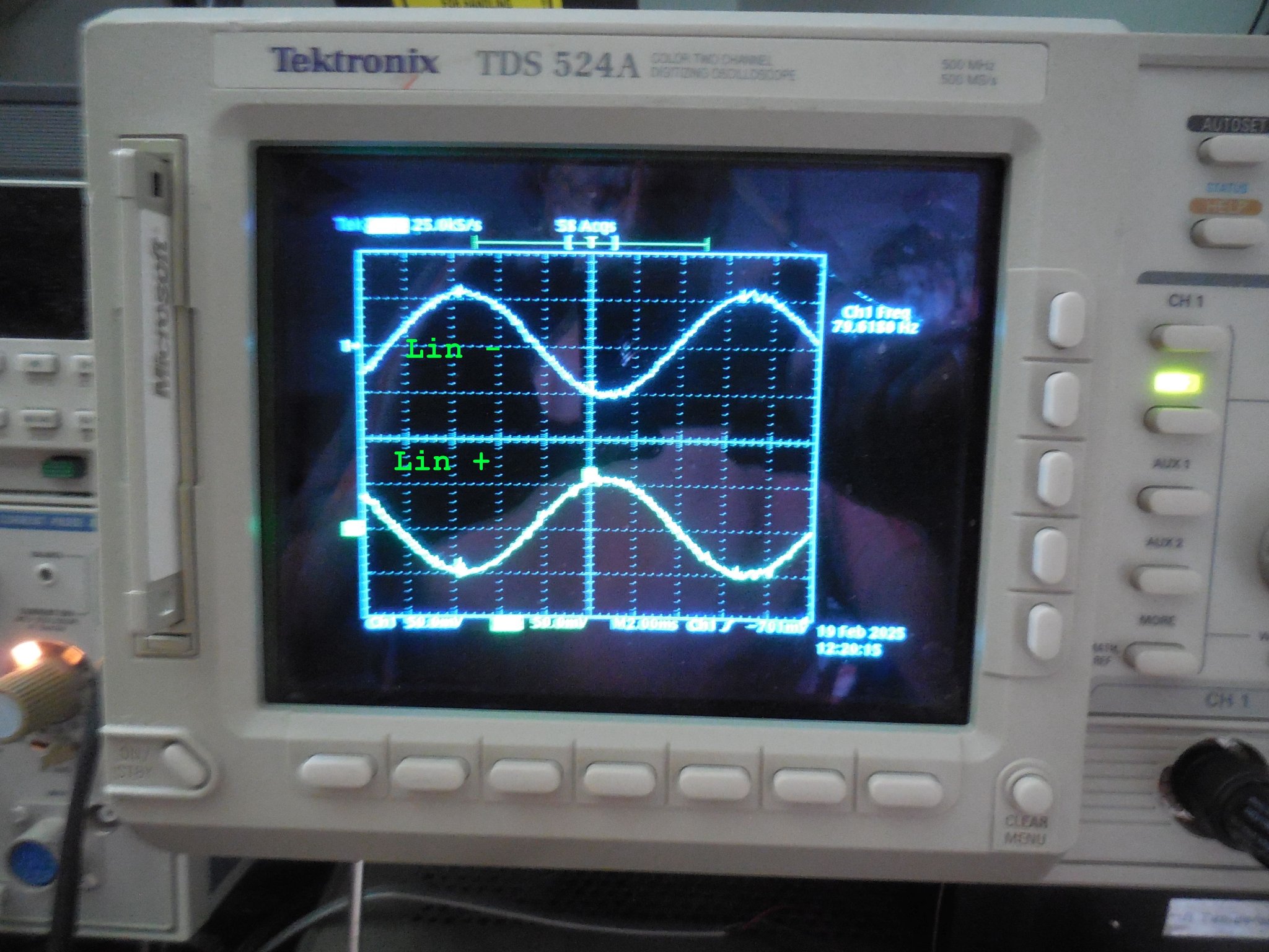

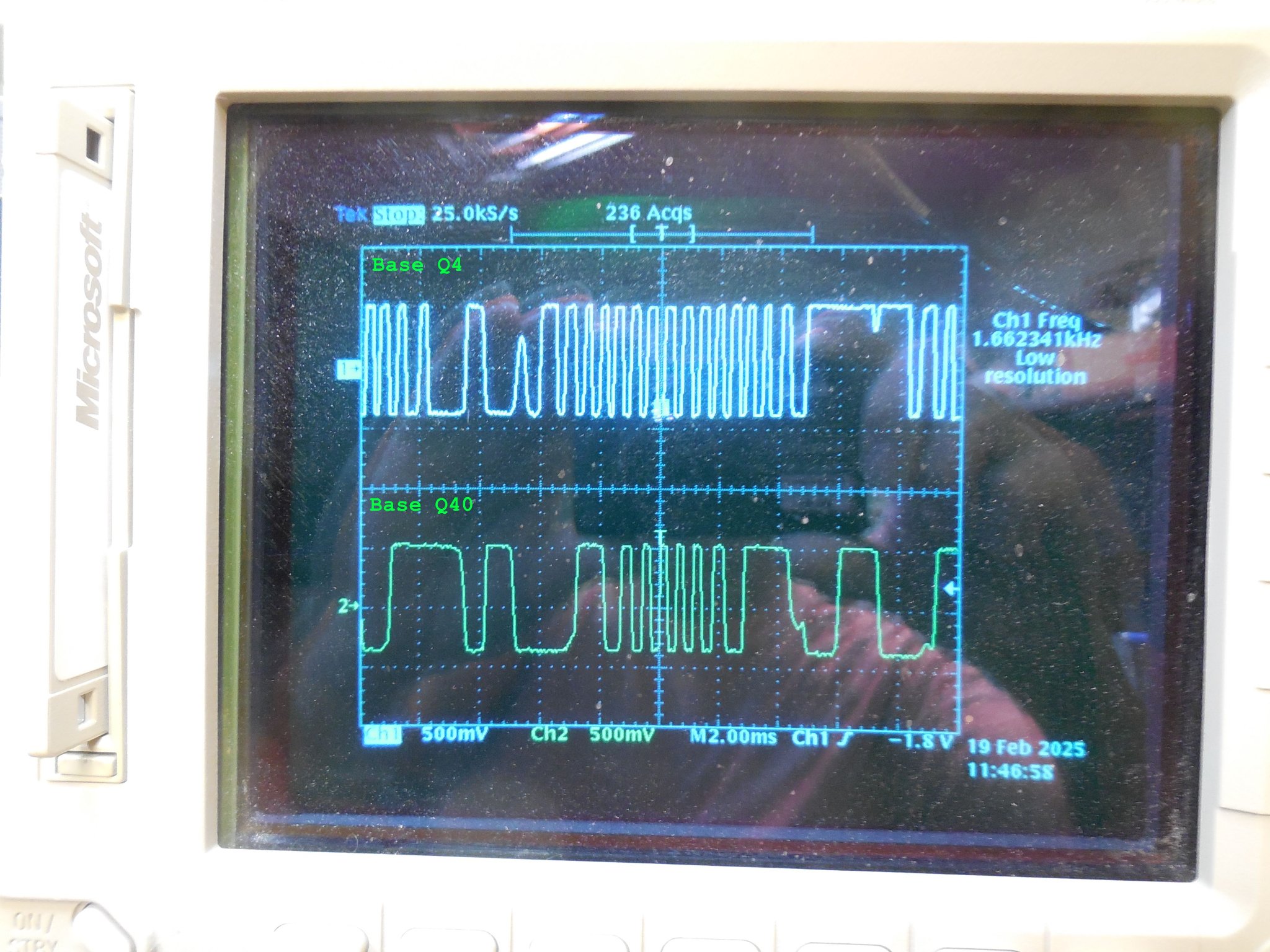

I reassembled the board and no change after replacing IC4. I took some scope shots of the outputs of the opamp versus the output of the power FETs. Please see attached.
Comments?

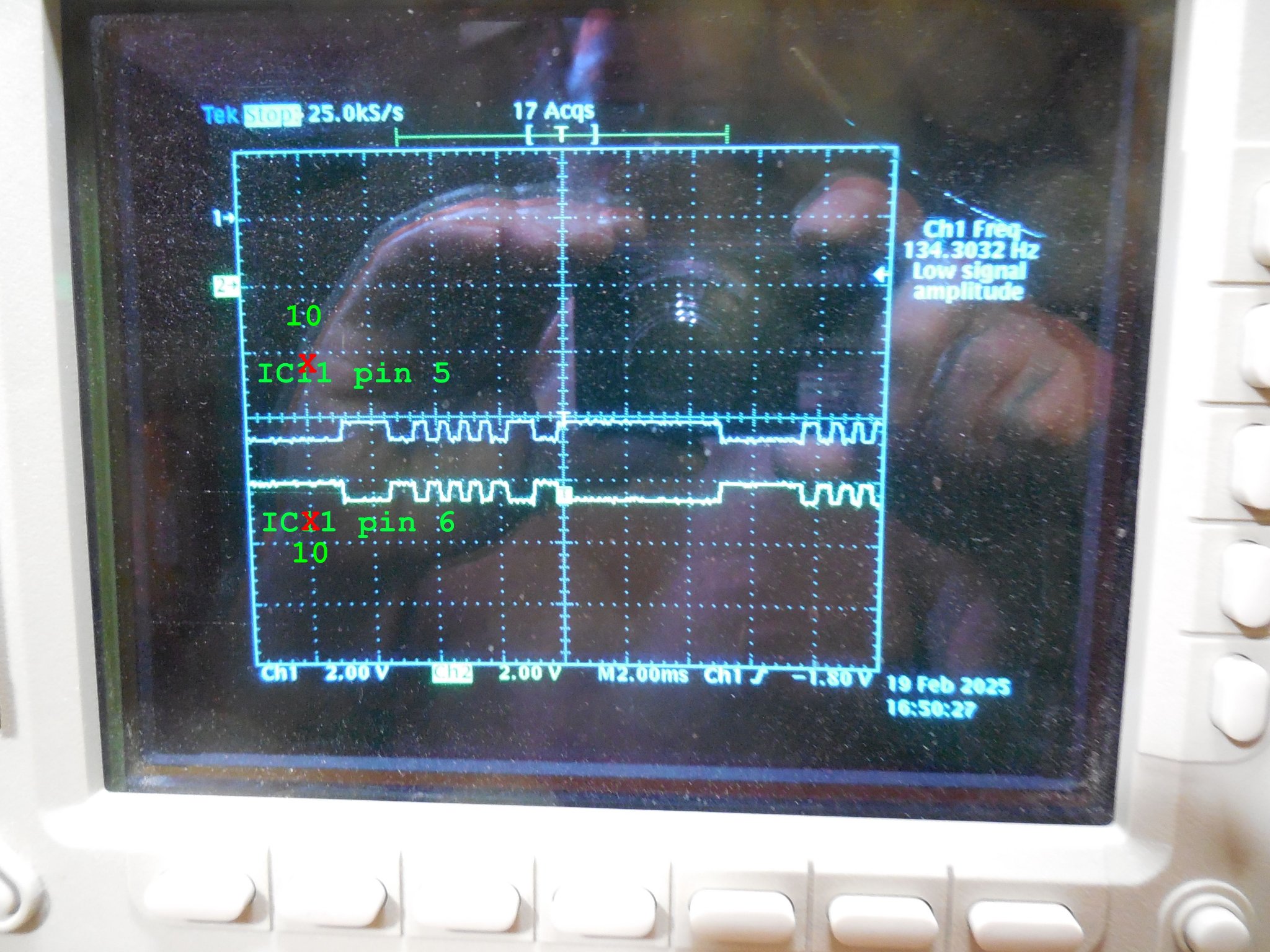

Have you checked to see if you have +5v and -5v on IC4 and if SD5V is 5v? Check the voltage on pin 8 of IC11 and IC12 and pin 1 of IC10. Also, you show a 16V power supply on your outputs. Is this right? I don't understand your plots with a light blue and a dark blue trace. Why are there two traces on one output? The outputs look like they are similar at this point. The frequency is about 2.5 khz for both channels and that is too low. I suspect a power supply problem at this point because both channels look similar. Yes. You could disconnect the output filters without harming the outputs but I doubt that it is necessary. Just power it up for short periods of time to take your data.. If it hasn't blown up during your testing then it is not too stressed.

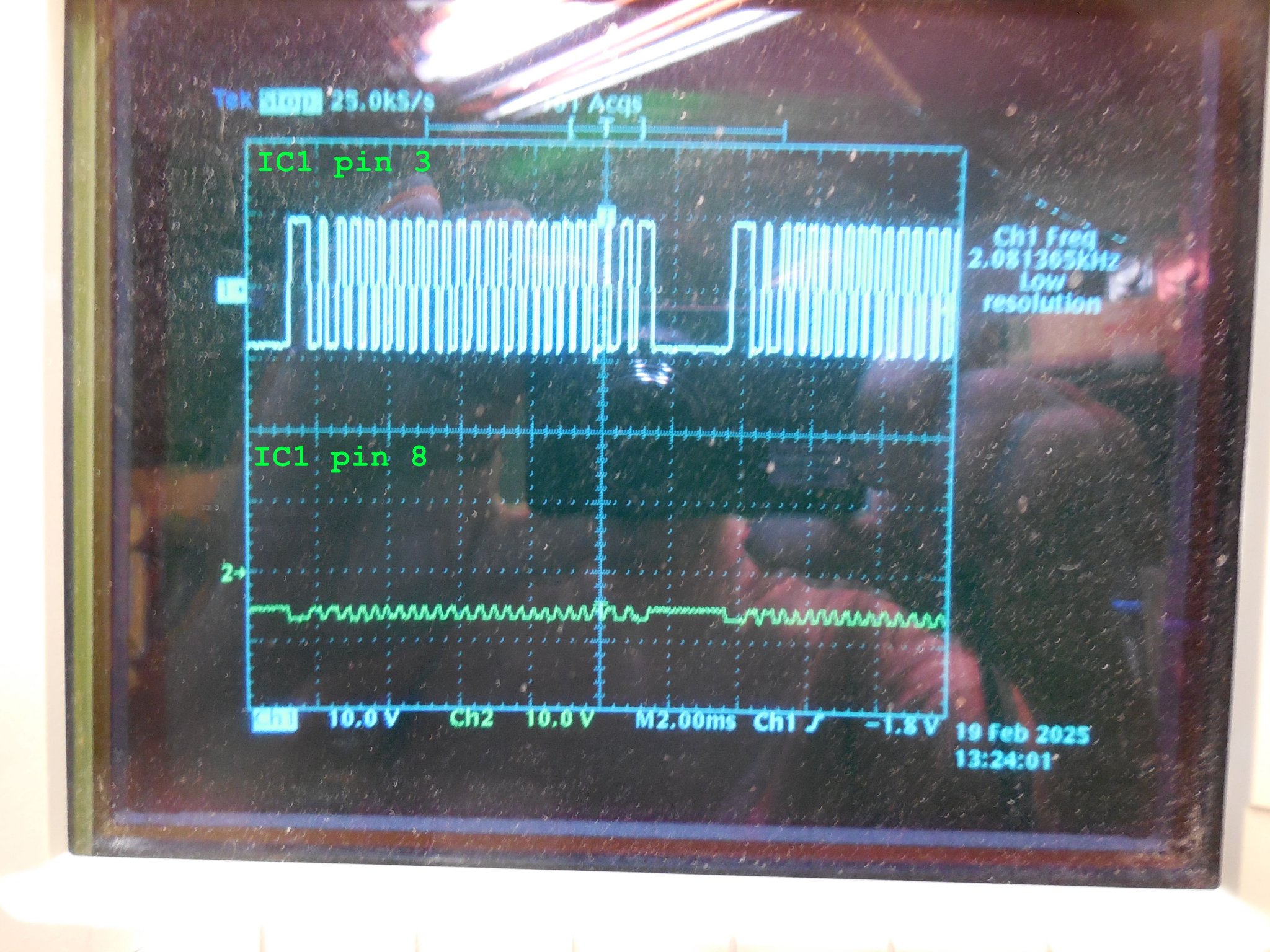

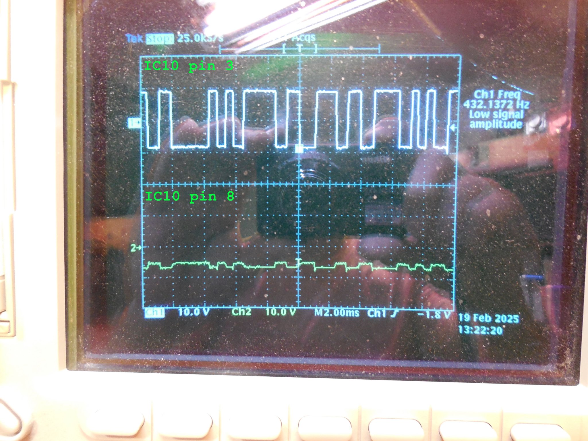

Just re-checked +/-5v okay. SD5V is 63v BINGO. I will find out why. The two traces "sine waves" are the line input to each side of the bridge (positive) amp and (negative amp) signifying the preamp is supplying the proper inverted inputs. the attached traces are the IR2011s output driver and are messed up probably because of the bad SD5v.

I'm not sure what to look at next. IC1 and IC10 top and bottom traces Pin 3 vs Pin 8 should be the same gain and they are not. They are inverted though. At this point, I agree it could be a power supply problem, The power supply design is very difficult for me to understand and troubleshoot.
Measure the voltage between pin 8 and pin 4 on IC12. It should be 5V or no more than 7V. Did you verify the rail to rail output voltage of 16v on your output? It think it should be about 120V. I am pretty sure that there is a problem with the power for IC11 and IC12.
There is a P_C signal that comes from R_CUT that may be doing something. It seems that this signal affects the output logic of both channels through D7 and D19 until the 15V+ supply is up. That may be the common point that is shutting down the lower power FETs of both channels. Maybe the PC17K opto-coupler is leaky or shorted.
