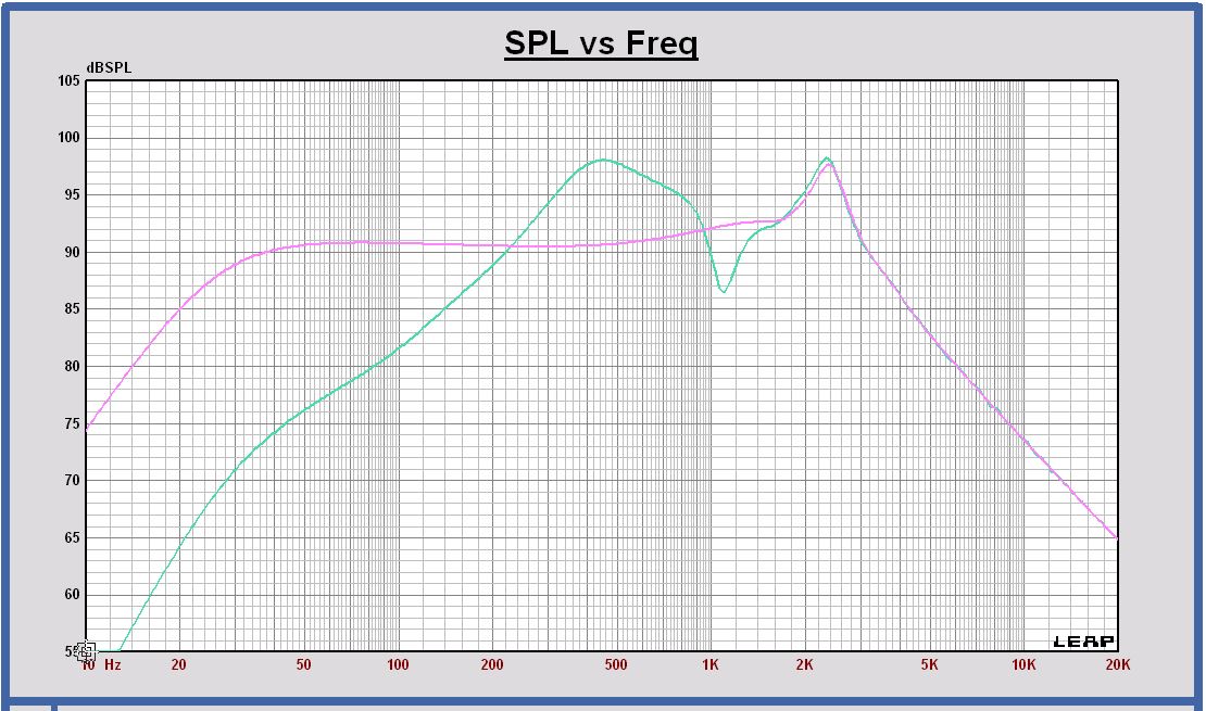

Driver is the AE TDH12-4 ohm in a 5 ft3 box.
You don't need to horn load this AMT. It's around 93db, perfect match for these drivers.
Used a totally stock AudioPipe 1.2khz crossover.
