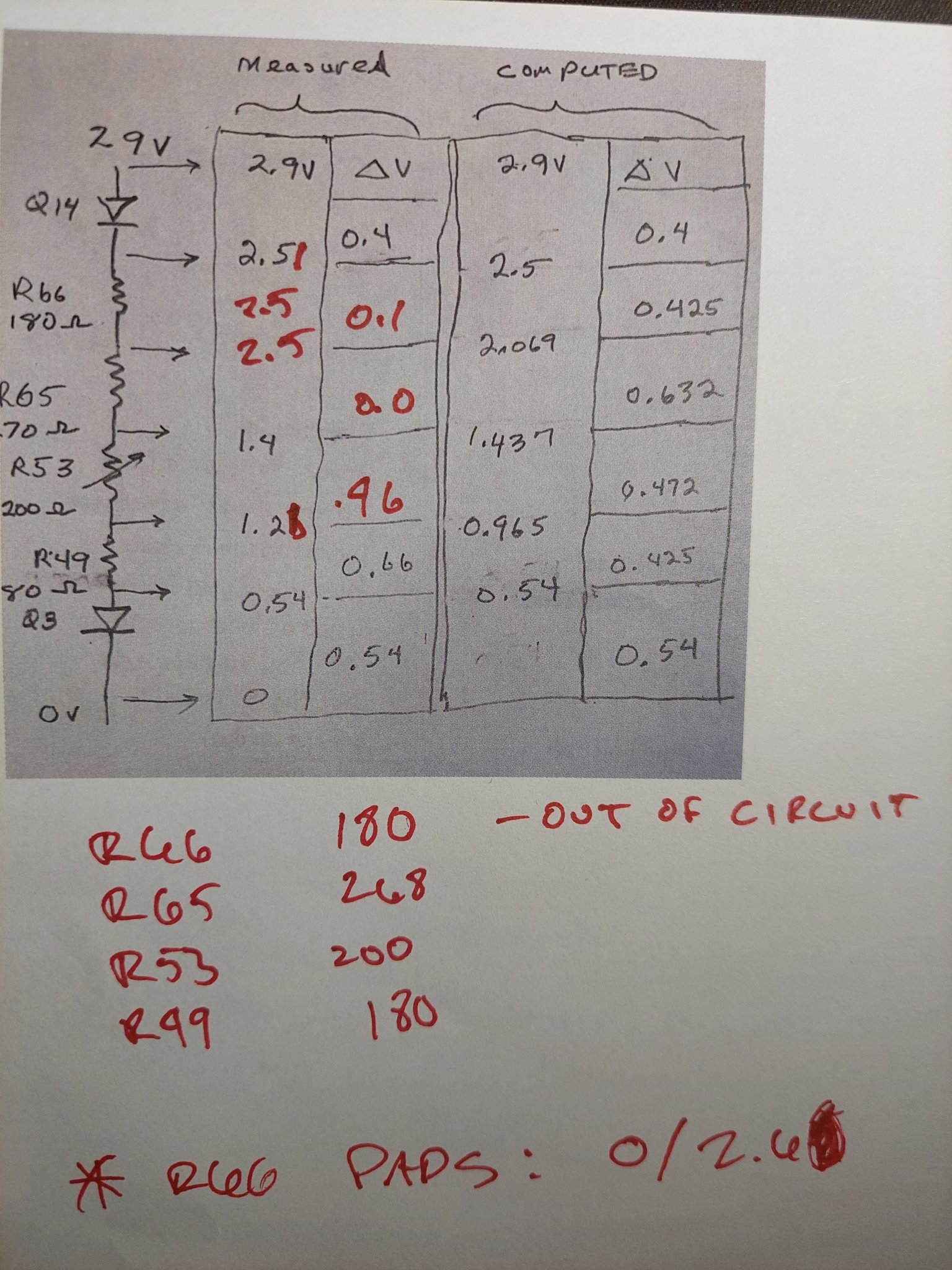

Hi Peter,
I've attached a crude PDF showing your measurements and and also voltages I believe should appear at each node in the voltage divider chain.
A few entries are missing, as I wasn't sure how to interpret the R66 and R65 data. I estimate there should be about 0.4V across R66 and about 0.6V across R65, so I can't reconcile that with your data. I agree that voltage across R66 is especially peculiar.
One experiment might be to remove R66 and measure its resistance out-of-cicruit. Further, with R66 absent, you should be able to measure the remaining resistor values in situ, without stray paths affecting readings. With R66 absent, voltage should measure 0V at low side of the R66 site and nearly 2.9V on the high side of the R66 site.
Good luck. TTYL
Good luck. TTYL
Here are the missing measurements.
Strange situation with R66. No short between the two pads and the resistor measures fine, yet no voltage drop.
The last R66 pads measurements were 2.66V, but I just just turned it in so maybe it hasn't settled yet.
I’m not sure what to make of your last post. The starred note at bottom suggests that you cleared a short, as the pad voltages imply 2.6V across R66?
I was going to speculate that there was a short between the top pad of R66 and bottom of R65; that would yield 0V across R66 and R65, yet present resistance across the R66 terminals. If the short has been cleared, all resistor pads should present 0V with the exception of top pad of R66. Further, with R66 absent, you should be able to measure the resistors in circuit to confirm value and connections.
When replacing R66, I recommend cleaning pads with solder wick and using solder sparingly to avoid shorts.
So the situation has improved re the post 95? I.e you somehow cleared a faulty path?
If so, and all resistor measurements look ok, restore R66 and check for appropriate voltage drops along the divider string. Also while transistors are still absent, check R52 resistance since it will still be isolated and easy to test.
Then install Q10 and confirm resistor network doesn’t change; then Q32 and no change. Finally, install Q8 and remove the four-diode clamp. With luck, the bias spreader should now behave and should respond to R53 adjustment. Return pot to minimum spreader voltage before reconnecting output stage.
