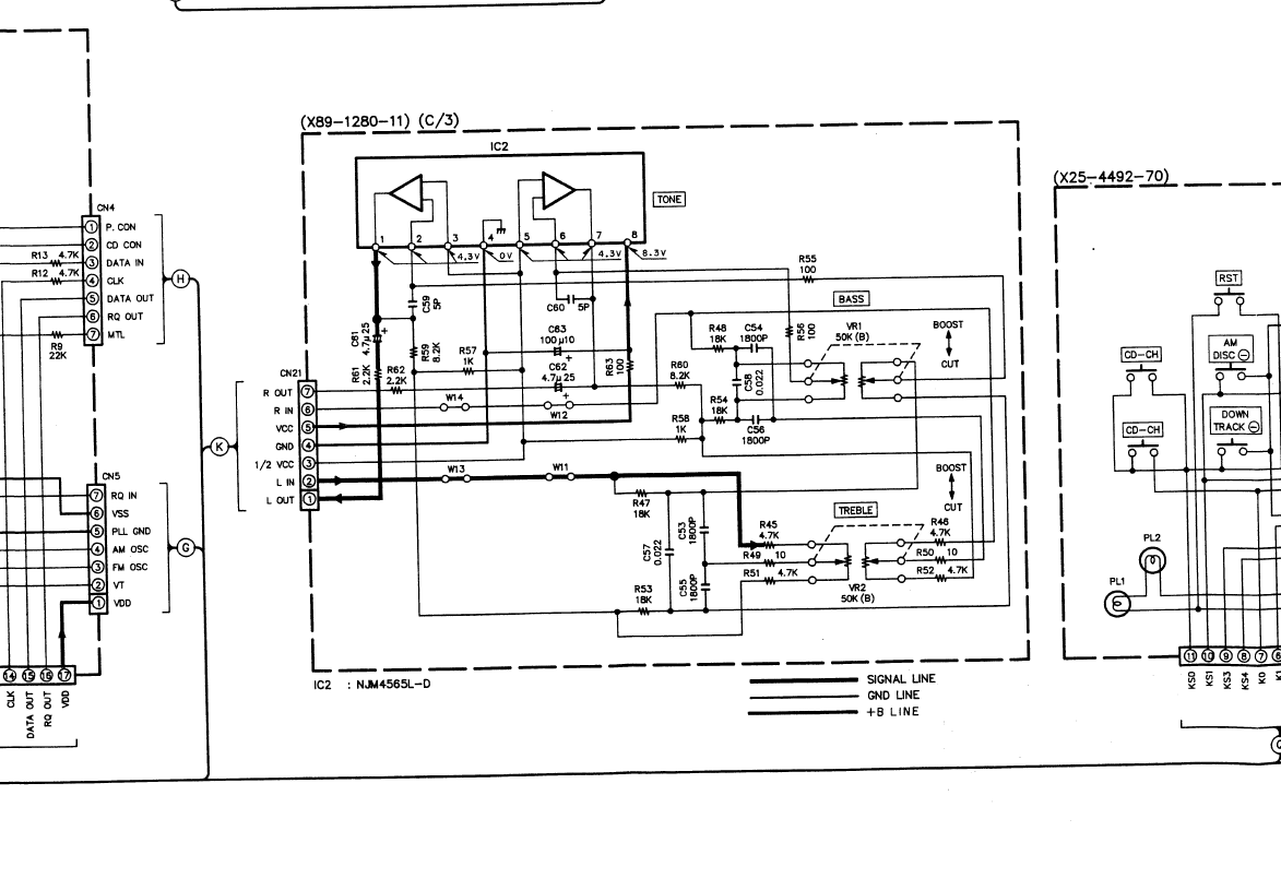

I also noticed it doesn't happen if the tone controls are set at 50% or lower. If you turn up the treble it starts to happen when the treble control hits about 80%. It happens almost immediately if you turn up the bass control past 50%.
Something in the tone control? According to the block diagram all the signals go through that board before going on to the pre-amp or power amp.
I'm going to dig into that circuit a little.

Last night I also checked the voltages at IC2, the tone control IC. And they are all way lower than they should be. The manual says they should be 4.3V on 6 of the pins, I'm reading 1.5V with pulsing on pin 2 and 6 from about 1.3 to 2.2V.

For the radio I make a guess: Some of the preamp stages are running on stabilized power. This supply has a problem and when you pull a few more miliamps it collapses. That may give you the bass/ tremble dependend on/off bump. So try to check these voltages first. It may be a dry cap or faulty regulator.
