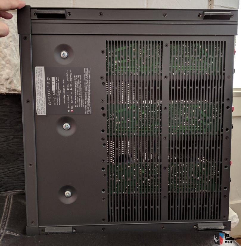

I'll try to be more helpful when I open it today, I'll take close ups split into 4 or 6 sections of the outputs plus circuit boards, everything that looks relevant Its a modular design which usually means easier to take apart and put back together. I won't touch anything I'm unsure of.

Each channel looks like it screwed in to secure with Philips heads at the bottom, then each channel section pops out from the top. I wonder if I could get the whole thing back together. It would be easier to see everything that way.

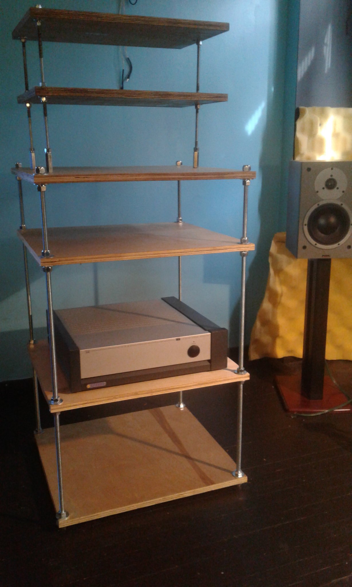

I was saving this nice finish side ply for open baffles. I need to separate my audio pile for better isolation. I wasn't planning to make a flexi design rack this weekend (hence cutting it with a jig on short notice).

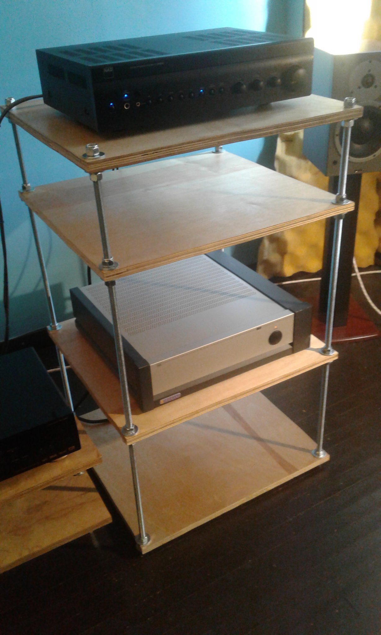

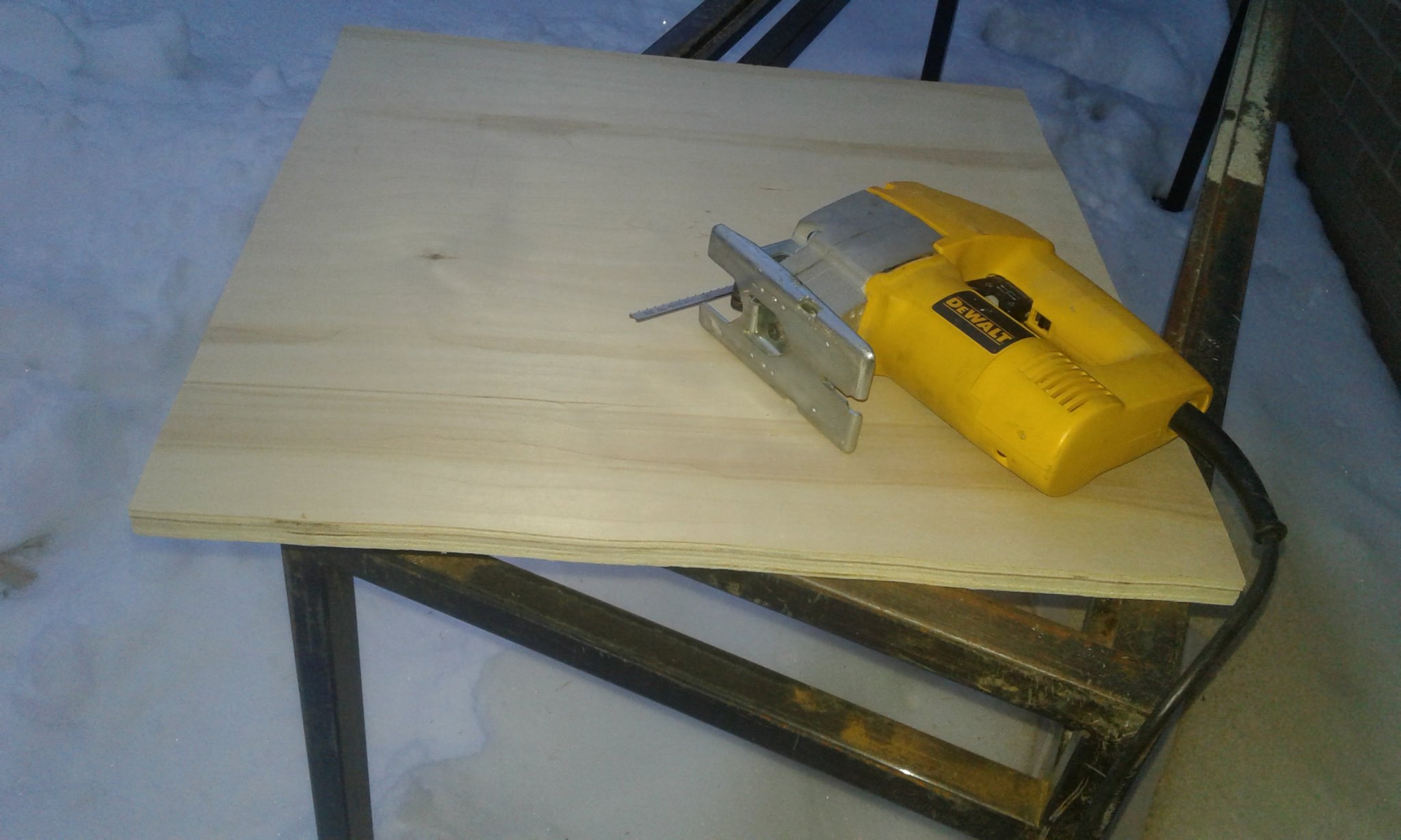

Funny thing, that old Dewalt out lasted 3 or 4 late models, and still cuts straight.

I might of had more fun cutting 10 2'x2' plywood shelves with a jigsaw.

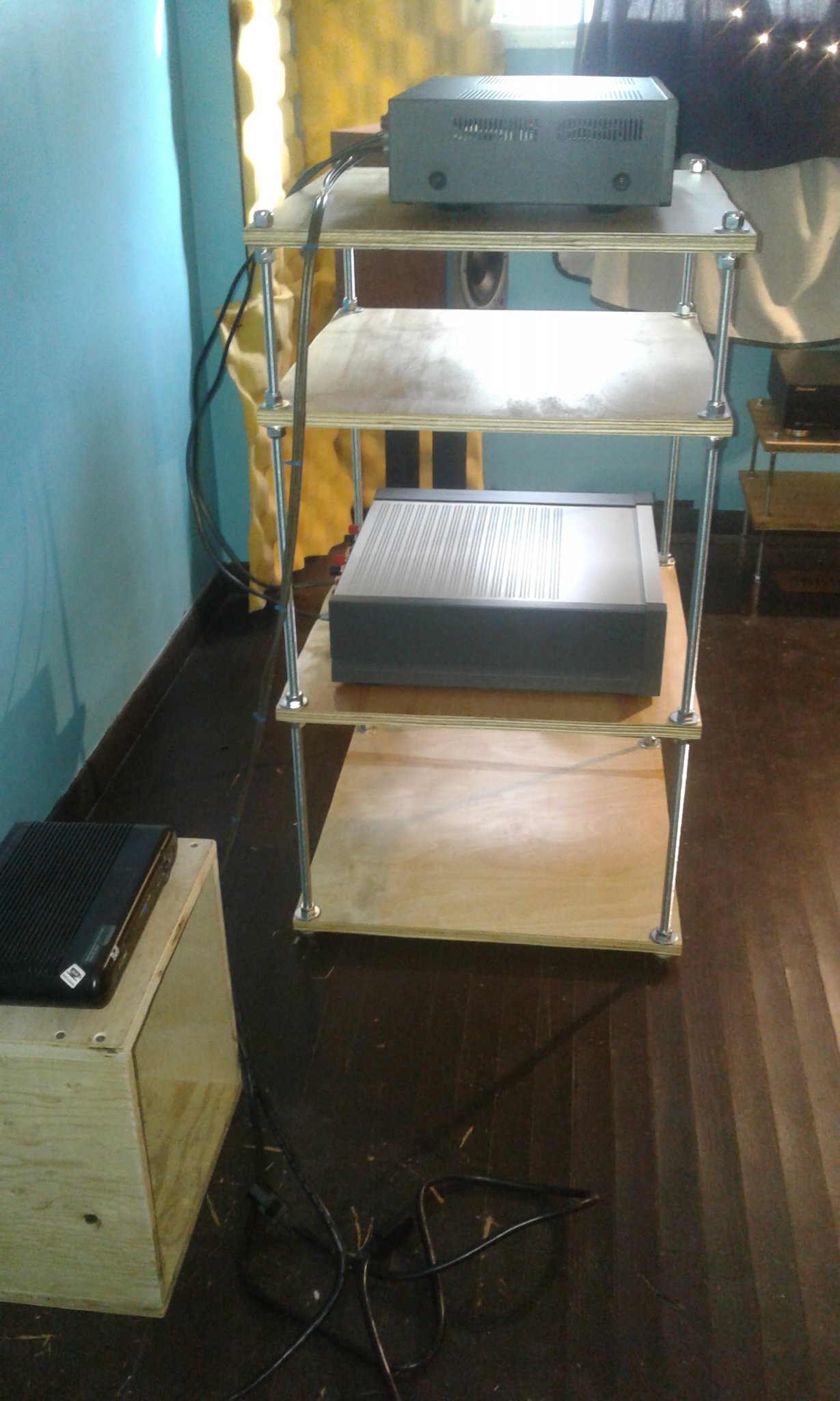

In the mean time I tidied up, no more crates to put electronics. Temporarily or other wise.
Its been ok thus far, knock on wood, no secondary noise occurrences.
Amp fits about as good as I could ask. The shelf being the rush that it was, turned out, will make a good dividing point. Now I have no excuse for messy wire or equipment or stacking or wire bundling. Although I have never stacked, that's a big no no. The whole room needs entire revamp.
