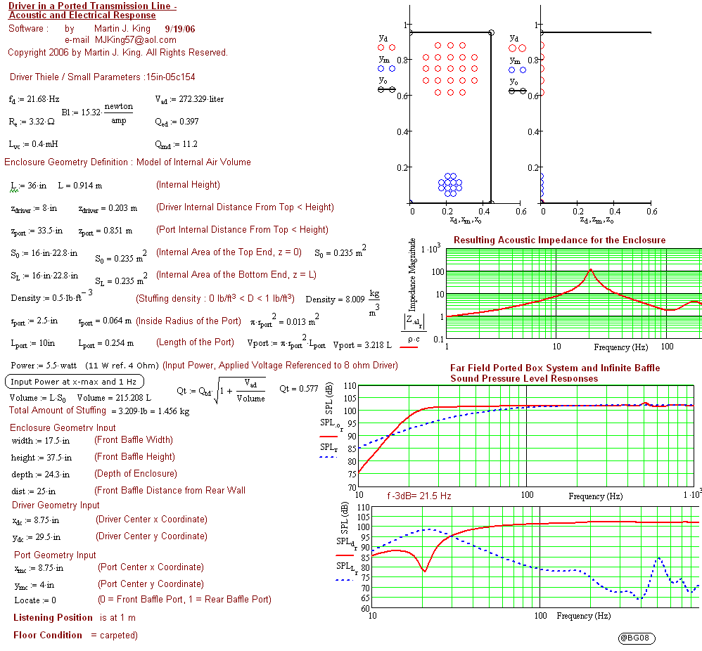

FYI: An example simulation of many possible where the line length is kept short: 1(2)

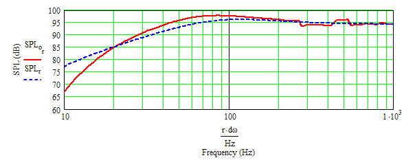

Fs, Vas, Qts sets box size and for a TL its length is normally a function of Fs, so a low Fs combined with a high Vas and medium Qts = big box. Even tuning the 05C154 up around 60 Hz requires ~6.5 ft^3 and a T/S max flat vented alignment is 9+ ft^3, so no help there. A prosound vented alignment OTOH is only ~3.7 ft^3, though of course not much deep bass output either:
Vb = 3.684 ft^3 net
port = 5" dia. x 24"
