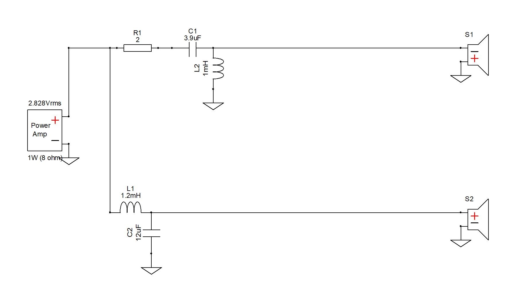

Hey everyone,
I'm a newbie in the diy speaker world and I decided to design and build my first speaker set. I was trying put together a two ways bookshelf speaker with the Scan-Speak Discovery D2608/91300 as a tweeter and the Peerless HDS-P830875 as a woofer.
I did some research in order to understand some more about crossovers and tried to design a 2nd order crossover to connect the two pieces together. The only tool I was able to use is Xsim, in order to simulate the crossover behavior.
The frequency response and impedance files were taken through the use of a graph tracer and some photoshop playing, not the best probably, but it is what I can do for now.

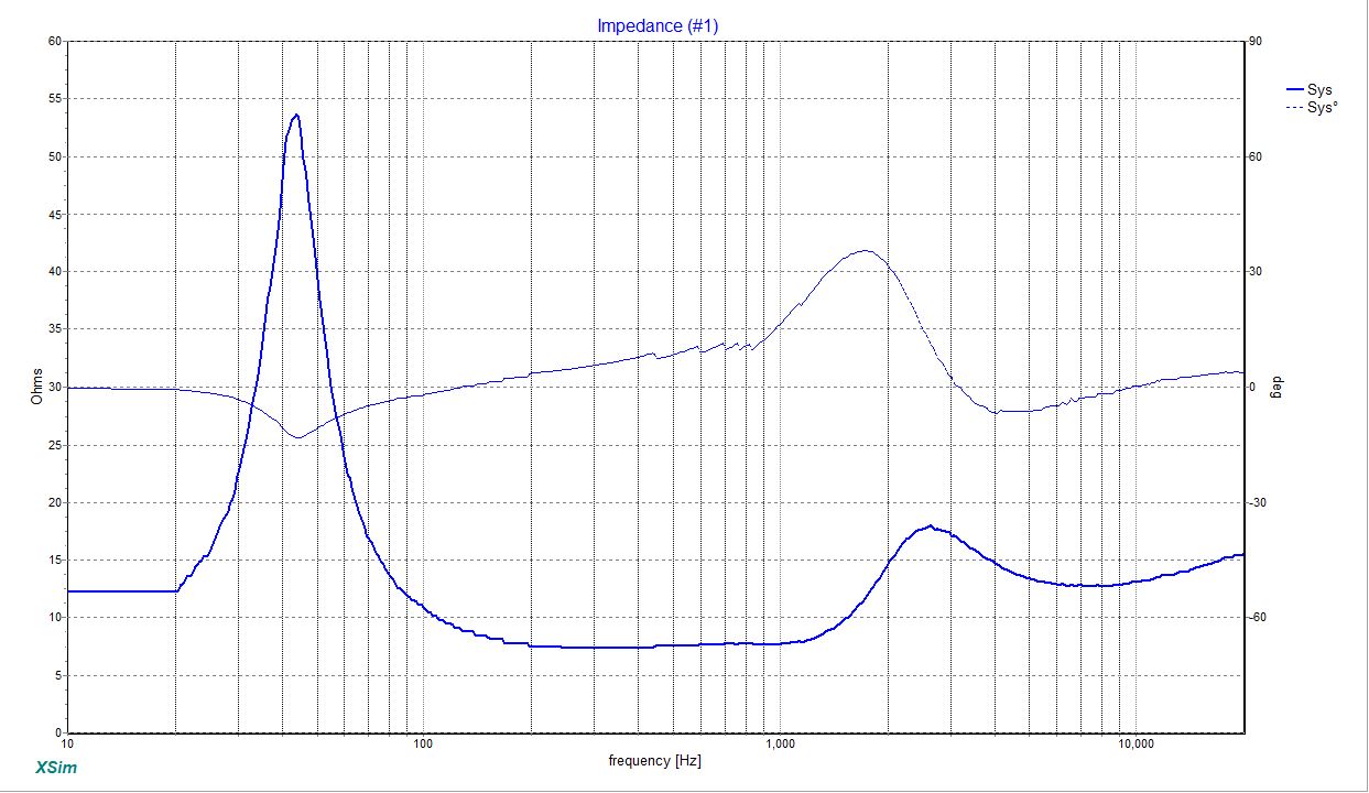

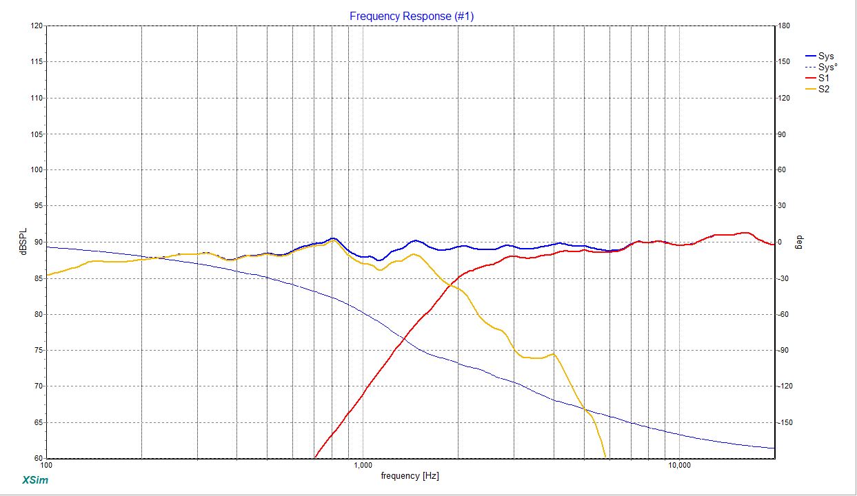

In the pictures there is the design I came up with and the frequency response graph together with the impedance graph. Can anybody explain me a little bit better what I am looking for when designing a crossover in a simulator like this one?
In any case I'm asking for suggestions and corrections of any kind, thanks in advance!
The files are attached down below, also the frequency response and impendance of the single drivers

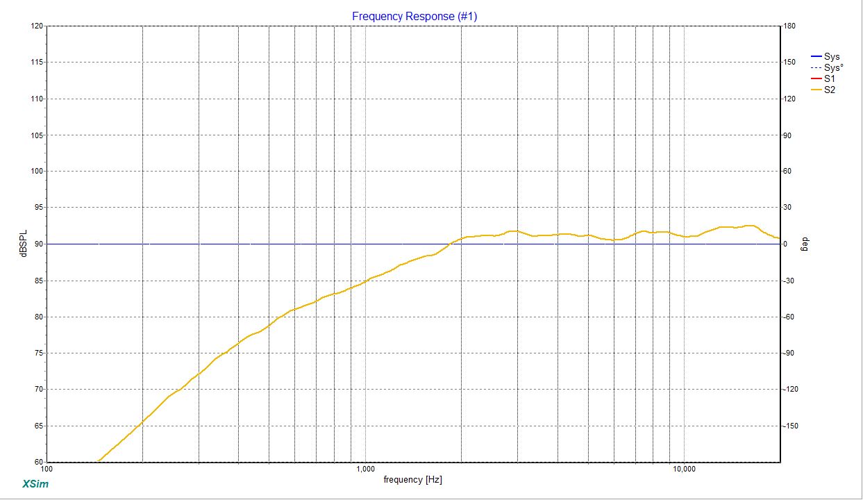

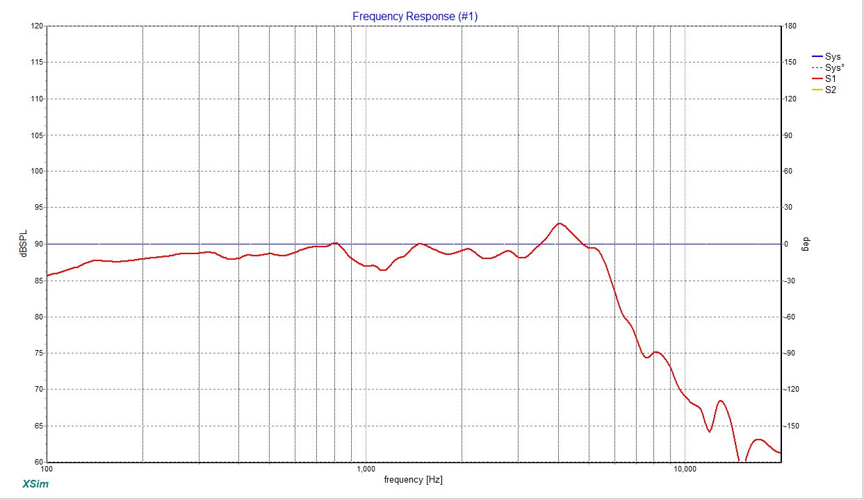

Scan-Speak Discovery D2608-91300 - Frequency Response Picture.jpg104.8 KB · Views: 132

You are doing well so far. You could turn off system phase and turn on phase for each band. You could consider the baffle step.
Do you have Microsoft Excel? Have a read of https://sites.google.com/site/undefinition/diy-speaker-faqs/simulated-measurements
He describes how to get a rough (but better than not doing it) idea of the effect of putting the drivers on a cabinet baffle, to make a better simulation.
Also, you might like to look at Troels' http://www.troelsgravesen.dk/Peerless_HDS830875.htm which uses the same driver and tweeter, but in 2.5way
By turning on phase for each band what do you mean exactly? Also is it normal to have the system impedance going so high on lower frequencies around 40 hz? It touches 50 ohms on the graph. In general what should I expect from an impedance graph?You are doing well so far. You could turn off system phase and turn on phase for each band. You could consider the baffle step.
If you bring up the box for each trace you can add phase.
Impedance should be what am amplifier can manage. It’s ok for it to vary as long as it doesn’t get too low.
