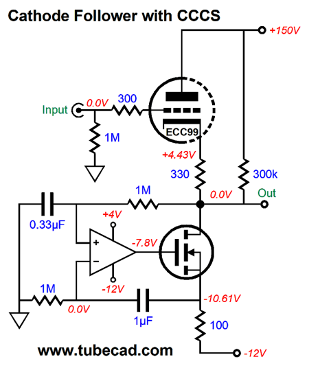

Maybe you are confused with other protocols, maybe the simulation drawings where the dots are apparently needed to make the sim work?

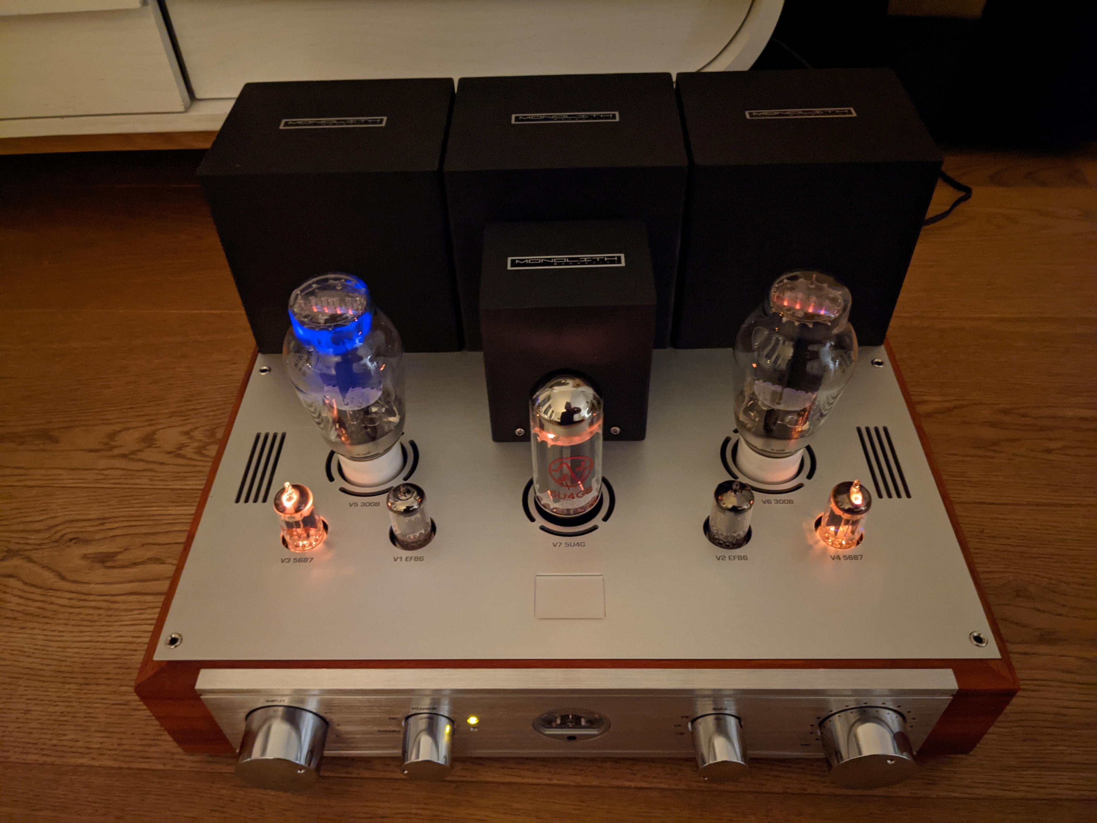

Last night I did my first serious listening and I had a big smile on my face 😀 To me it sounds awesome. Going to try the .22uf cap in place of the .015 because I already have one in my parts box, but it doesn't sound lightweight or bright at all. Bass is full and tight.
1 of the 300b's has that blue glow at the top of the tube, but I think it's fading already so I don't think it's an issue.
I have some e188cc's that I'll try in the 5687 positions and try some different EF86's I have laying around. But first impression is great, couldn't be happier

I have one thing I don't fully understand and that is the voltages on the EF86's. All readings in the amp match the schematic to a couple percent but the readings on the plates and screens of both ef86 tubes are off to as much as 20%.
I tried 2 pairs of tubes and they all read between 200v and 215v in the anode (pin 6) where the schematic says 175v. They screens (pin 1) should be 125 and I get between 109 and 117.
I'm not that worried about it but I would like to understand why this is and if I should address it (and why/how)
Thanks everybody
I am not an EF86 user.
With 400V B+, 200k plate load, 175V on the plate; that is only 1.1mA plate current.
That is what your schematic indicated. Your plate voltage is even higher, indicating less than 1.1mA
I would say that those resistive values were selected to get very large gain from that stage.
I would also say that the design is Starving the plate for current.
At that low of a current, different EF86 tubes will quite possibly have a very large spread of plate voltage.
I think you are observing that you are getting exactly what the design dictates.
I have seen other designs using EF86. Some have very repeatable voltage results from tube to tube.
Others, which put the EF86 at the extreme of low current; (or at the extreme of low plate voltage, not your case) will get wildly different results.
I will admit, I have often wanted to use an EF86 as the input tube of a 2 stage amplifier, but the high price of the tube overcomes my curiosity.
Someday . . . perhaps.
Just my opinion.
If it sounds good, I bet everything is OK, even with the different voltages. Do not worry, it will not burn out.
Happy listening!
You might try changing the EF86 cathode resistor from 2.2k to . . .
Either 2.0k
Or 1.8k
Then reduce the Screen resistor from 1Meg in series with 470k, to . . .
Either 1Meg in series with 330k
Or 1 Meg in series with 270k.
That might make the voltages closer to the schematic,
But it might or might not change how it sounds.
