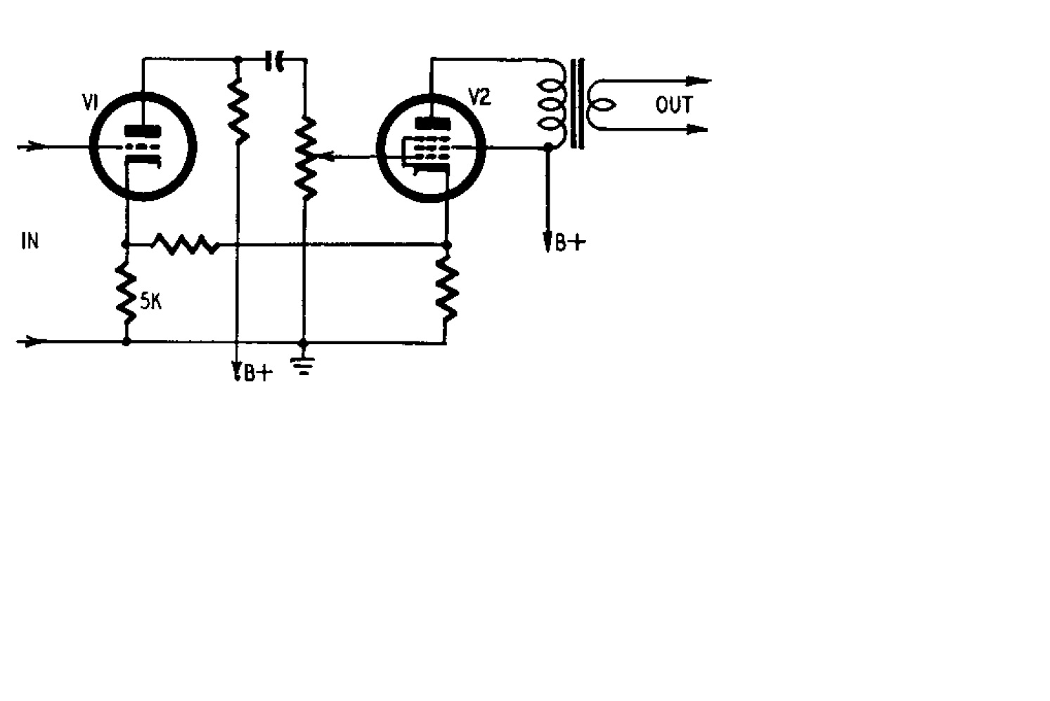

Well done to draw the red dots; however these connections are obvious...no place to go elsewhere.
There are two "crossings" of lines where it might have been better to follow normal drawing protocols but it is obvious enough as it is, at least to be able to read the schematic correctly.

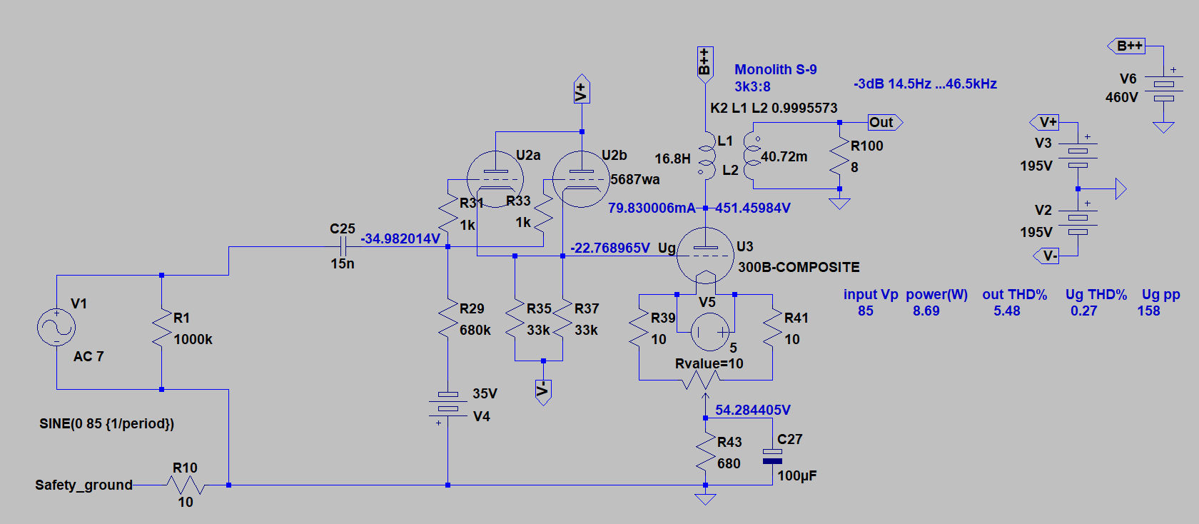

Biggest problem in my view is the 0.015 uF capacitor / 680 k resistor combo, which makes a 15 Hz high pass.

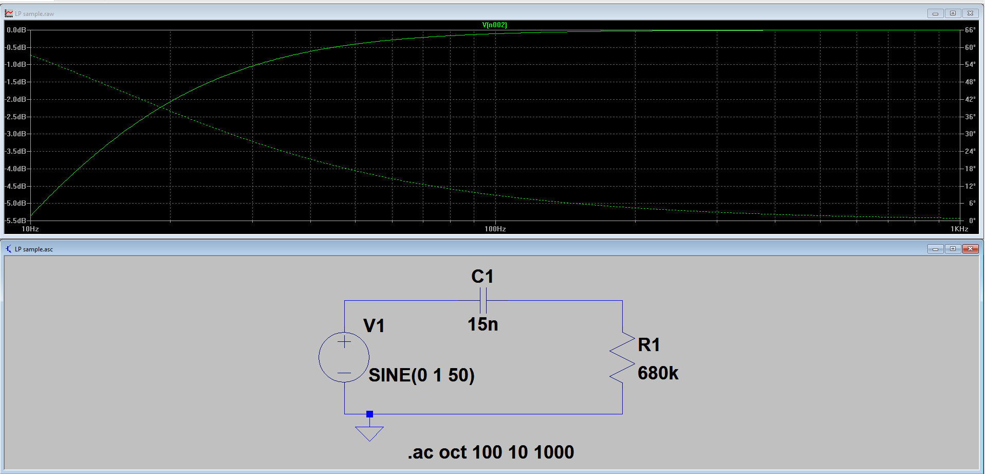

That combo makes for a 15 Hz high pass, which is an engineering mistake compromizing the performance.
Together with the bandwidth of the output transformer it might give unsufficient bass response at the output of the amplifier.
Funny drawing you come up with...
The dots are not necessary; the two crossing could have been drawn better, but you don't even have to be a university student to grasp....

I tested C26 and C24, capacitance measurements are good.
Did you check R29/30?
68k instead 680k makes 156 Hz high pass...

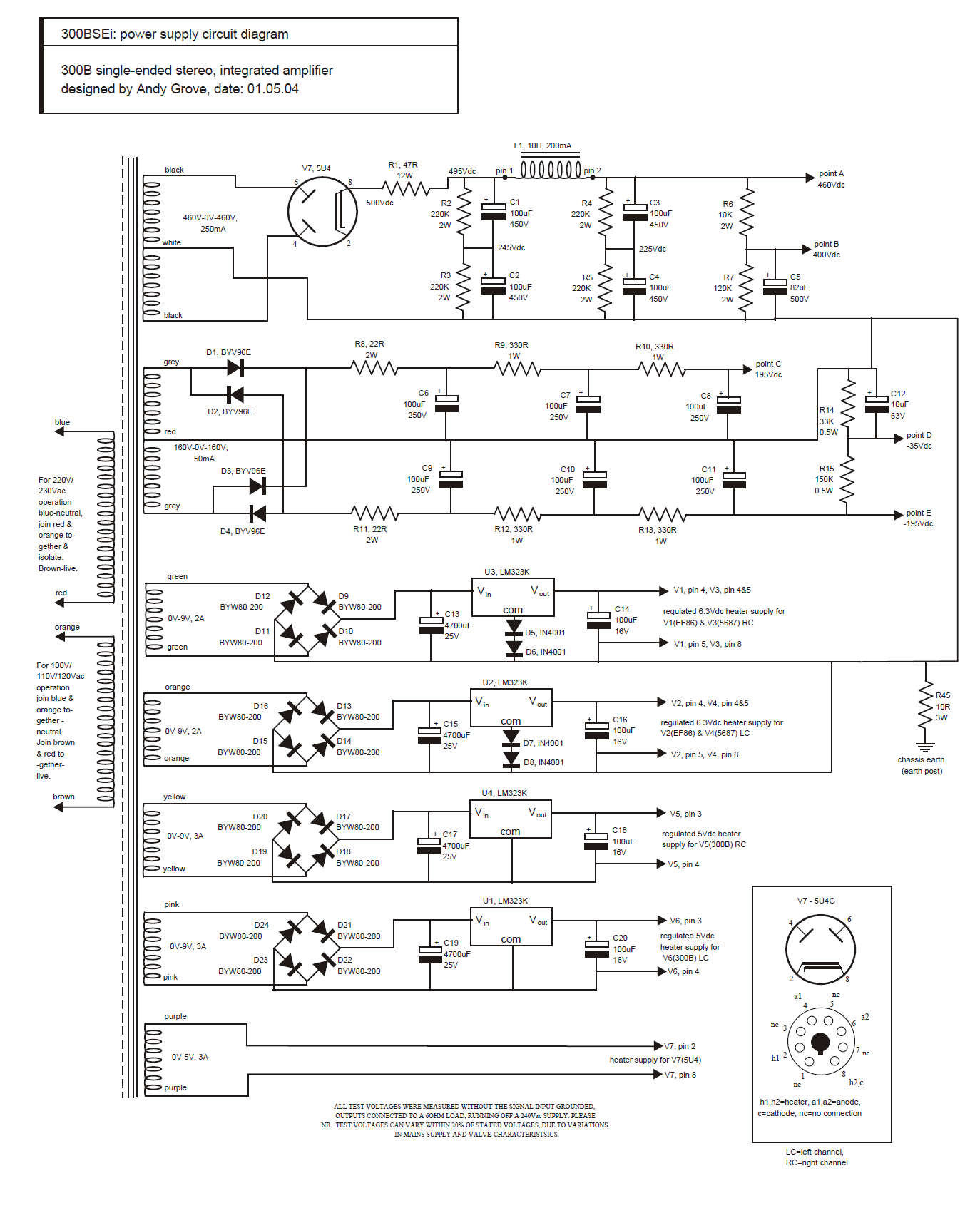

You did not show the power supply schematic.
I bet before the tubes warm up, the B+ is more than 400V (solid state diodes, no load).
And the bias is -35V.
C25 and C26 are subjected to at least 435V before the tubes warm up.
But they are only rated at 400V. They may be leaky by now.
Use a 600V or 630V part.

The bias is not -35V.
Fixed bias is -23V (grid, relative to "ground") and cathode bias is +57V (cathode, relative to "ground"), so overall bias (grid relative to cathode) is -80V.
Monolith S-9:
single ended output transformer
3300 Ω to 4 and 8 Ω
optimized for 3 0 0 B type power triodes in 10 Watt mode
(400V 80mA condition)
Primary DCR: 107R so anode at 451V.
Anode-cathode voltage: 394V.
300B operating point:
-80V, 394V
Current from datasheets (depends of manufacturer): 80..85mA.
IMHO schematic and bias point are OK.

The driver and output section IMHO is correct design ... apart from mixed bias (I prefer fix bias method).
Not the lowest distortion amp, but tolerable.
The - simmed 14.5Hz - LF limiting due to the 15nF - 680k.
Increasing the capacitor, or decreasing the resistor also helps.

I've attached the PS schematic for good measure.
Supplies for the heaters is different, I'm using Pete Millet's regulated filament supplies (x4).
Primary on the PT is 440V instead of 460V, my choke has about 100ohms less resistance.
With some of you discussing C25+R29 filtering out anything below 15hz, what benefit is there having a lower cut off? I don't think I'll ever own a speaker (or ears) that can render anything below ~20hz

It's still like to hear more about the high pass of 15hz and why maybe it's not ideal.
Another lesson learned 🙂
Really appreciate all your help.
Just some tips for better sound:
To put elcaps in series is a bad idea, one cap with higher voltage rating instead of 2 in series sounds much better and faster. Even better use MKPs like Solen 100uF/630V with a 0,22uF PIO.
Replace the first resistor after rectifier (47R) with a choke. That will lead to more body, better textures and easier sound. If you dont want to buy another choke put your existing choke in that position and use a resistor in the old choke position. Beware of voltage dropping after changes. If you dont use Lundahl chokes you give up at least 50% sound quality.
As you can see, the 15Hz highpass filter has -3dB at 15Hz, but till to 100Hz modifies the transmission.
If you lower this breakpoint, this interference decreasing in the audible range.
But using too low lower breakpoint also be avoided.
Absolutely. Change that bloody cap to 0,22.
Thanks, what's that program you're using?
Hz(-3dB) = 1 : (2 x Pi x R x C).
C in Farad.
So, in your case 1 : (2 x 3,14 x 680000 x 0,000000015) = 1 : 0.064 = 15,6 Hz
Replace the 15 nF with 100 nF.
C in Farad.
