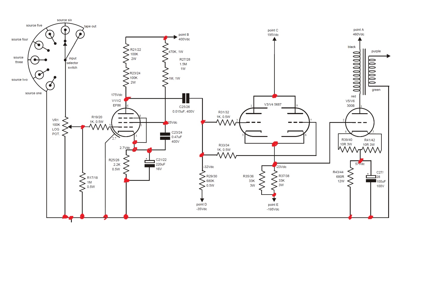

Finally finished my long term project, the Glasshouse 300BSE amp.
I fired it up, checked all the voltages and played some music for the first time.
The issue I have is a very thin sound (no mid/low frequencies) at very low volumes. I'm guessing max volume is 60-70dB
I've attached the schematic and all the voltages check out to a few % except on the anode of V1 & V2 (the EF86). That should be 175V and measures 212V.
The original amp uses a 2.5K output transformer, I'm using a 3.3K OPT.
No noise, pops etc. when turning on and playing. Only thing I thought was weird is I measure 0.2 ohms between the OPT common and 4/8 ohm tabs (while turned off). Is that normal?
Any help is appreciated
Cheers

Yes, that is normal.
You are measuring the DC resistance of the secondary winding.
Pentode plate voltages tend to vary tube to tube. 212V is not wrong here.
Transformer DC resistances should be 10% or less of the nominal Audio impedance. So 0.2r is not wrong for a 4r winding.
"NO" bass suggests a too-small cap or a too-small grid resistor. A popular fault is to put a 1k where a 1Mge should be (resistor stripe colors, or box mix-up).

C27 being 100 uF would be OK for a high pass of a little over 2 Hz together with the 680 ohm resistor.
However, C25/R29 gives a high pass of 15 Hz, so there something is wrong.

The whole schemo is strangely drawn. Resistors in series, resistors in parallel, and no dots where connections should be. Nobody knows, where wires connect and were not.
+1. Depending on how you read the schematic, the EF86 is running triode wired and very starved!
I see the EF86 running pentode.
Cathoder follower driver stage.
Combined fixed and self bias output stage.
You guys are smart enough to draw the dots where they belong and where not.
Actually, the schematic is drawn correctly: no connection where lines cross.

1. Many people think to use a small pentode on the input stage is a good thing. I say you will get a bright & lightweight sound especially with an EF86. It will sound weak and thin. Sound-wise to use an EF86 is a bad idea. WE used a pentode on the input but the WE pentode do sound very different than an EF86. I have build 300B monoblocks for over 30 years and think that triodes do sound much better than pentodes on the input. Simple 6SN7 stage will outperform ANY pentode by far. A 6N6P will sound stellar in combo with the 300B.
2. C25/26 is too small. Maybe it is enough to produce low bass but a higher value cap do sound much fuller. Use 0,22uF at least. If you want it even thicker use 2,2 - 4,7uF. Use PIO (Jensen or Arizona Blue Cactus) or Russian hybrid cap K75 (cheap).
3. Use a high quality audio cap on the 300B cathode. At least use a Nichicon VZ or Solen MKP with a smaller cap (Jensen 0,22 PIO) to get rid of the upper mid haze of most cheap MKPs.
4. Use carbon film resistors (KOA/Kiwame or Takman) or at least Mills (now Vishay MRA) or Holco (but only the old UK made, the new US made are magnetic and do sound much brighter and simply unbearable).
4.The drawing is awful.

Thanks for the replies. A little more info: when I say no bass, I mean literally like only the tweeter of the speaker is playing. Not like in "this amp is not my cup of tea, it sounds thin". The speakers are 90dB+ and max SPL sounds like maybe 60-70dB.
Cathode cap is a 100 uf silmic. Output transformer is a Monolith Magnetics 3.3k.
I agree the schematic is a little ambiguous, but as mentioned, crossing lines have no connection.
I tested C26 and C24, capacitance measurements are good.

There are two "crossings" of lines where it might have been better to follow normal drawing protocols but it is obvious enough as it is, at least to be able to read the schematic correctly.
Biggest problem in my view is the 0.015 uF capacitor / 680 k resistor combo, which makes a 15 Hz high pass.
Well done to draw the red dots; however these connections are obvious...no place to go elsewhere.

Schemo is OK. So check and double check voltages and wiring. Check signal tracing with a signal generator. You should have a defined signal loss at the output at low freq.
We don't know the PSU. Could be a faulty PSU, too.
Mono Magnetics aren't cheap, so there should be substantial base repro.
Change the bloody cap to at least 0,22uF PIO.

Make the amp perform flat in the bass; only the output transformer should be the limiting element.
When still not giving a balanced sound, check PSU.
