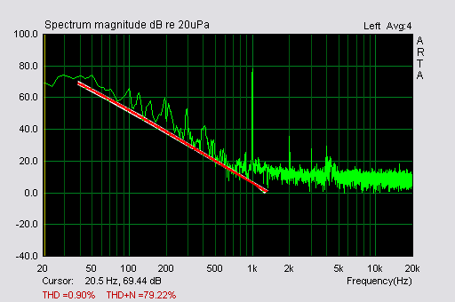

I've been playing around with my setup some more and something is clearly wrong here! There appears to be noise rising at about 6dB/octave (see red line on attached plot: 6dB/octave slope for comparison).
Anyone have any ideas why I'd get this noise? The following plot is a fairly loud (overloaded perhaps) 1khz sinewave test.

Good job tracking it down to that and putting in the lines- it definitely looks like some phenomena that we can isolate.
Can we get some more description of the measurement setup?
Amplifier?
Mic position?
Speaker position in room?
Room size?
Ambient acoustic noise?
If the trend started at a lower frequency, I'd suggest it was room gain. As it is, your room would have to be the size of a speaker cabinet to explain this (although it would explain it rather well). The next thing I'd look for is the amplifier- if it's a receiver, is it possible that it might actually have a bass boost of some sort?
I would ask how sure you are that your speakers are relatively flat, but 40 db bass boost doesn't seem like you could possibly not notice.
Finally, the measurement settings in software could have something to do with it. Maybe one of the gurus knows something- I don't, I'm on the same learning curve as you right now. I'll play around a little bit with a loopback and see if I can recreate something like what you have.
Oh- something reminded me of feedback... there's no chance that the microphone input is being played out of the speaker, is there? That'd probably just squeal, but with test tones I can't be sure of the behavior.

Thanks for replying Joe.
The amp is my hi-fi amp (no boosts or anything other than a small baffle step correction circuit - 3dB more or less).
The mic gives this kind of respone anomaly anywhere in the room, and even out of the room.
Speakers are where they sound best, what more can I say?? It sounds good. The system does NOT have 40dB of bass boost.
The room must be about 3 x 4 x 3m or so.
For comparison here is a pulsed white noise plot taken from my listening position using my cheapo microphone (using the same preamp but NOT phantom power). 1/3 octave smoothing.

One other thing... I played an mp3 on my computer, quietly, and monitored the signal with the spectrum analyser graph in Wavelab - there was a distinct lack of high frequencies. I recorded the sound and only bass came through!
I just stuck DVM probes into the XLR lead connected to the mic from the PS400 box to confirm the existence of 48vdc.
It's looking strongly like the ECM8000 is faulty 🙁

Well I think my ECM8000 is faulty, so unless anyone can suggest an alternative line of action, I'm sending it back on Monday.

Hi Simon,
I'm not so sure it's your mic. I assume you're following the farfield measurment procedure: mic at > 0.5m, < 2m, taking an impulse response, setting the gating period approrpriately then viewing the FR.
Try doing nearfield measurements and see what you get:
Keep the mic <5mm from the bass driver cone. Using a low sample rate and take the impulse response and then view the FR.
If you like I can send you my mic and preamp to compare (as long as you send it back asap).

Hey Vikash,
I've not followed any specific procedure, I merely have experimented, and ultimately began trying to measure my listening position's fr. response.
I cannot take an impulse response using this setup: that requires extra connections, which I've not attempted to make yet.
Whatever I do with that ECM the results look terribly wrong.
Finally, when I recorded music through it ALL the treble and midrange information was lost. Not a "bit dull" but "completely useless". By comparison the Prosound mic sounds tinny but as expected, showing some energy across the board. The ECM looks as though everything's going through a low-pass filter!
Thank you for your kind offer to lend equipment. I do not think we need to go that far, as I am convinced my mic is faulty. I will send it back and demand a replacement.

Can you remove the maplin preamp and go
ECM8000 -> PS400 -> line in?
Svein said the PS400 is phantom power only and not a preamp.... however if Svein says all he uses is the panasonic capsule and 9V battery simple power supply (phantom?) - isn't that the same as above? (ECM8000 -> PS400 -> line in)
it could be your maplin preamp screwing things up.
If the above works - please let me know... as Iwould like to order too.
