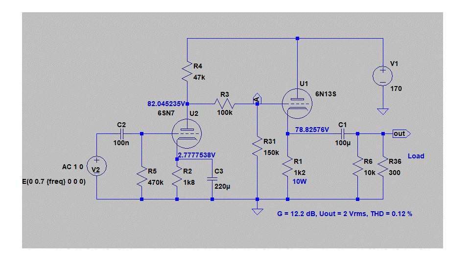

@artosalo, now is sounding well, what resistors values R3 / R31 to increase a little bit the gain without affecting the bias of output tube?

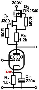

LND150 is for sure better for low currents. However, you could try this:

Could I try for 7N7 in place of 47K in your 6AS7 OTL headphone amplifier?
No, in place anode resistor as active load.

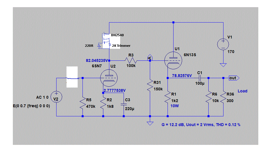

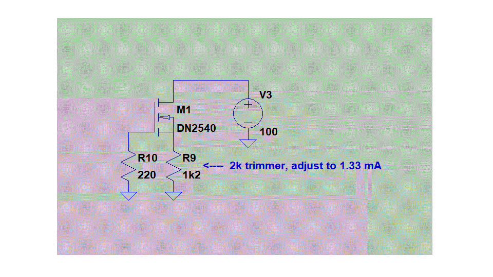

I gues I need to reduce the B+ 170V to 100V for the CCS?
No, just adjust the current you want with the 2k potentiometer at the source of DN2540.
Then, with R2 you can adjust the anode voltage of 6SN7 as you want.
To adjust I will use trimmers, once adjusted I will change to fixed resistors, thanks for support artosalo and have a nice week-end.
Another question what's the best load line for 7N7 in V & mA?

Yes, that will work. You will need to adjust Rs to get the current you need.Hi Merlin, I can't source J309 trough hole only SMD but can source J107 it's OK?

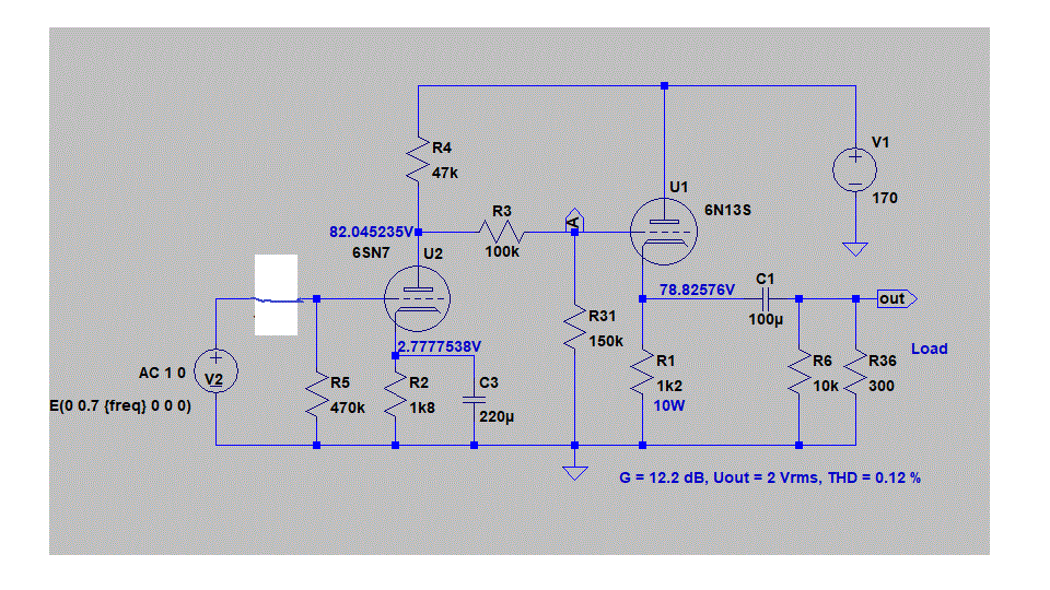

What happens if I change Ua & Ia of 7N7 to the grid bias of 6AS7?
Low current, high-Z CCS from my book.
Felipe, I use this schema... but with lnd150 cascode for ECC83 and only Ia 0.8 mA !!!!!
It works fine.
Because the ECC83 have a high internal resistence I use de "mu" ouput for low Z adaptation.Genial.
