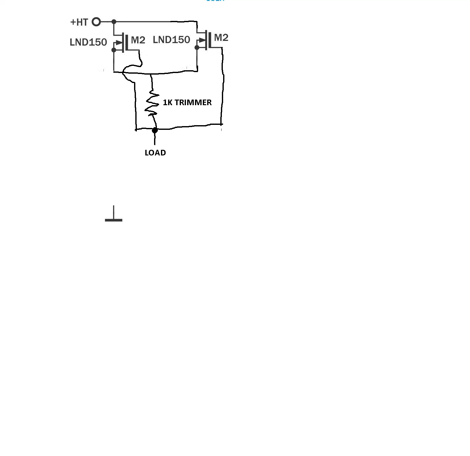

Select, or Parallel a couple of these: http://ww1.microchip.com/downloads/en/DeviceDoc/LND150 C041114.pdf
Thanks Artosalo, I will try beause I have on hand DN2540.

Thank you Sheldon, could you post schematic or link to schematic?
The schematic is on the data sheet I linked (Id vs Rsource). You can see that the temp coefficient is stable about 0.6ma current. So parallel two FETs with a common source resistor. Source resistor value will be 1/2 of that for a single FET. Resistor value would be about 500R. Start with a trimmer, then replace with a fixed value if you like.
Yes, as I said in my original reply, one can select parts with high enough Idss, so that one will suffice. Depends on the power handling limits of the part, whether or not parallel devices are required. Merlin didn't specify voltage and I'll leave it up to him to do the analysis. Can always cascade too if you need higher dynamic impedance. Parallel parts in the top half, single part on the bottom. Trade-offs, as always.

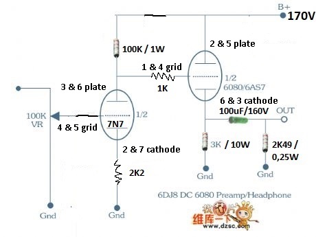

Or, to have the current source self adjust as the tube ages, and to complicate matters just for fun, a gyrator would be even better. An example in the final stage of this phono amp:

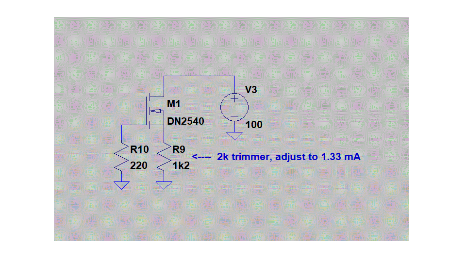

With 7N7 you can use much higher anode current than 1.3 mA.
Practically up to 10 mA, so you can manage with DN2540 very well.
So It will be better the standard CCS cascode DN2540, If I'm right I remember the best CCS for 7n7 can be 8mA?
