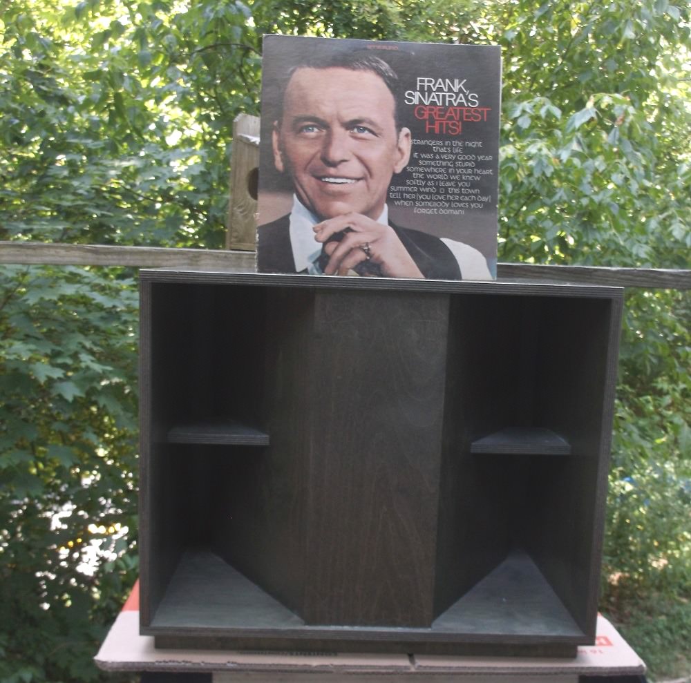

Karlson boxes give great impact but are also limited unless tuned low. That said, Exemplar used a standard Karlson K15 tuned to ~28Hz with two 3"ID pvc elbow and boosted at ~Fb to augment their horn system - it sounds very good - I don't understand why as the front chamber's tuning is around 110Hz and should be out of the picture pretty much with an 80Hz or lower crossover.
An 18" speaker can be used in a K15 size K-coupler with good half space support to about 60Hz and will sound powerful even at low levels.

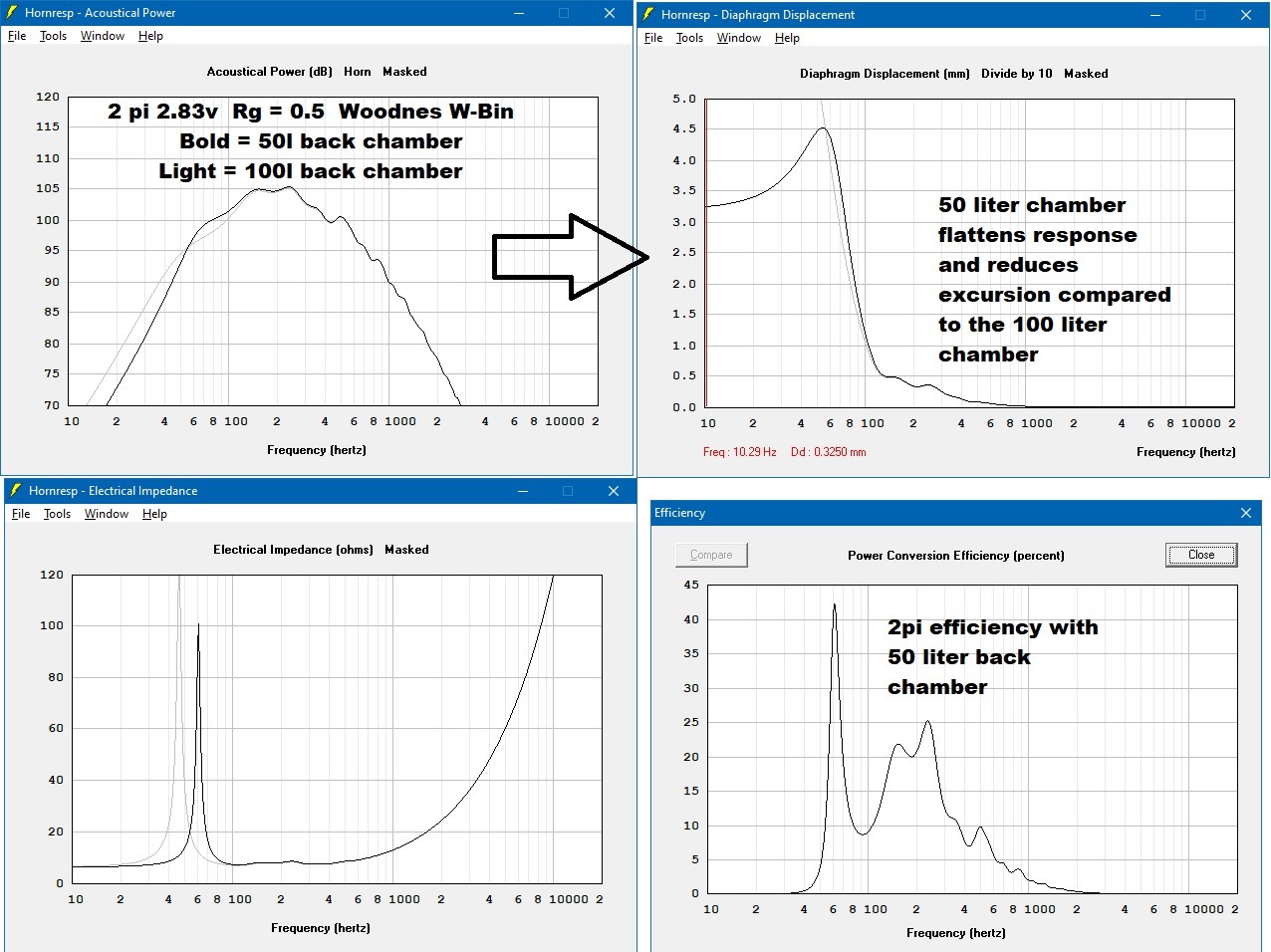

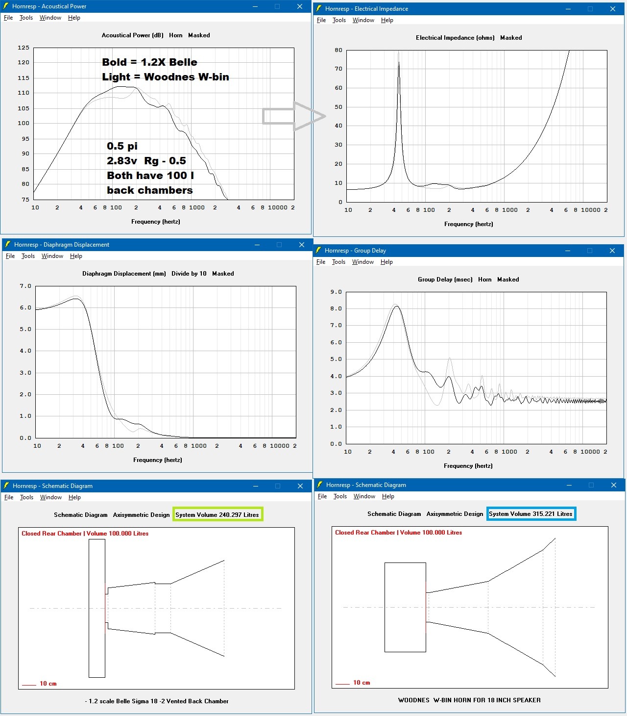

OK - lets take a Klipsch Belle W-bin and scale it 1.2X for an Eminence Sigma 18 - that's roughly 3 feet wide by 29" tall by 21.5" deep. The path length is somewhat shorter than your drawing but not off horribly for what matters.
Here's the response with a sealed back chamber for 1 pi and 2pi and also for 1 pi and 2pi with the back chamber vented. I didn't put the impedance/excursion graphs in this picture as response was the major question. It could be tuned lower and EQ applied as with 6th order reflex.

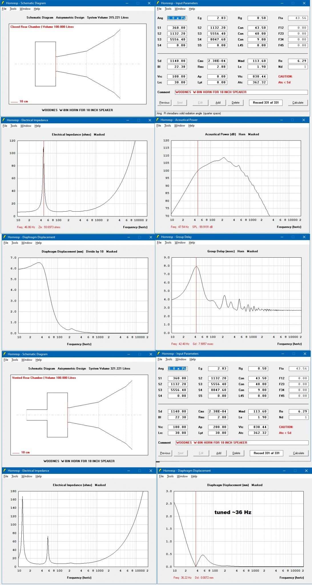

OK - I gave a try with your horn - its certainly a pretty fold - i left the Eminence driver from the previous scaled Belle sim - and assumed around 100 liters for the back chamber (they can be too large and have to be blocked down in volume)
I probably botched something - take a look - I added a vent for one sim.
I think the rise in excursion below 100Hz is where the horn has transitioned to a mass loaded BP4 of sorts. A smaller back chamber can help.

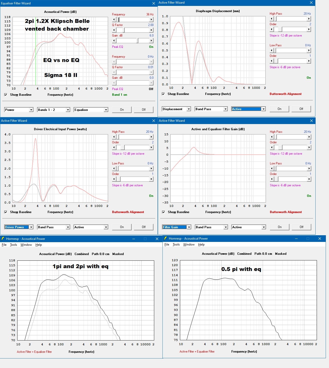

Here's 2pi performance. FWIW for punch I would consider a K18 Karlson box - but will not go "low" - guess some things depend upon your favorite genre and when/how its recorded. (The K18 could always become your bass rig. That box with an 18 was 226 liters external volume and good to ~60Hz )

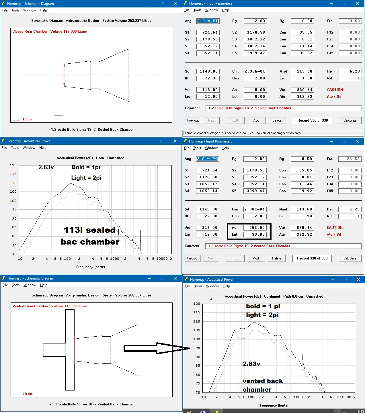

Here's that 1.2X scale Belle vs your horn in 0.5 pi conditions with both having 100l back chambers and the same Eminence Sigma II 18 driver/
- performance is virtually identical but Belle (and La Scala) has a flat spot in ifs path where there's no expansion and that shows in the response curve.
Best IME to tune it to the horn's BW mean, i.e. sqrt(throat frequency*mouth frequency), so only reduce it if the box will be too small to contain the driver.assumed around 100 liters for the back chamber
Thank you very much freddi!Here's that 1.2X scale Belle vs your horn in 0.5 pi conditions with both having 100l back chambers and the same Eminence Sigma II 18 driver/
So now we are going somewhere.
Back chamber in my design is 111 liters,with woofer volume.
Im gona check belle dimensions to see what can i do in my mesurments. Belle is maller so maybe i can copy mesurments and see where that go. But,w bin also looks ok regarding how is calculeted and constructed.

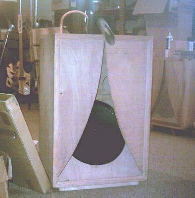

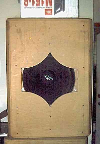

If i put karson box side on the floor insted of bottom on the floor,has that any impact on the sound?Here's 2pi performance. FWIW for punch I would consider a K18 Karlson box - but will not go "low" - guess some things depend upon your favorite genre and when/how its recorded. (The K18 could always become your bass rig. That box with an 18 was 226 liters external volume and good to ~60Hz )
Probably not in the bass region but IIRC sounds worse when run full range. Karlson's K12 (and assume the "Dutch K12") could be fun with FE206 - again won't go s low as a long path BLH but fun and punchy.

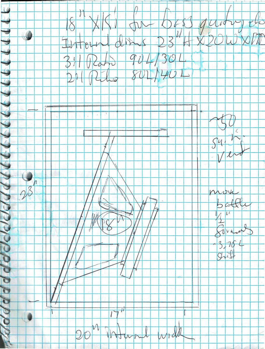

for a bass guitar box no more than 2 foot tall maybe something like below with K-aperture would work OK
With 111 liter back chamber you could have the option of venting it plus EQ. Whether that would sound better = ? but seems like it could add low end extension. You could ask about sound quality from those who tried DJK's "Vented La Scala" mod.
