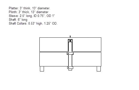

Not finished, but I have some parts..... description is here....
http://www.diyaudio.com/forums/showthread.php?postid=741765#post741765
The s/s rod I got (0.50") slides nicely into the bronze sleeve with zero lateral play. However rotation is a bit sticky. There is a post somewhere noting that sintered bronze doesn't release its impregnated lubrification unless it rotates at high speeds (ie faster than 33.3 rpm....). I am now trying to source a cheap teflon tube to compare it with.
When I've worked out what works best, I have to get a wood platter made and then machined on a lathe and a perfectly concentric hole cut to insert the bronze/or/teflon sleeve into. That will be the hardest part methinks.
At the same time, I'm still undecided about whether to put the sleeve in the platter or the plinth (inverted).
It's a work in progress. At this rate expect a solution sometime in 2008.....
OK, here's a plan I made a while back.
the parts I eventually got (no part numbers, sorry, just stuff I picked up in a bazaar) have changed, notably with the sleeve having an ID of 0.5" and the rod having a diameter of 0.5".
The alternative I may end up doing is to get a teflon sleeve and fit that into the plinth, seal it at the bottom so it acts like a bath for lubricant (like special teflon lubricant).
This means I have to get a nice tight fit of the S/S rod into the platter. Not sure how.......
Years of experience with prototype work on centre lathes tells
me that unless you do the final finish turning with the complete platter/bearing assembled and clocked up in a 4 jaw -- It may well
throw ----The diameter of a vinyl platter amplifies any slight pressing assembly errors.

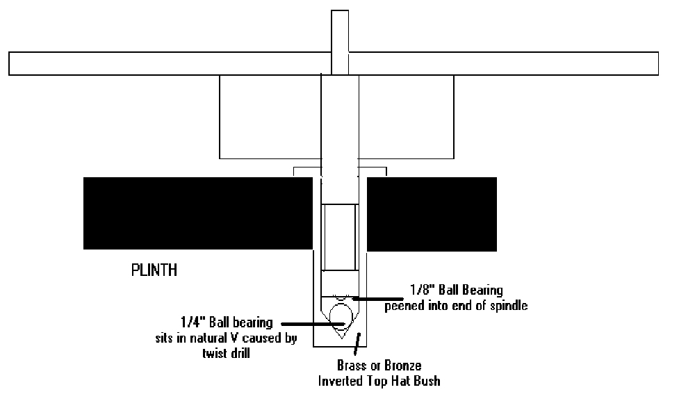

Thats why the shaft on my set up is integral with the platter and the double ball is in an iinverted top hat oil well.
Baggins: I for one would love to see a diagram of this arrangement.

If the 2 ball bearings are made of the same material and hardend to the same hardness you MAY have a problem with microscopic galling on the mating surfaces.
It's usually best to use dissimilar materals or at least different harness materials in this application.

Here it is :-
Thanks very much for the sketch, baggins. Looks like a nice, simple arrangement.
In view of andirocks comments, you might like to know that it is possible to find ceramic bearing balls. They are used in turbine engines (helicopters) and some other very high speed applications. I don't know exactly where to get some, (maybe a local aircraft mechanic could supply a few derated pieces) but a web search should turn up something.

Just to be clear this bearing was not in the original Amstrad design.
Its so long ago Ive forgotten the original design ,this is what i came up with when I redesigned the whole platter /drive system to take advantage of what I considered to be a competent tone arm
(relatively speaking ). So I DID fix it so to speak!
Regarding searching out high tech ceramic balls ----- why ??
2 high carbon Hardened steel ball bearings are never going to spall
running in an oil bath @ 33.33333 rpm (excuse the lack of threes!)
the point contact has hardly any friction area !

The "small" area of contact must withstand a tremendous amount of force so the harder the contact area is, the better. I use Tungsten Carbide and Sapphire/Ruby in my bearing designs to minimize wear and friction over time. If your platter is of fairly light weight (2kg), Rockwell 68 ball bearings should be more than adequate.
To be honest the maths eludes me but assuming some slight compression of the balls I doubt if even in the worst case scenerio of a heavy (and mine probably weighs 8Lbs or so) platter they would flatten to the point of creating a large enough area of friction to generate enough heat for spalling or much noise for that matter!
I can only reiterate that this cloth eared old bugger hears far more noise from the motor (at what my wife considers excruciatingly loud sound levels) than from the bearing system.
