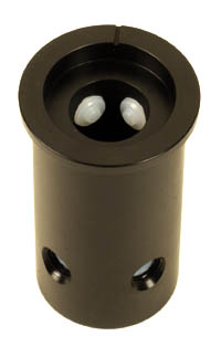

well, at least on paper and thanks to Izhak -- who I've been in touch with off list and who has been enormously helpful.
Basically, what Izhak has done is to use standard off-the shelf bearing parts. These can be found at at places such as mcmaster.com, sdp-si.com and smallparts.com (all US websites).
A stainless steel rod with 0.7500" diameter is attached to the plinth, sticking upwards. A self-lubricating sintered bronze sleeve, with an internal diameter of as close to 0.7500" as possible (such as 0.751", 0.752" or 0.753"), is placed inside the platter.
The inside end of the sleeve needs to be grooved by a machinist, so a retaining ring can be put inside.
Below the retaining ring goes a thrust plate, perhaps cut from a delrin rod and below that goes a ceramic ball (Izhak uses 3/8" diameter, like item number 9576K38 at McMaster-Carr ).
And then the shaft goes in the sleeve, and the thing should (in theory) spin.
I've been reading up on these bronze sleeves -- they are impregnated with oil and designed so that when it spins, the oil seeps out and lubricates, and when it's not spinning, the oil is absorbed back into the sleeve. Fascinating stuff.
And there you have it. Total cost well under $50.

Hi ssmith,
I couldn't have explaned it any better then you.
Just make sure you use the highst tolerance for the shaft as well.
I used a Thompson shaft purchased from Msc but it had to be a special order to get the higher tolerance possible (it cost around $10.00).
I've also drilled a small hole off-center in the thrust plate so that I could drop oil from the top into the shaft. (its an invers bearing).
good luck with your project !!!

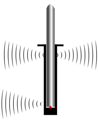

WHO IS THE WORST OFFENDER HERE?
Which would you guys say is the worst noise/rumble culprit in a conventional turntable bearing housing?
the ball bearing part *or* the bearing sleeve?
how would you describe (hypothetically) the "holy grail" bearing, if it could be made.
I've had a great idea for a bearing design but don't want to make a fool of myself by overlooking some obvious flaw in my design. would anyone be interested in knowing?
cheers
Eric
cheers
Eric
