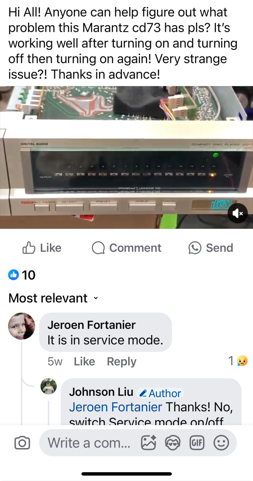

Hi all, My Marantz CD73 has a green leds display issue( The green LEDs keep looping, non-stopping during playing) , pls see below pics and video link on facebook. Any one knew this issue? Thanks in advance!

do the other buttons work normally.
Well, just tested it again. When leds looping, I pressed play then get everything normal, no more looping! And turned on/turned off , again and again , all ok! But, after turning off about 5min then turn it on and it’s looping again…. Sounds like caps issues, not sure which part of them? Power board’s caps have been fully changed, all voltages are ok .
When you press play , the player leave the service mode...

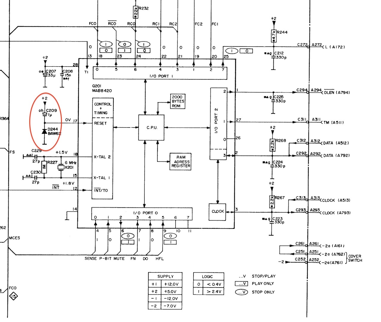

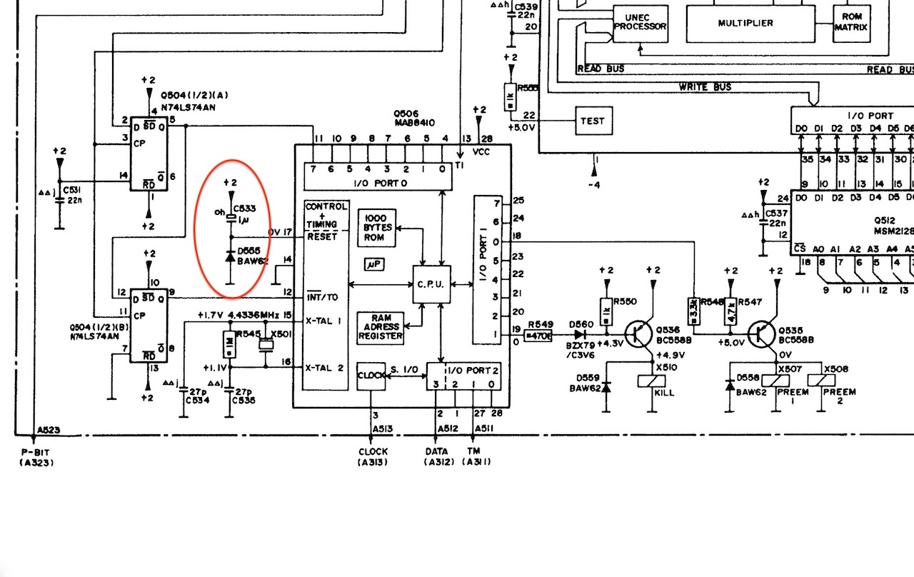

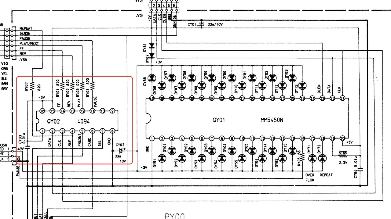

Check the Display board for broken solder joints , check the 4094 , replace the 33µf , could also be a problem with processors reset the 1µf .

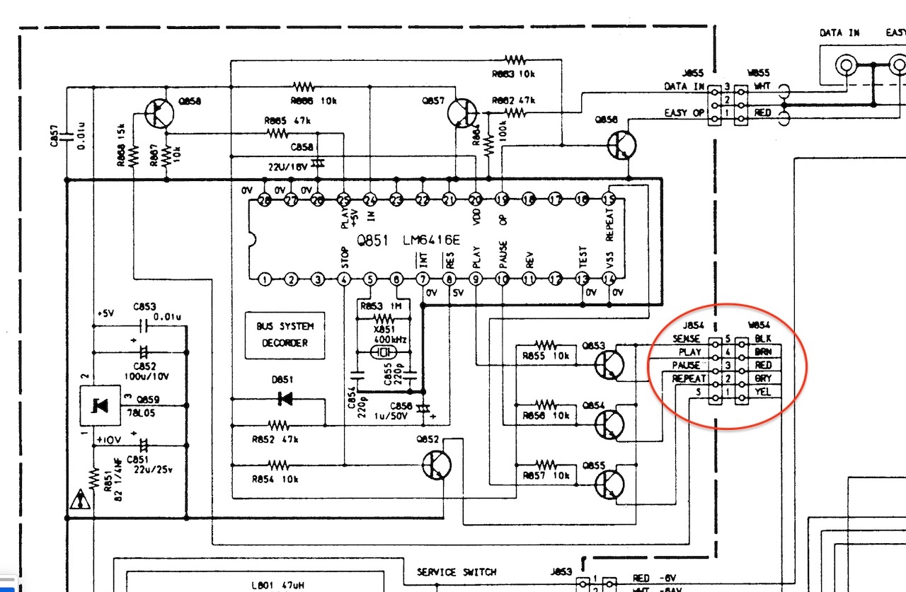

Advise check the capicitors on the audio and Servo board ;-)

Hi Bram, just finish the jobs, 2 caps of 1uf are ok and the 33uf is very low around 5uf ….exciting! After changed, unfortunately nothing happen! Sad again. I double checked its loops and found that if turned on it within 1min after normal playing, there are no loops . Due to this short time for normal working, so should not be cold soldering issue, still thought some small caps , also more like a chip issue? Thanks!
