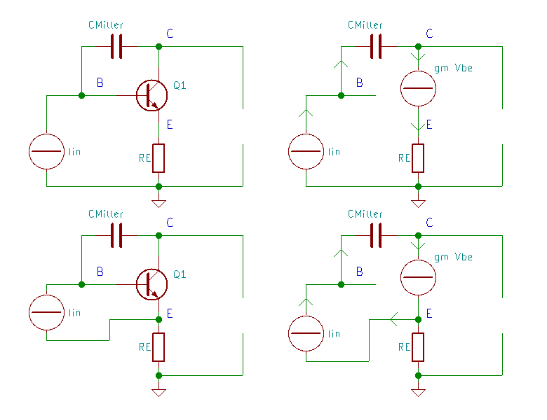

@Citizen124032 About the right half plane zero, at least when you look at the transimpedance with no load, model the transistor as an ideal voltage-controlled current source and the differential pair output as a current source, you indeed remove the emitter resistor from the equation when the other side of the current source is tied to the emitter.
Upper part: signal current Iin flows through the Miller compensation capacitor, collector, emitter and emitter resistor back to the source.
Signal voltage at the emitter: RE Iin
Signal voltage at the base: RE Iin + Iin/gm
Signal voltage at the collector: RE Iin + Iin/gm - Iin/(s CMiller)
Transfer function from the input current to the signal voltage at the collector:
RE + 1/gm - 1/(s CMiller) = ((RE + 1/gm) s CMiller - 1)/(s CMiller)
Numerator is zero at s = 1/((RE + 1/gm) CMiller)
Bottom part: signal current Iin flows through the Miller compensation capacitor, collector and emitter back to the source, but not through the emitter resistor.
Signal voltage at the emitter: 0
Signal voltage at the base: Iin/gm
Signal voltage at the collector: Iin/gm - Iin/(s CMiller)
1/gm - 1/(s CMiller) = ((1/gm) s CMiller - 1)/(s CMiller)
Numerator is zero at s = 1/((1/gm) CMiller)

Thanks MarcelvdG for supplying these equations.
You start with "model the transistor as an ideal voltage-controlled current source", but your reasoning is starting with "signal current Iin flows through"!
No problem, as this reasoning is clear enough. Hence my first remark "quasi-differential", where the tail of a differential stage is also left out of any equation.
So the open loop gain increases considerable but is less linear compared with the classical 'Re-included' version. But which one is more stable (DC, temperature) given the tropical location in Kenya?
In my calculations, for a given CMiller, the loop gain is essentially the same for both cases until the right-half-plane zero kicks in. At high frequencies, the right-half-plane zero inverts the polarity of the loop gain, making the amplifier less stable. That happens faster when you have an emitter resistor and conventionally connected first stage than with the unconventional connection from post #1 or with no emitter resistor at all.
I don't know what the purpose of the emitter resistor is. I thought it might have something to do with current limiting during clipping or improving the stability of the bias point, but neither makes sense when I look at the circuit.
In my calculations, for a given CMiller, the loop gain is essentially the same until the right-half-plane zero kicks in. At high frequencies, the right-half-plane zero inverts the polarity of the loop gain, making the amplifier less stable. That happens faster when you have an emitter resistor and conventionally connected first stage than with the unconventional connection from post #1 or with no emitter resistor at all.
"That happens faster when you have an emitter resistor..." Obvious, because that's the part in your equation: RE + 1/gm... versus 1/gm...
"...when you have an emitter resistor and conventionally connected first stage..." There are countless designs with this.
"...the unconventional connection from post #1..." First seen in the (extreme high slew rate) Harris HA2535 opamp mid eighties.
"...current limiting during clipping or improving the stability of the bias point..." The first is a bonus (if it works), the second counts for this stage as thermal drift is somewhat surpressed. Only two 1N4148's are drawn (class B) where four are needed, but without thermal compensation from the diodes it needs this emitter resistor at least.

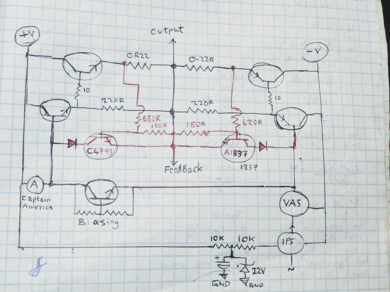

The two 220Ω resistors in the collectors of the drivers (2SC4793-2SA1837) are more curious, if not troublesome.
The quiescent current through the MTE350 is set by the negative supply voltage and the 4.7 kohm resistor, not by the emitter resistor.
Maybe it has something to do with giving the tail current of the differential pair and the collector current of the input transistor approximately the same dependence on the negative rail voltage to reduce offset and improve PSRR? If so, then replacing the collector resistor of the input transistor with a resistor in series with a diode should make it more effective.
"The quiescent current through the MTE350 is set by the negative supply voltage and the 4.7 kohm resistor, not by the emitter resistor." Mostly true, but stable in closed loop only.

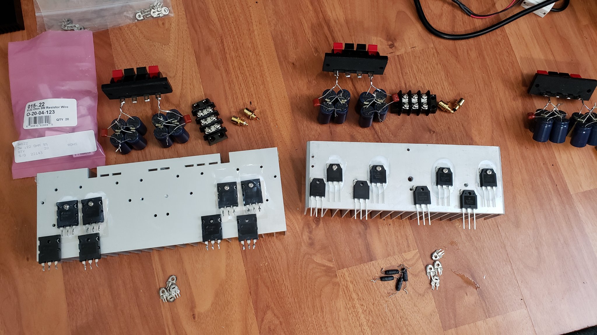

Hi @adason , I tried it with ±71 rails on 8ohms speaker. I used a 50v transformer Of course I added the bipolar dc protec cap at the output (from two polar caps).
I managed to run four pairs of outputs on the circuit. And two 12volts fans in a polygamous relationship with the heatsink.
I fed a bass signal from a car EQ and connected an 8R sub that I don't really care about.
The amp felt really powerful and couldn't even put the input signal voltage to it's max. In fact the sub started bottoming out and after a long while of contemplating I replaced with another bigger 8ohm sub that I really care for. In about 30mins, my place was flocked by about 7 or 8 local bass heads who demanded that I sell/make them a similar 'audio mill' 😂 . I know local audiophiles and ear doctors were not having it.
I measured the rails when the bass was dropping heavy. There was crazy sag, from 70v to 54 v , which I assume is from using just a single pair of 3300uf Caps at filtering (I should be ashamed 😖, had to sacrifice my two and only 10000uf 80v to speaker protection)
Haven't tested with a 4ohm load yet. Planning to do so after I've learned to build a decent amp, perhaps the badger
Major challenge facing the amp is the DC offset. It's very high at 80mV. Please advise on how to tame it on the circuit. Where can I add a trim pot and which value is best?

Hello good people,
I have a question and don't want to create a new thingie.
There's this amplifier that I was repairing (and stealing it's design and schematics). There's the transistors labeled c4793 and a1837 drawn in red.
They appear to be some sort of current limiting circuitry. If so, how effective or reliable is the design? ( @adason , @Citizen124032 )
