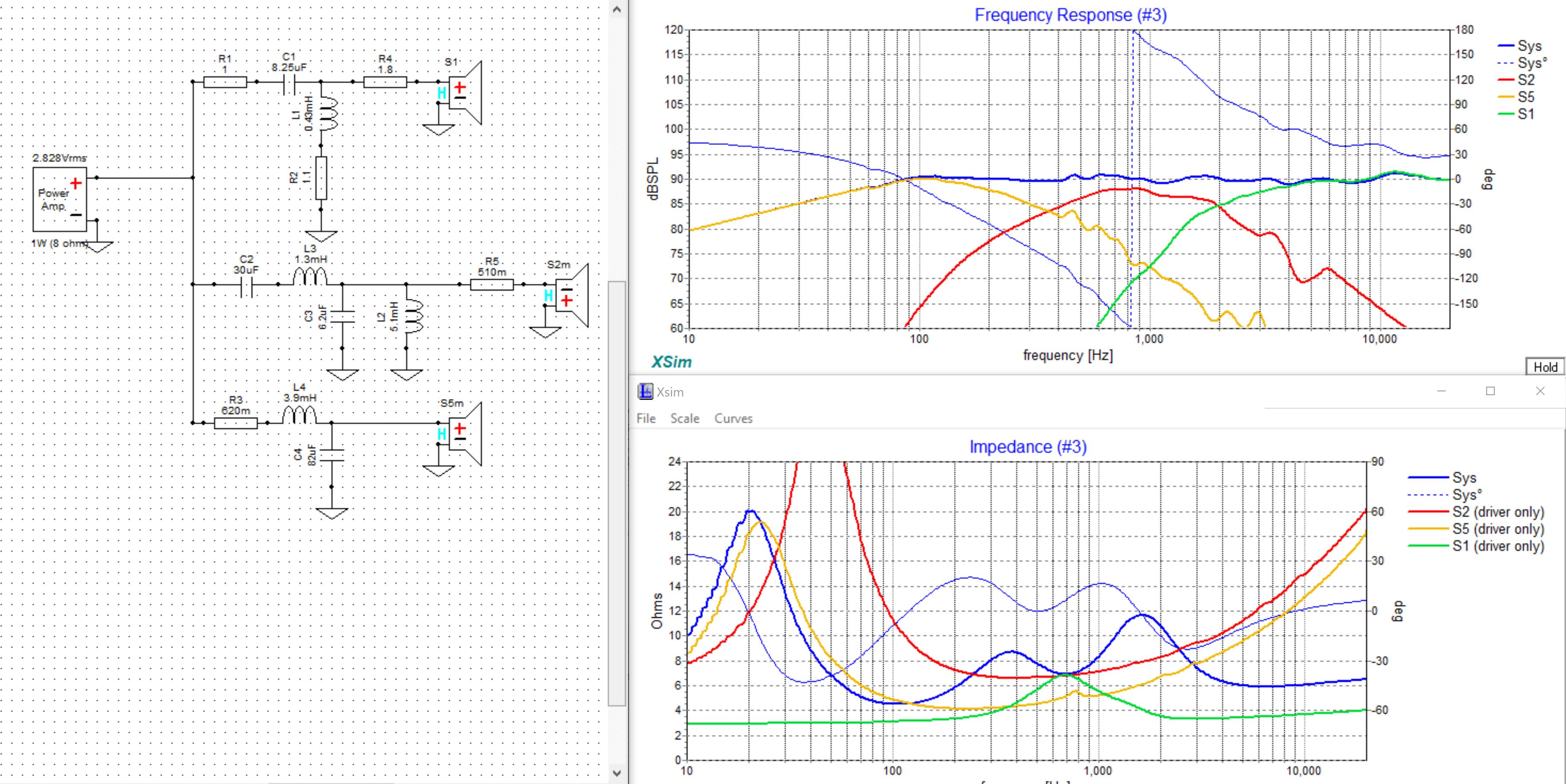

i thought it would be wrong also, so i did a little sim and saw that your FRD and ZMA files are wrong (especially the tweeter). So i did recreate them from specs and the dayton website and did a quick sim. included is the whole project...
Also which scanspeak tweeter is it? D or R?
waxx's impedance curve above seems dangerously low above 2Khz!! I found the R2604/8320 which does seem to have a very low impedance looking at the spec sheet, I wonder if the spec sheet is in fact correct?

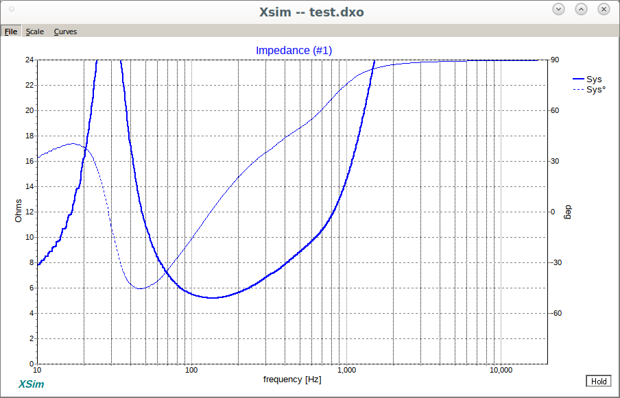

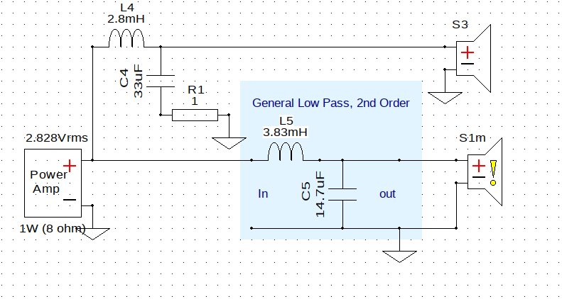

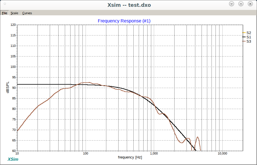

About the convenience of the 3.5 way architecture. When two woofers are used, it becomes possible to create a straight crossover/flat response using one of the woofers, and then to later lay the other woofer upon this using a single order rolloff around the baffle frequency. This later part could even be done by ear.
When simulating, it can help to set up a target response as shown below (S1m is the target here and S3 is the crossed driver. LR2@670Hz in this case, but this result is very close to several other rolloff options). This tends to reduce unexpected effects.

That is the point i wanted to make, that tweeter is on the published specs not fit for this. I think the specs are not right.
But to play it safe, i would chnage the tweeter to something that is more in line with logic and fits this system. Something like a Dayton Audio DSN25F-4 is not that expensive and will fit the system when crossed over at 3K

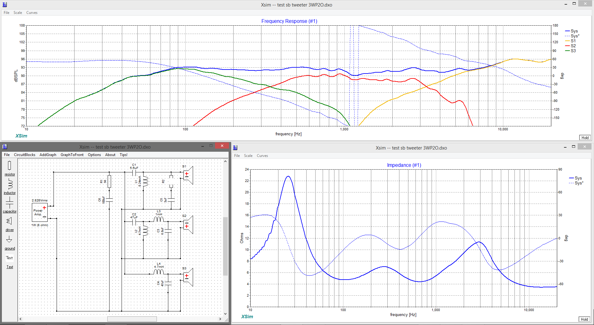

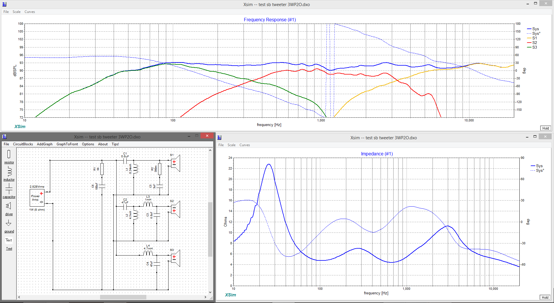

Thanks again Waxx and Tony. before I saw the recommendation I changed the tweeter and the mid-bass. So 3-way now
SB Accoustics SB29RDNC C000 4 (4ohm)
Dayton Audio RS150-8 (6") (8ohm)
Dayton Audio RS270P-4A (4ohm)
I got the frd and ZMA from Dayton and traced the SB Acoustics. (and checked this time they matched the spec sheet 😉
So xsim now looks like below.
The Impedence for the tweeter still looks low, but not sure if this is more to do with my crossover design. Thanks again to both of you for your help.
That looks a lot better, but i don't like those resistors in serie with the speakers, better replace those by an L-pad. If you send me the FRD and ZMA files of the tweeter, i can take a go at it to show how i would do it (the rest i have on my computer).
I know that this is theoretical until I buy the drivers and measure them on a test baffle, but essentially want to know if the three drivers I have chosen will work together. The xover design as a beginner to what is a fascinating obsession should be taken with more than a pinch of salt! I've lots to learn - so I really appreciate all the help I can get

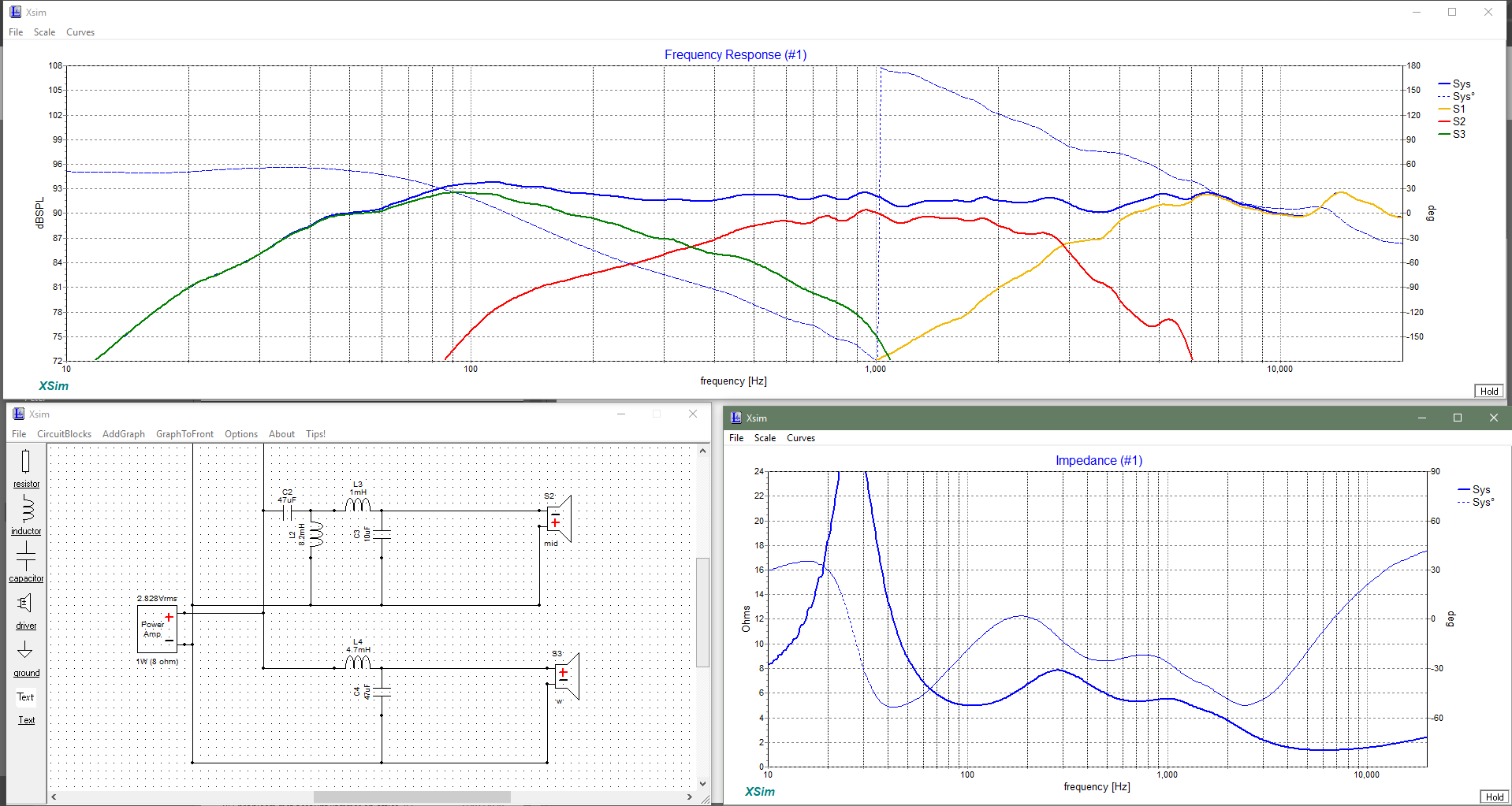

Not only for beginners, i like to design those and mess arround with it. And the more you try, the more you learn how it works.
This is my take, I did not replace the resistors with lpads, but with 2 zorbels, because that works better in this case.
