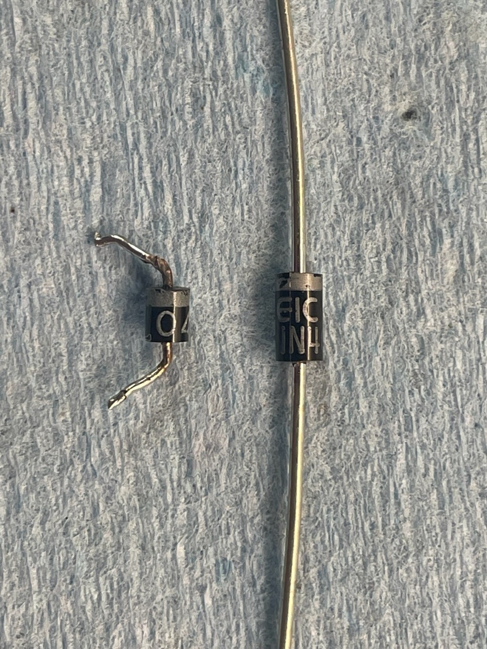

Hello identifying diode
The smaller diode has a 04 parallel to the cathode and 02 perpendicular to the cathode.
I put a 1n4002 in the photo for reference.
What is the smaller diode equivalent to? Thank you

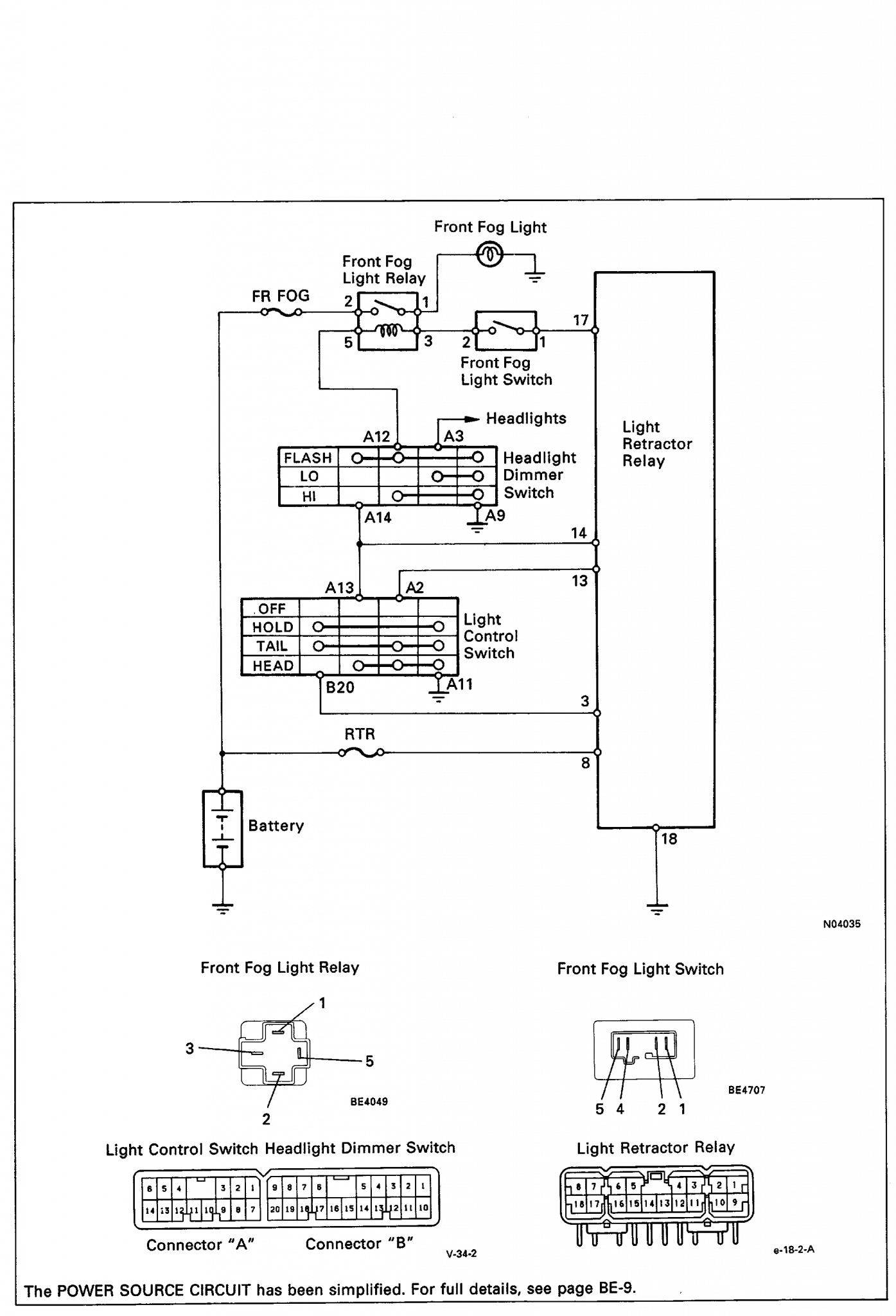

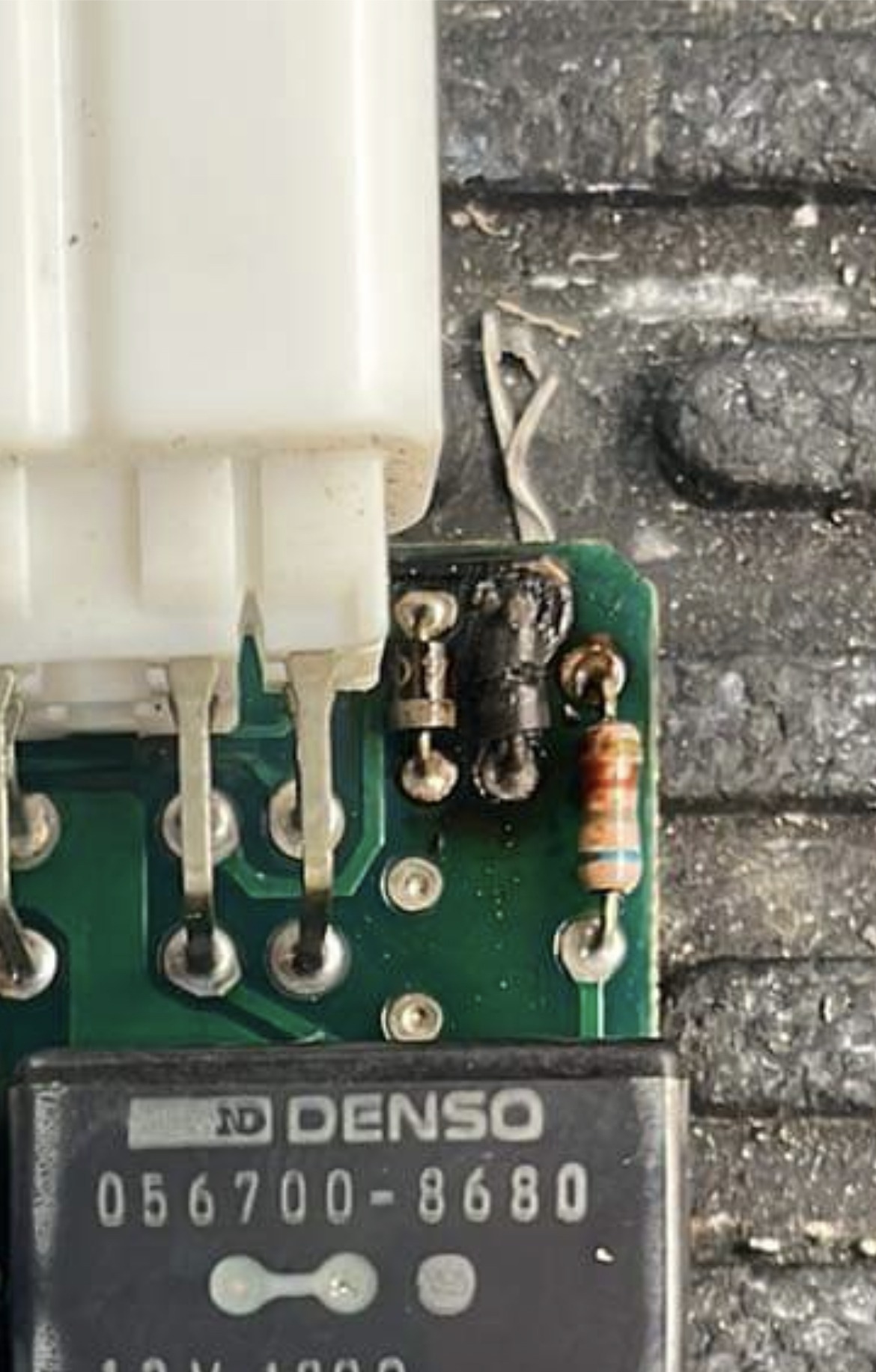

Its inside of the retractor relay box of this old car. The diode in question burned in half Cathode is Pin 14. Anode is pin 17. Nothing else is connected to these pins.
Looks like its used as part of a switch to activate the fog light relay, but only when the headlights are ON.
