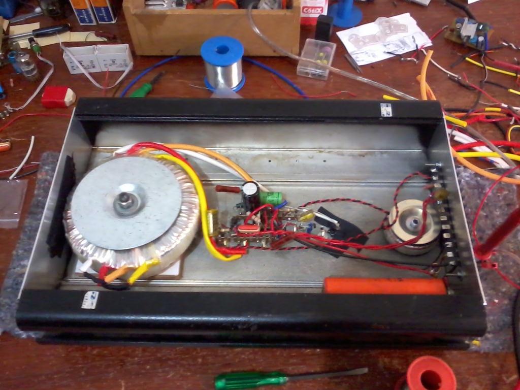

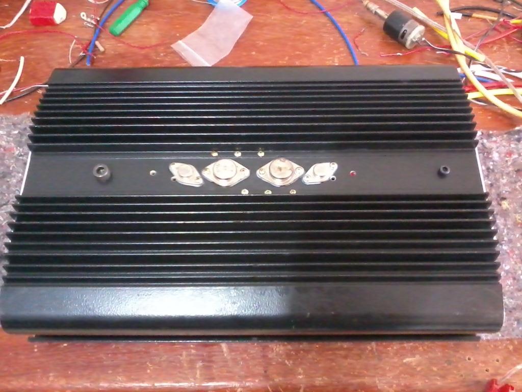

I built one of these with 2SD226 + 2N3055 in mono for my car subwoofer ("only" 50W in 4R, but as I do not want to go deaf, an my sub is reasonable efficient ...). I did the custom transformers, and only for bass use. They work from almost 10 Hz, with well balanced internal resistences from emmiter-to-emmiter, but are unstable to treble use. I used 1A/output transistor quiescent current, because this amplifier works in open loop, and to have some damping factor, it will have to come from somewhere, and this place would be through the transconductance of the output transistors (so it must be active with some quiescent current to have some transconductance). I modified my car radio internals to outputting sub in the rear AF out (I use midrange/treble at RCA out).

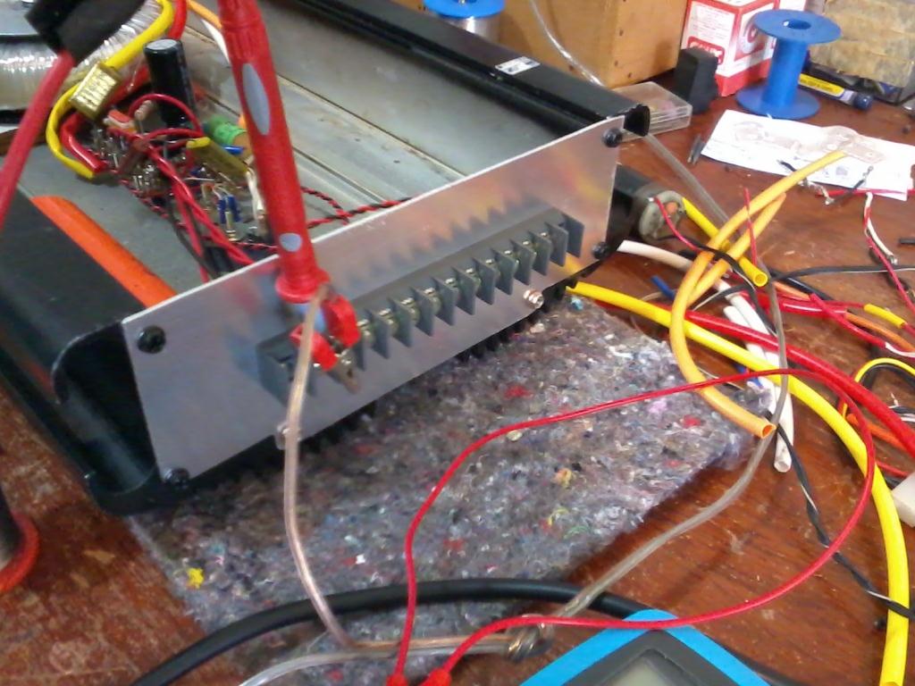

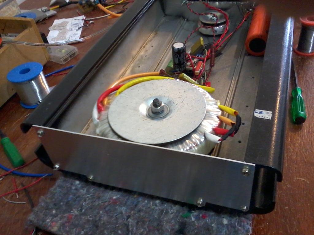

Some photos...
The output transformer is a custom #TL70223 from Toroid do Brasil, and the input trafo is a #TL70222 (both designed only for bass applications).
