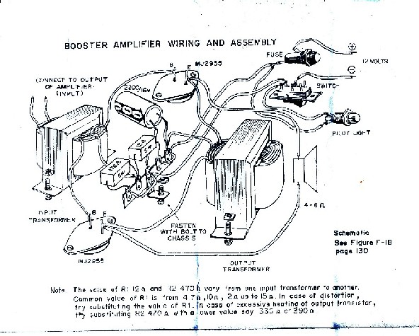

hello, how about this booster for amplifier
hello everyone, what can you tell about this booster? for me i love it. i dont know why bec. its realy good for low power amplifier... any comment should be appreciated.. tnxx....

Hi Denver,
I remember them , it was a hit in the 80's , I built one as well during those days and I was surprised how good it is considering using so few parts. I would like to build one again using newer transistor in place of the 2955 but I don't know if the transformer are still available.

I wonder why PNP transistors were used in the original when equivalent size NPN's are stronger and cheaper? It does use a single supply rail so that keeps things simple. In fact, it's not really that much different (conceptually at least) from the one that was here a year or so ago by someone named Susan, IIRC. Here it is.

IIRC, there are diffrent variation of similar circuit floating around from diffrent shops offering booster amp then where this came from. There are also NPN 2N3055's but I don't have any diagram of them now. May be Denver, have more to offer.

I remember this booster amplifier and it still on the market today ( here in the Philippines). I used to intall this booster with the ever popular Pioneer KP 500 car stereos with a couple Pioneer PT-6 tweeters on our king of the road, the jeepney's. There are 3 version of this booster, the 50W (the one that you posted) the 100W (with 4 outputput transistors and a bigger output transformer) the 150W ( with 6 output tranies running on a 24V dc supply) and I am wondering if they are really putting out that power. MJ2955 was used so you could mount it directly on the heatsink. I remember we used to assemble these on a C bar aluminum, then a handful of LED's, resistors, 1N4148's for a simple VU meter to go.

These were sold as assembly with a 6" X 9" (cheap) speaker in the early 70's. Man, they sounded really bad. They were very similar to your diagram, but I think NPN 3055's.
I can't believe the concept is still around. :rolleyes:

hi i will post here the diagram using 2N3055, i need to scan it again, i got those diagram on solid state book sell by the electronic shop here in my country...how about replacing the transistor? like MJ1004?

I feel you bro:D i would suggest putting a 1000uF 25V electrolytic cap on one of the "hot" output terminals of the bridge IC, so you would need 2 caps. one for each channel. this would provide dc isolation since both of your outputs are floating (not reference to ground) and this will also protect your power IC from poping out due to the very low impedance of the input transformer, if you use the 2N3055 version you wiill need mica insulators for your output trannies. I have also tried your setup ha ha ha, Its nice to look back where you got started and its good that someone remember this lowly booster amp, like them or not they are part of your audio history,just as the same as those Altec horns, amps, the VOT s etc. good luck on your projects and most important have fun and take pride on your projects :D

tnx alot for the info. and i tried also using the 2N3055 but my final is using the MJ because it attached directly to the ground or to the heatsink no need mica insulator, i forgot to scan the booster using 2N3055 and i have also a schematic using a parallel transistor for booster may be i post it tommorow..i like my work, it makes me happy when i power it, i dont know why somebody dont like booster, it easy to make and compatible for low amp. BTW, i have an amp with an ouput transistor of 2n3055 i need to supply it 35-0-35, so i need a transformer that have 25-0-25, but icant find here in my location (Vigan City), they sell only 12-0-12 6 ampere is this work fine for my amp?

don't be offended when our fellow diyers give their comments or perception about a certain project, they are only trying to help you, putting you in the right path. saves time and money by doing and going the right way, you see that booster to tell you the truth has a very high distortion and a battery hog. If you care about sound quality that booster wont qualify, have you ever heard a sound system where you can "see" the performers where they are placed on a stage? or
hear the singer draws a quick breath between the words of a song? or you can tell that the snare drum is treated with a reversed gate reverb by the engineer? well there is. You see the golden rule in designing an amp " straight wire with gain". Regarding your question about your amp,it will work but it may sound distorted and will not deliver the rated power on the specified load. You see amplifier output power (watts into 8 or 4 ohms) depends on the power supply, the higher the potential of your power supply the more powerful it is but of course this is per design. An amplifier designed for a +/-50 operation should not be operated higher than the recomended power supply. Your asking for trouble if you did.

This is exactly the unit I remember! No they did not work very well but they did function. I recall these things being hooked up to 8-Tracks and bad cassette radios. There wasn't much on the market so these things were in demand. I never did see the enhanced power versions.

I assume this is for car audio? Why not build a tiny gainclone as audiomachines advises? If I had the parts lying around for your circuit, I would make it anyway just to hear it again and laugh but if I was seriously looking for more power I would build something more practical and usable.
