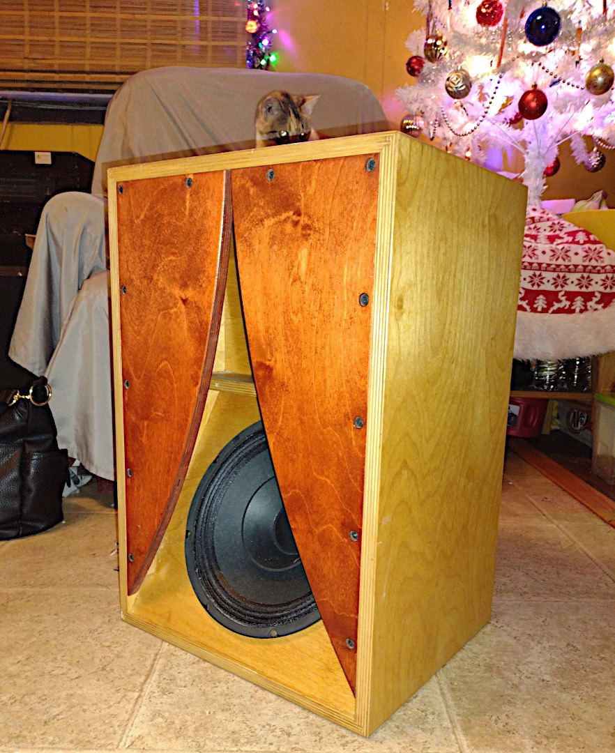

Why would you?Is it possible to reduce the box size by adding, like, Styrofoam ''peanuts'' or a pillow in the bottom of the speaker box ? Sand or gravel could work, but it's heavy and dirty !
Never tried myself, but hard foam like styrofoam should work. PET bottles fully filled with water are nice for experimenting.
Pillows are usually filled with polly wadding which acts like absorber, so not suitable.
Why do you want to reduce the volume?
Your box volume is a good match to Alpha 10A.
Did you close the port? In general, a closed enclosure sounds less boomy if it’s ‘too big’. And I think you’re listening to your room, less so your speaker.
The speakers box are a little boomy, probably because the volume is to big for the speaker ?
Alpha 10A Qts is little high, reducing the box volume won't help
Try this:
Move speakers 1-1,5ft away from rear wall
Cut the subwoofer lower: 70-80Hz
Add 1lbs polyester wadding in each box, for absorption.
Sorry for this, but are you sure tone controls on your amp are off
And markbakk may be right, this could be your room acoustics issue
Yes Davor D , yes my room have serious acoustics issue, but as a renter, I can't do anything. My room is to small to move my speakers away from the wall. :-( But It's not that bad, I can live with it.
Try to google "diy bass traps"
They can be very helpful in a small rooms and not so complicated or expensive to make
Bass traps are not as effective until you have a large amount of them. Multiple subs will offer active bass absorption while taking up much less space.

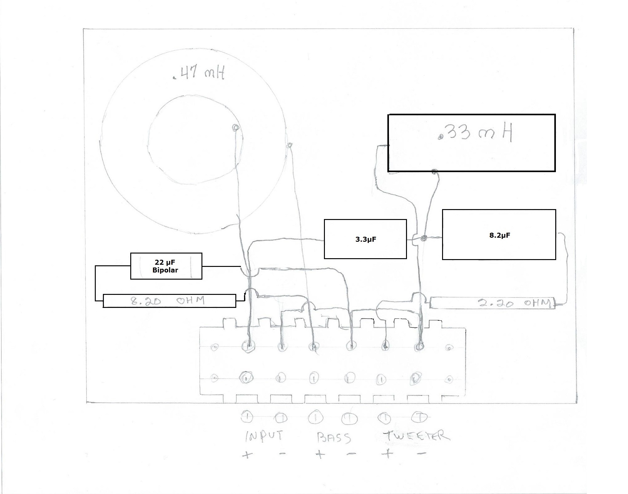

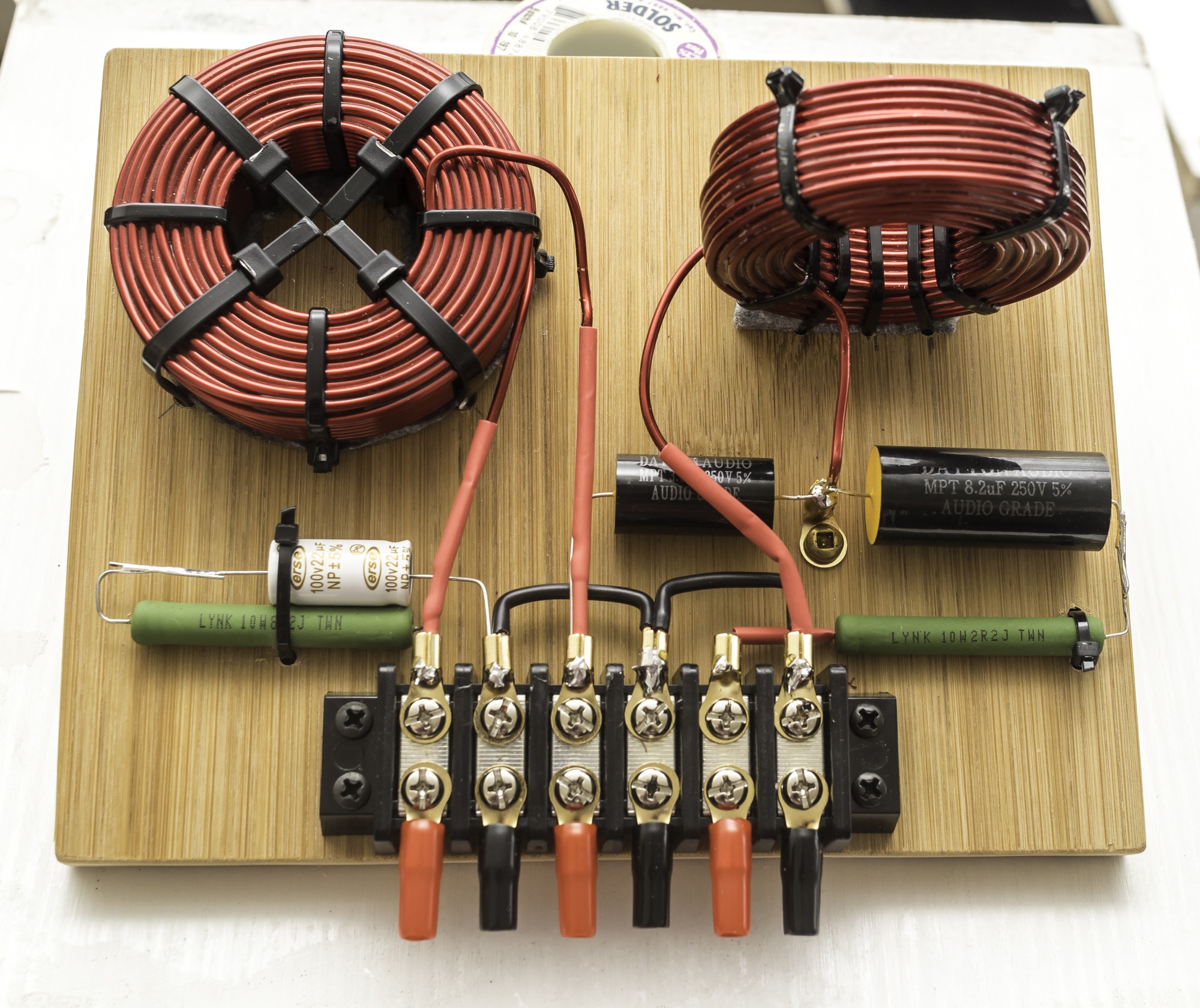

Indeed, the inductors are very low in resistance ...
0.47mH 12awg, 0.10ohms DCR, 19mm H x 76mm D (Solen.ca)
0.33mH 12awg, 0.07ohms DCR, 19mm H x 76mm D (Solen.ca)
- Hello folks, I need your opinion before I spend money for nothing
