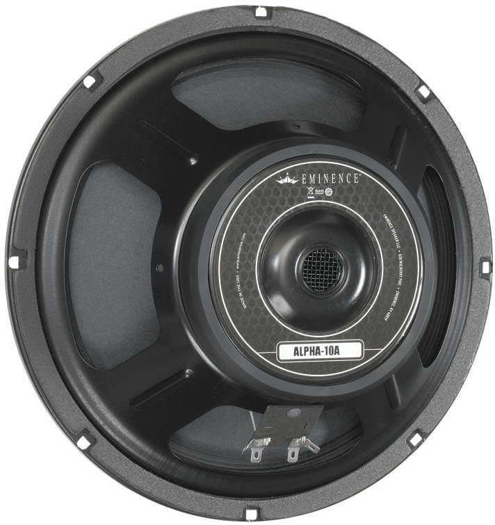

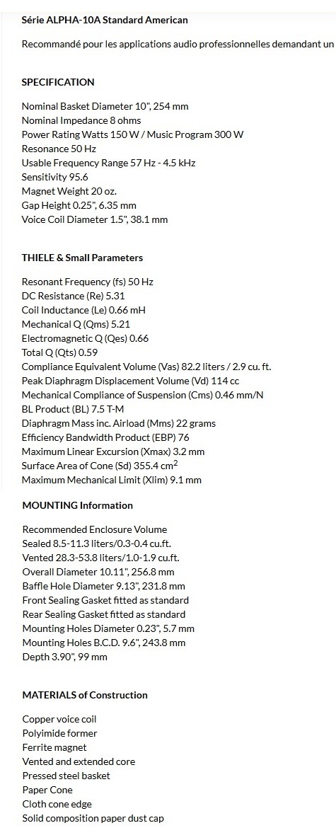

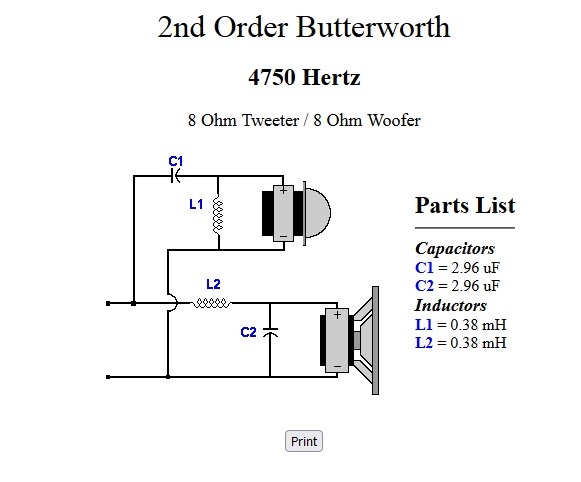

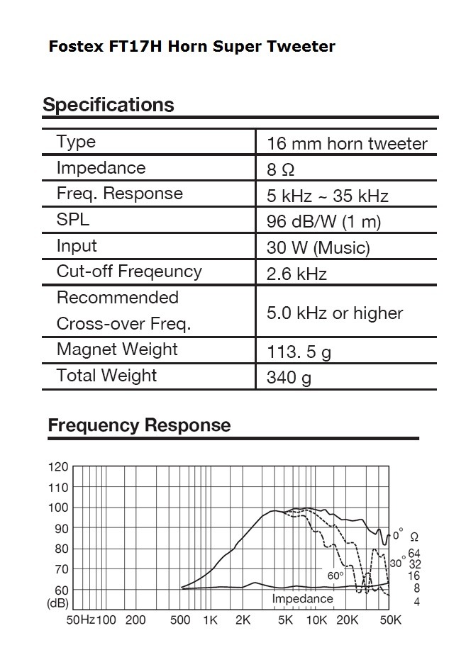

Both speakers are now in function 🙂 Davor D you made a good job with the personalize schematic you created for me (thank you so much), the balance between the super tweeter and the Mid/Bass woofer is right on. They are fun speakers for not much money, in fact the upgrade cost me about $400 for the two ''Eminence'' speakers and the crossover parts.
If you’re still working towards better bass, you may find benefits, lowering of peaks, by experimenting with different box fill/quantities/combinations.
Some materials are basic fiberglass insulation, closed cell foam, loosely rolled bubble wrap.
