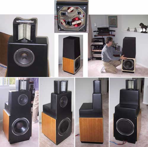

I have 4 ESS Monitors that the woofers are dying. I would like to redesign and use the Heils that are in good shape. What is a reasonable cross over frequency to use with these AMTs? I have experence and the equipment to test design and build speakers.
My buddy Chris turned a set of AMTs into a very nice 3-way. There were some restrictions on the design (had to use the original bass drivers & the newly redone grill cap. Used an Eminance 6" for mids. Worked out quite well.
Next one we do will use Audax PR17 as mid, and will probably be active to non-ESS bass units.
dave
