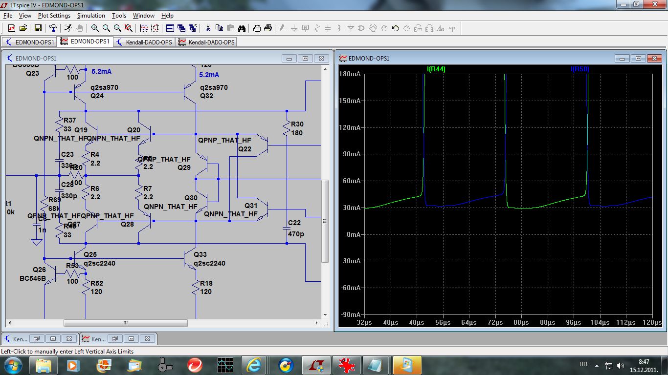

I tried to incorporate this(last) OPS with my input stage but I have problem with phase margin if OPS is init FB loop. I will post it in the new thread.

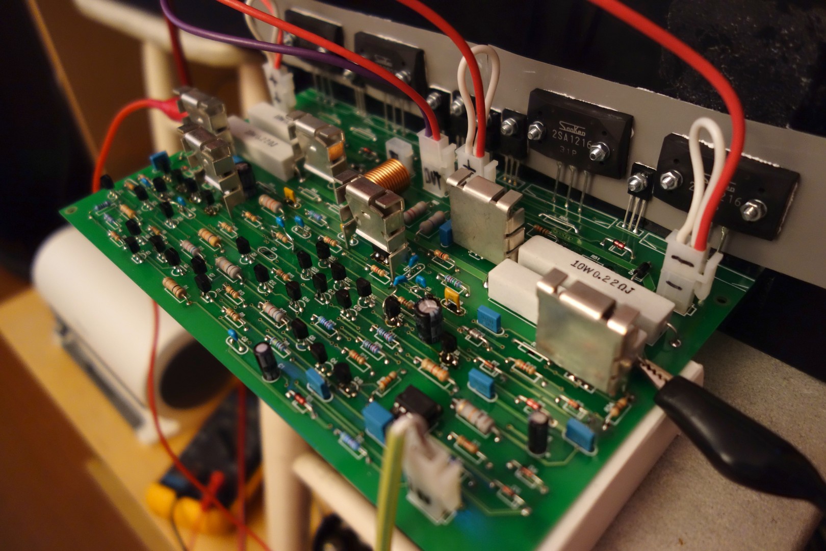

I am a little ashamed to admit that the testprobe is still on the pcb at the exact same spot as 2 years ago... So apart from a thick layer of dust there is no progress at all.
I would like to pick it up however.

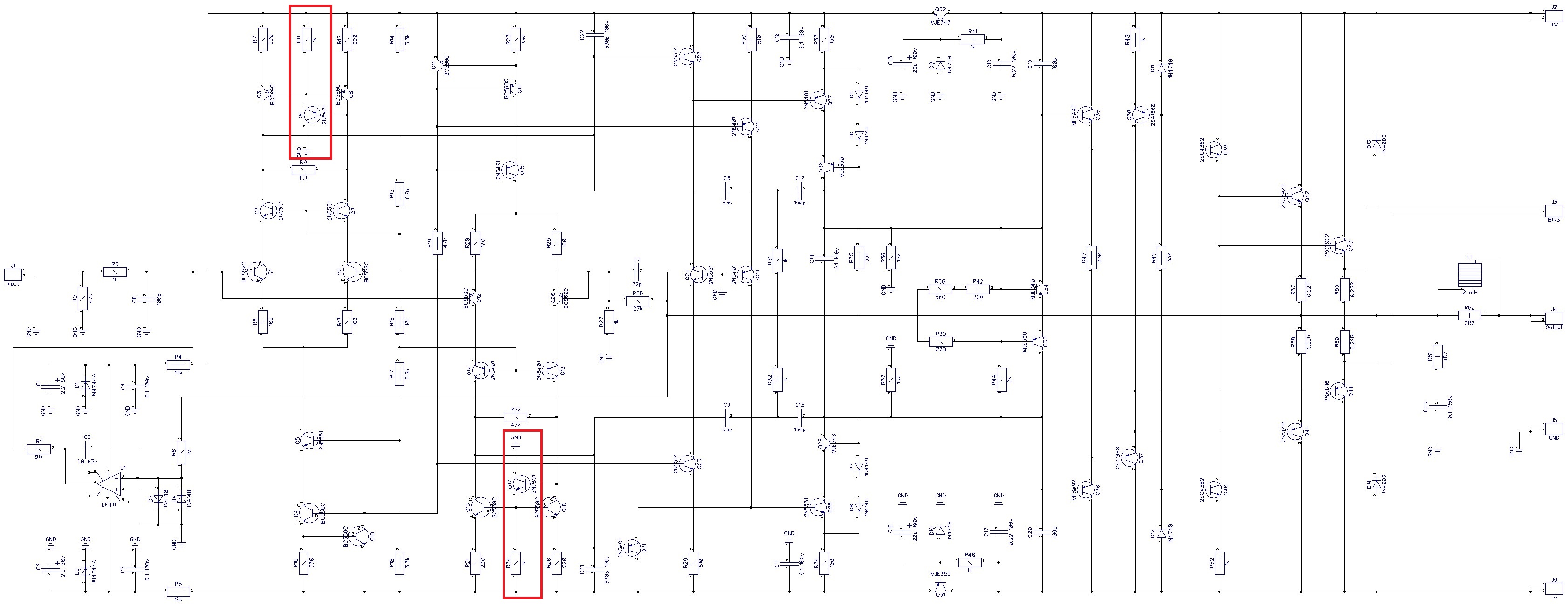

Yes, it is called CMCL. See the red boxes at the attached schematic - this is one of my "high speed" designs, works perfectly - balanced and stable. At the time I developed it Dave Zan pointed me to look closer at CMCL concept - helped a lot.
If somebody is interested - I've got a live prototype, PCB, etc.
Extremely low distortion. One of the specialties - class A drivers (CCS-loaded)...
Valery

Yes, it is called CMCL. See the red boxes at the attached schematic - this is one of my "high speed" designs, works perfectly - balanced and stable. At the time I developed it Dave Zan pointed me to look closer at CMCL concept - helped a lot...
The resistive load is not really a Common Mode Control Loop.
The CMCL specifically stabilizes the Common Mode, the resistors are less discriminate.
Nice to see it worked well for you.
Best wishes
David
