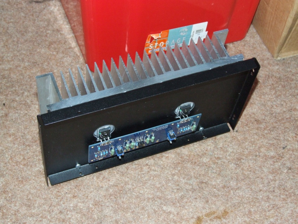

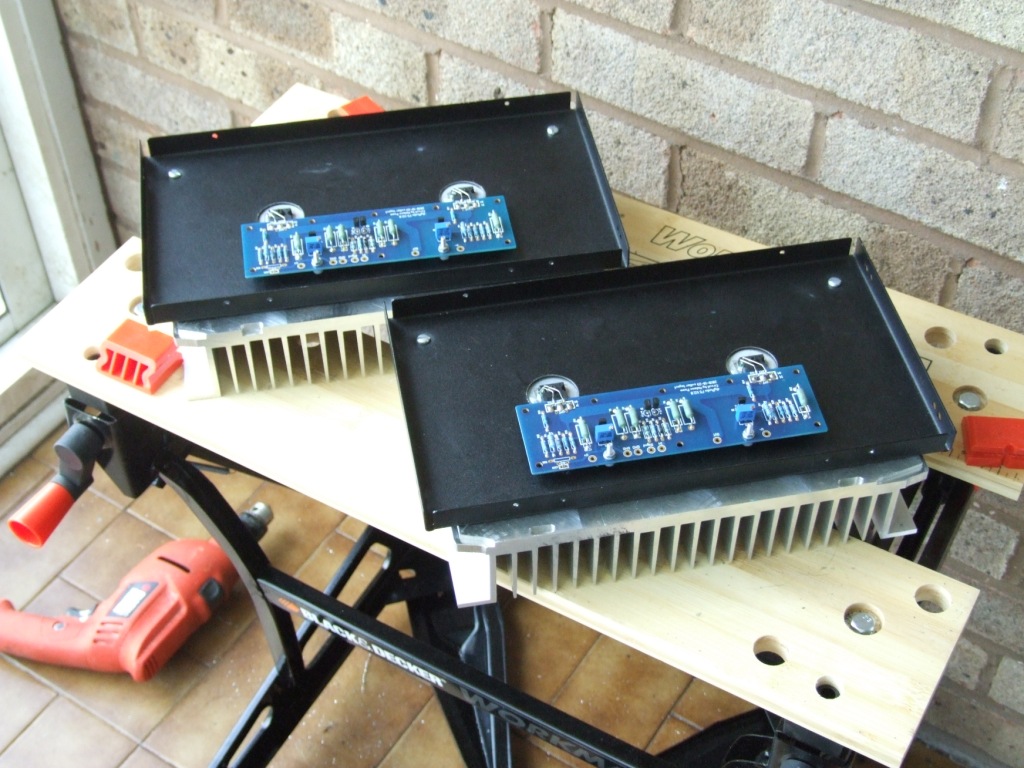

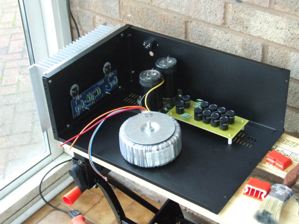

Only the other half to build now.
that should do it.... make certain you use either (1) mica + grease, or (2) kerafoil for best heat transfer between the MOSFET and heatsink.
Also "bond" the small thermistor "bead" to the MOSFET tab or on the heatsink, very close to the MOSFET. The bead must be able to closely track the temp of the MOSFET.
The heatsinks look a little "small-ish" for an F5, but hard to tell without a scale for reference. Just watch your bias and MOSFET temp as you start it up. You might want to start a Pass Labs forum thread on your build, if you are looking for comments from experienced F5 builders.
The heatsinks are approx 300mm wide x 180mm tall x 70mm fin height.
The black steel pressing you can see is the side cheek of a 4U 19" case.
QUOTE]
That's roughly the size of the Conrad heatsinks I used on my F5, so you should be in good shape. Just watch your bias and temps for the first hour or so, when you fire up your F5 and tweak the bias voltages.....
Good luck......
They should be adequate as this is only the HF amp in a tri-amp system.
If you ever doubt about cooling consider to get them anodized black.
This will help dissipation by some percent.
Thanks for thet, I had considered it.
I should be in a postion to power it up this weekend and see how hot it gets.

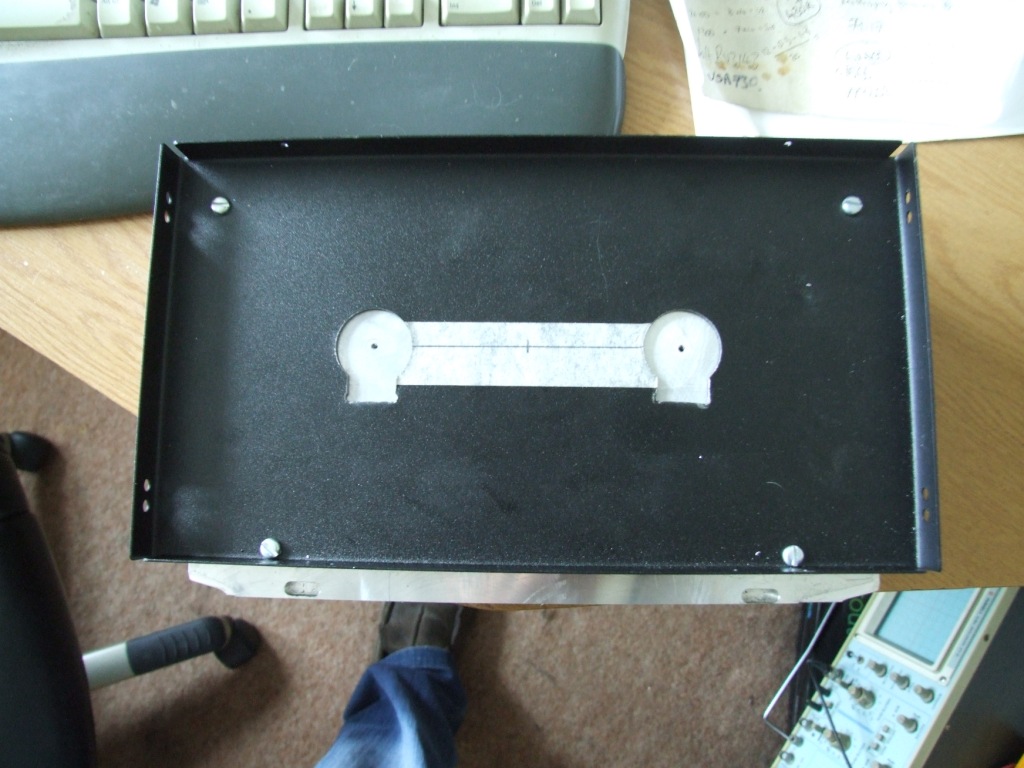

My question is - how will the steel reduce the effectiveness of the heat transfer ?
The real problem is not steel versus aluminum, it's the crossing between two layers which is the thermal resistance bottleneck.
Using two different materials merely adds to the thermal problem.
Aluminum has twice the thermal expansion factor of steel.
For a 10'' length and 30C temperature rise, difference in elongation would be about 1/100th of an inch.
That may seem very little, but the implication is that the aluminum heatsink and the steel chassis panel move with respect to eachother, in their contact plane.
Result is that there will always be a tiny air gap between the two, and stationary air is by far the best thermal insulator.

Funny, but when we want to improve thermal coupling between power semi's and a large heatsink area, we use thick COPPER bar stock as a heat spreader. Next best engineering practice is to "direct mount" the semi on the heatsink.
If you desire to use steel as a medium between a semi and a heatsink, please do. Please send pictures of the finished product, when you fire it up under load. ("Fire it up" is probably an accurate description)
I won't bore you with my background in physics and thermodynamics. Besides, I'm not going to sway your opinion, am I?
Good point. I have some copper plates here. Would you recommend to use them?
I have been thinking about the better "spead" of the heat and using the AL- heatsink
more effectively this way.
On the other hand I'd have another layer with one more "barrier".
