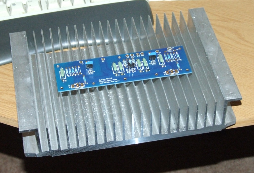

As I guess a lot of people have done, I'm building an amplifier into a steel chassis.
The amplifier in question is a Pass F5 so things are expected to get a bit warm.
Now, I've got two huge heatsinks which should dissipate the heat.
My question is - how will the steel reduce the effectiveness of the heat transfer ?
i.e. I'll have Tj -Cs - Steel - Heatsink.
I know that I'd be better cutting two huge holes in the steel to mount the MOS-FETs directly onto the heatsinks but is this really necessary?

Here is the almost complete F5 with it's heatsink - There are two of these.

Don't be diverted from protecting your junction temperature. Its an F5 you are building for goodness sake, not some relic with steel TO3's.
Every intervening material between junction and ambient adds 2 sets of thermal resistance. The wiser path is to minimise the thermal resistance. But I see your problem, its an ugly shaped heatsink to attach to the outside of a case, have you considered an alternative thats easier to mount?

I'd cut holes in the side of this steel chassis large enough to permit a very wide window, as much as 100% or better for the heatsink's rear side (assuming a flat back heatsink?).
The heatsink needs to have a clear path for airflow from below to above the fins, and (imho) an airpath on the back side as well.
The heatsink can easily be mounted using auxiliary hardware, parts as required. Whatever is required or usable.
You need fairly massive heatsinks for the F5.
Bigger if you go above the stock power rating of ~20watts per channel.
In general the cooler the devices can stay the better the thermal stability and the higher the SOA will be as well.
I'd mount the heatsinks, using the tabs already in the extrusion, by putting them on some
standoffs - physically float the heatsink off the chassis so there is easy airflow.
How about some pix of the chassis??

Getting competitive performance through a steel chassis is harder than making some holes in it.
Yep...that's why you do NOT want to sandwich a steel chassis between a semiconductor and it's heatsink. Q.E.D.....
Katie: Can you show us pics of the heat sinks and the steel chassis you intend to use, so we can offer some practical suggestions?
