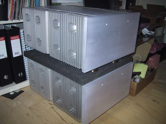

We are in the same boat, Terry😀 Just finished the mechanical work on mine. I did mount all the hardware also, so only the connections are missing. Take a look at these monstrous things🙂I am within striking distance now of having my Aleph-X's finished
Steen😎

steenoe said:We are in the same boat, Terry😀 Just finished the mechanical work on mine. I did mount all the hardware also, so only the connections are missing. Take a look at these monstrous things🙂
Steen😎
Hello Steen, those look good for about 120 Watts Class A each in Mono config, is that about right?

Thats about right, Anthony. I go for 2x100 watt's, biased as hard as my wall-outlet will permit😀 I am getting tired, dragging those amps around😉 My back is starting to hurt🙂 Hope to finish them soon. I have to admit that the A-x's isnt excactly the easiest amp I have builtHello Steen, those look good for about 120 Watts Class A each in Mono config, is that about right?
