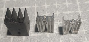

I got pretty stuck on this.
Managed to calculate the power dissipation in the circuit and came to a thermal resistance figure (C/W).
Now wtf to do with the C/W unit?
Isn't there some practical way to estimate heatsink dimensions by the power dissipation?
F.ex.
Here are some heatsinks at home:
25 х16.5 х16 mm - black one
20.5 х15 х10.5 mm - mid
20 х14.5 х9.5 mm - leftmost
Would the black one handle 4W and how much the smaller ones would handle?
Another one - 50 x124 x35 mm
How much power dissipation for this one?
Regards - Emil 🙂
Regards - Emil 🙂

Can't find a matching heatsink size/shape in catalogs (up till now).
I am amazed about the big one on the diagram - w 124, h 35, L 50 mm, base thickness 5 mm.
Tought it is a standard size and some manufacturer will have it in catalog with data.
Don't have it, plan to buy it. Intuitively feel it might be the right size.
Wondering if the extrusion length is 50 or better 70 mm, which would affect the enclosure design.
I tend to go for the slimmer, but wanted to verify somehow that it is ok for 19w dissipation (LM1875 power amp, mono), but it is extremely obscure to do so 🙁

I got some formulas for calculating heatsing to ambient thermal resistance, but I am getting it wrong, depend on where I start from.
One result for heatsink area (just the fins, two sided) if I start with the power dissipation, and completely different, if I start with the area and come up to the max power dissipated...
Dt = 150 (junction max)-50 (ambient) = 100C
Pd (power dissipated) = 19 W
Rs (thermal resistance to dissipate) = Dt/ Pd = 100/19 = 5,263 C/W
Rcj (case to junction) = 2 C/W (lm1875)
Rcs = 1,6 C/W (thermal pad)
Rs (heatsink needed) = 5,263 - 2 - 1,6 = 1,663 C/W
Rb (heatsink base plate thickness) = 5 mm (0,005m)
thermal conductivity Aluminum = 205 W/m·K
S area = 205/(1,663 * 0,005) = 24654mm2 (246,5cm2)
S area = 600cm2 (0,06m)
Natural convection heat transfer = 10
Rsb = Rb / (205 * 0,06) = 0,05/ 12,3 = 0,00040650 C/W (unsignificant)
Rsink = 1/ 10 * 0,06 = 1,666
Rtot = 1,666 + 1,6 ( MICA thermal pad) + 2(R jc) = 5,27 C/W
Pd = Dt/ Rtot = 100/5,27 = 18,98 W
