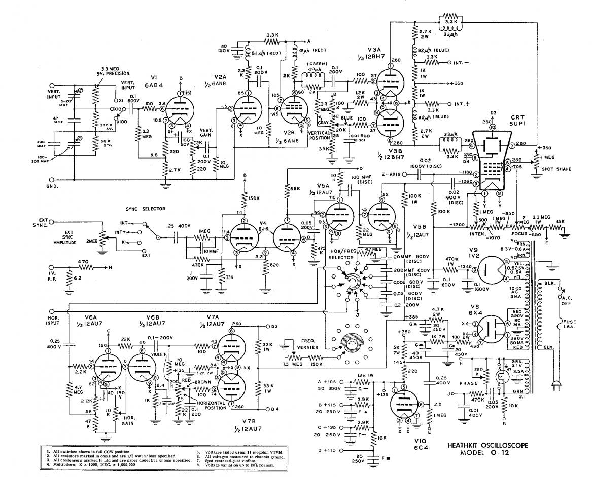

I got the tube today, plugged it in. Eureka.

Here it is, connected to its own 1v 60hz output. Having the manual was pretty helpful, as there a few procedures to get it running properly.
You can see it was pretty dirty before I cleaned it a bit and recapped it. The alcohol was taking the screen printing off the top of the board so I quit cleaning it. The worst of it was on the underside, which had a ton of old flux all over the place.
The worst filth was "gunk" inside each of the tube sockets, also covering the bottom of the tubes. I swear it looked like the original owner dipped the pins in flux paste!?! (not pictured)
