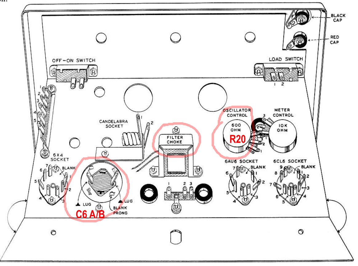

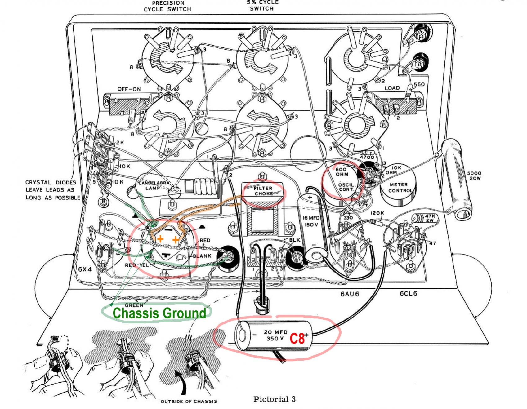

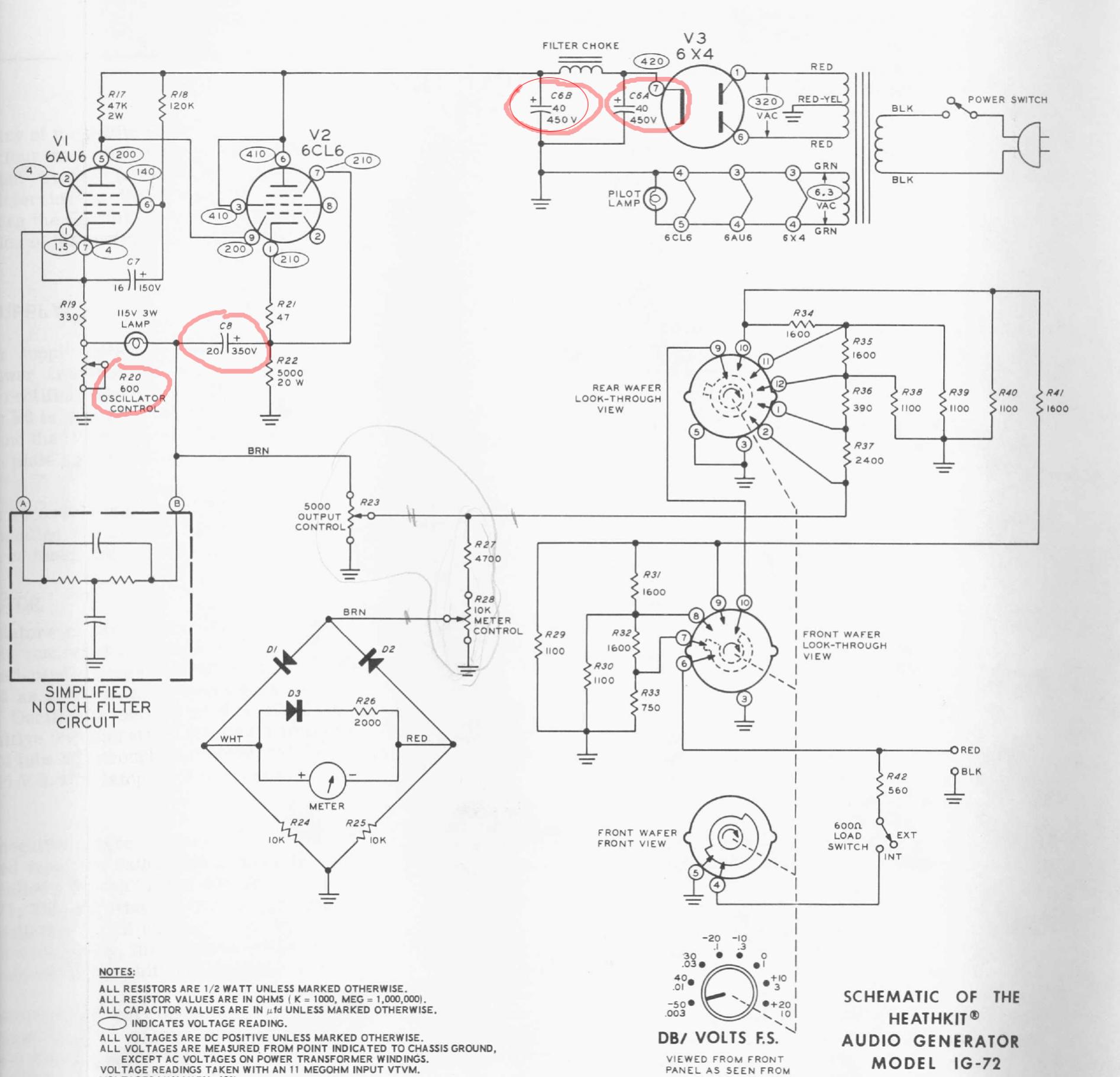

Heathkit audio generator producing bad signal or clipping, where to start?
Hi SoaDMTGguy,
I did cercle around the items you are searching for.
1) The Dual capacitor C6 A/B is plugged on each side of the choke, its 2 capacitors in one aluminium cylinder, simple to replace with 2 * 40uF 450Volts
2) The C8 is a single capacitor between 2 resistors 47 Ω and 5KΩ and the lamp
to replace with a 20uF 350Volts
3) R20 is a pot fixed on the chassis...
Take a look at the pictures ...
