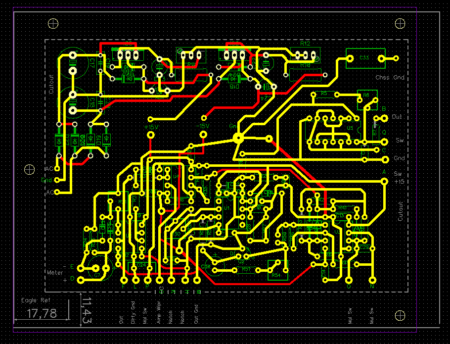

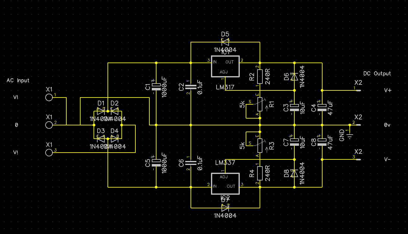

Ok , so I tried to draft a PCB using the base Eagle board that Tronola hosts on the website. I tried to replace the old PS section with a more modern one pilfered somewhere on the net (I used only the schematic and edited in DipTrace), that uses the LM317T and LM337T (both high voltage versions so they accept the rather high voltage coming from the trafo). I also rerouted all top traces so that they should work as an actual layer and not as a simple guide to add top patch wires.
As it is quite late , I will just post gerber and diptrace file... i am NOT able to redraft the board using 1206 SMD, I'd love it if some good soul would like to do so. As it is now, I'm posting this not as a working board rather to have more knowledgeable people than me take a look and possibly help me debug it and improve it so that a final version can be made and have it available for the Heathkit 18 / 5218 audio generator fans.
Tell me if I made horrible mistakes, and how to correct them!!
Franco
Franco
Forgot to add, since the LM317/337 combo is actually a adjustable PS, I made a jumper pad for +15 -15 rails so that it's easy to adj the voltage before connecting the osc circuit part.
You can eliminate any presence of 60/120/180 Hz hum by using a simple DC-DC converter from Murata etc, and post-filtering with low noise regulators.
Audio Precision modified some of their SYS2722 Analyzers power supply by putting the transformer exterior to the chassis.
And here's the latest revision. Hopefully I managed to edge out the worsy problems. I also dowloaded the free version of Eagle (jeeeez it's really HARD to learn that.).
So I've exported it in Eagle .brd, maybe more perople can take a look at it this way.

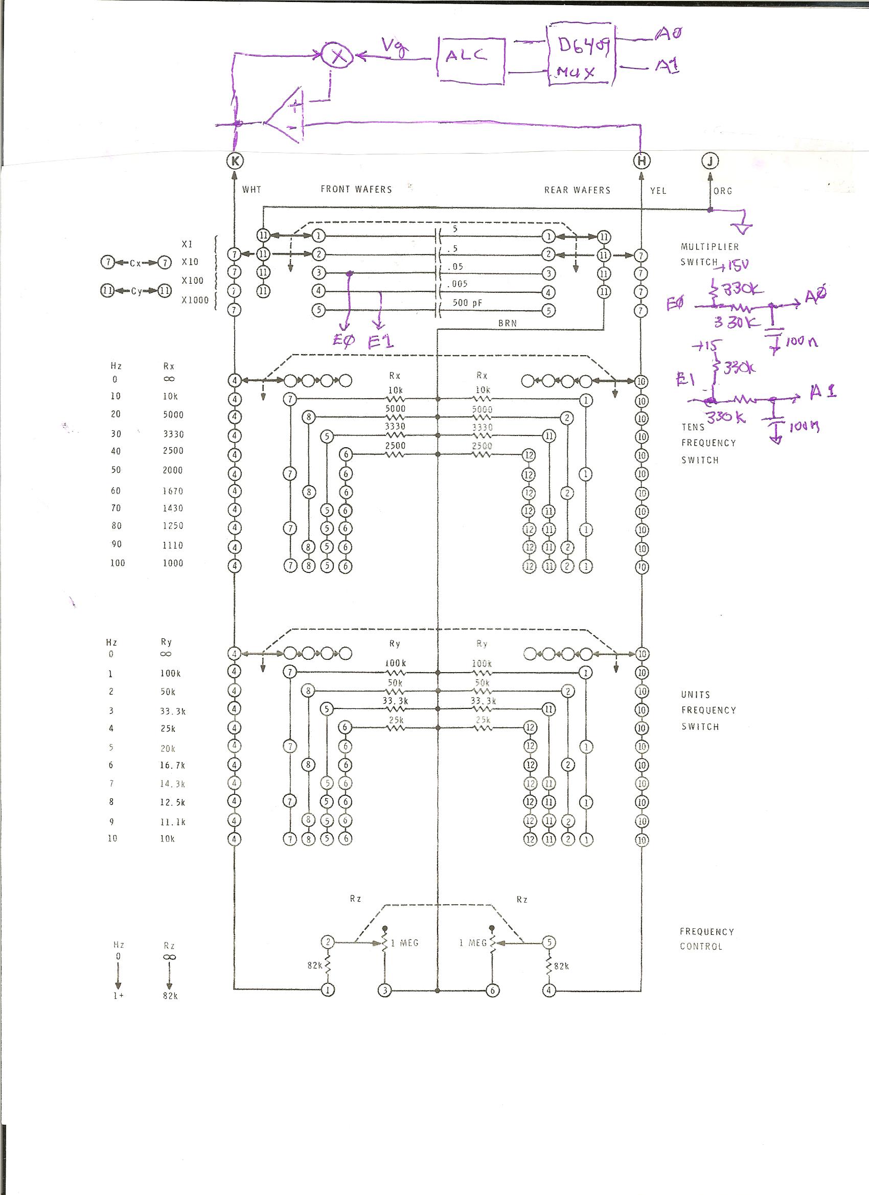

It appears to me that one of the major pains in modifying the IG-18 to use HP339 oscillator architecture is the need for additional wafer switch sections in the decade range switch. This is especially the case in the Moore version having capacitor ratio of 10 (rather than 100 in HP design)--- the existing decade range switch would suffice with two more poles to accommodate the added AGC range switching.
Please see switch sections S1B and S1E, Schematic Page 1 of Steve Lafferty Modifications: Modifications: Heathkit IG-18 Audio Generator I suggest these two functions can be accommodated by a dual 1 of 4 analog mux, https://www.vishay.com/docs/70062/dg408.pdf The sketch below details how the address selection of the mux can be derived from the existing decade range switch. All that follows deserves critical scrutiny, as it is pure paper musing.
The sketch depicts the active stage of the oscillator as a mental aid. Two points (E0 and E1) within the range switch are selected for position sensing: I believe both points switch to either Ground, to Oscillator Output (having average of 0V), or open circuit. Each of the sense lines is conditioned with a light pull-up to +15V and a low-pass filter to suppress the sine waves at the oscillator output. Thus, each mux address pin is presented with either 0 or +15V; I believe the range switch exercises the address bits through all 4 binary states and I believe sensitive capacitor nodes are well isolated from the mux by the pull-up/LPF networks.
This idea probably has little value if the HP design with 100 cap ratio is preferred.
Thoughts?
Thoughts?
Hello BSST,
it actually makes a lot of sense, and i have indeed been reading with attention Lafferty's website in regards to the IG18. Sticking to the 10x ratio does make things simple, and Dick also noted that using an order of magnitude more for the ratio could give debatable practical advantages anyway...
Implementing it may not be exactly easy, though.
I have to study, I am not so competent - but that is the direction I want to ultimately go. Ideally I wanted to take steps, maybe implement this idea using the original IG18 rotary switch and using solid state switching for the AGC range; then, the final goal is to convert the board to full SMD (moving the PS to a separate board placed where the original sits).
For now thank you for your help and suggestions!
Franco
Franco
