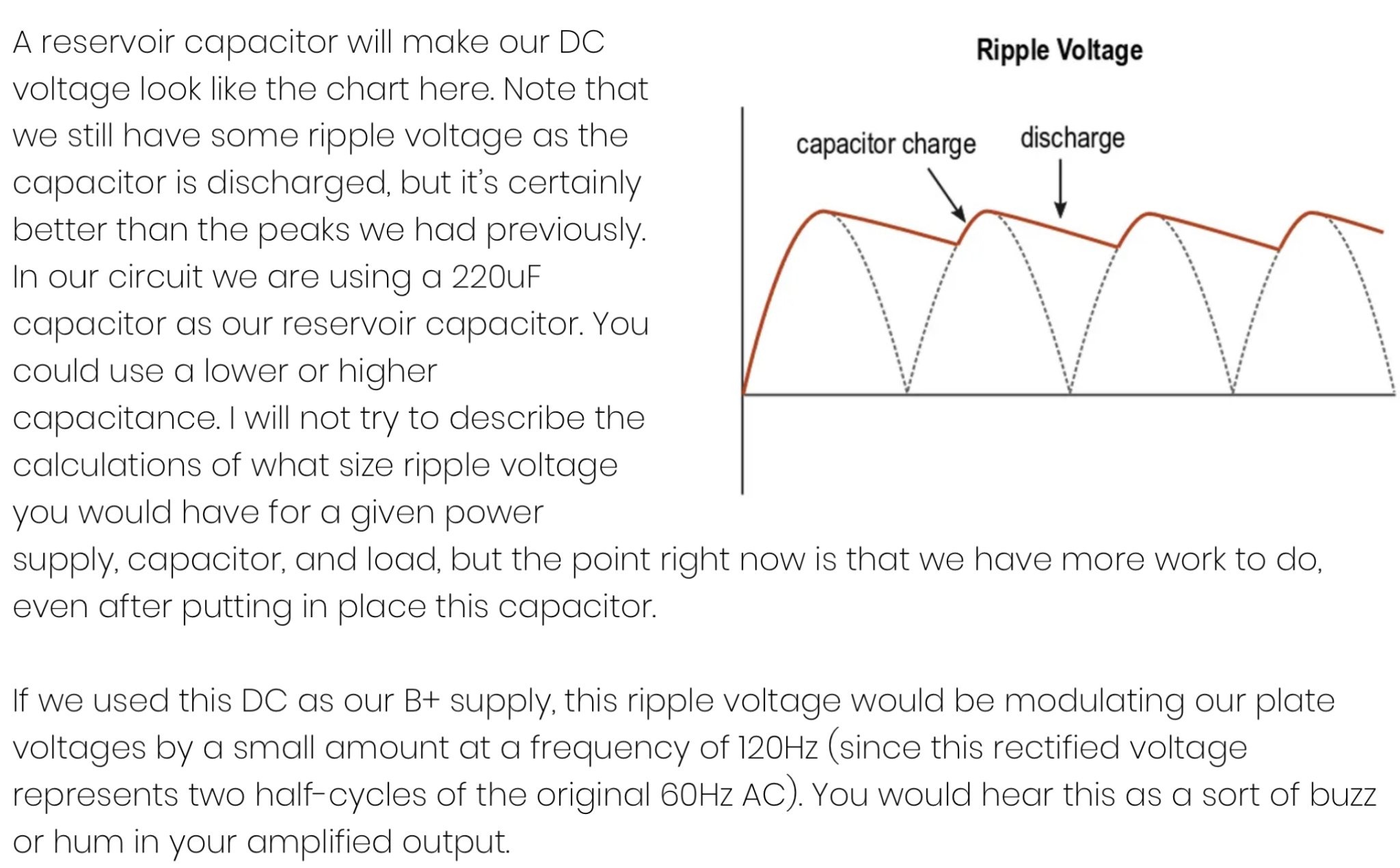

All that aside, I was reading about power supply design (here: https://www.analogethos.com/post/power-supply) and he mentions 120 hz ripple from the earlier stages of the PS.
The 300b DHT filaments are fed from independent AC windings on the transformer, so it makes sense the 120 Hz hum should be coming from the driver section - but those are AC filaments too - or earlier, out of the power supply.
I have replacements for those and figure after 20 years (the amp is at least this old) maybe recapping the PS is in order.

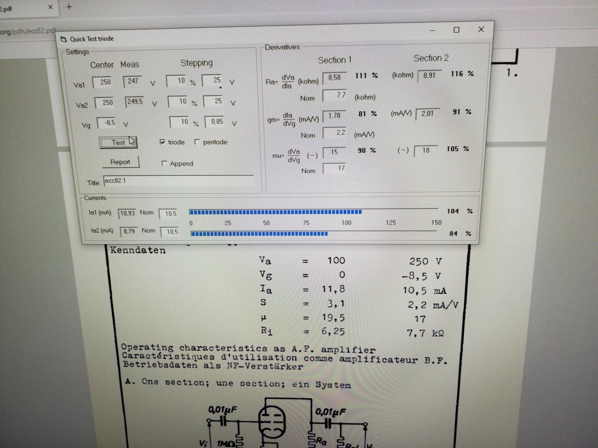

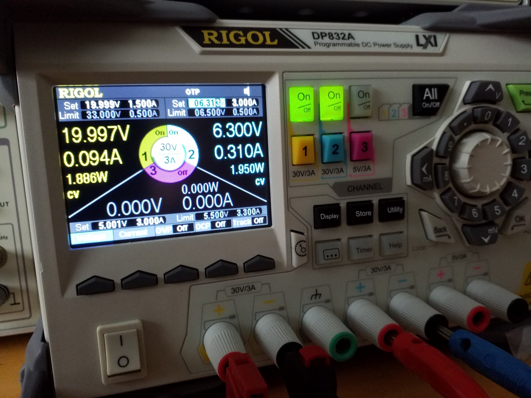

Okay I did some test.
This setup is telefunken ecc82, set up according to datasheet.
I started with adjusting to current, which yielded lover volt.
First photo 300ma
Second the actual quick test, I gave it 2 minutes warm up time.
Third picture, setting to 6.3 volt, with increased current.
Fourth. the test again , showing marginally better specs.
Ps. The rigol is tested and very close to spot on.
I also have a chicken stick to drain the old ones; if the bleeder resistor is cooked or just doesn’t work.
There IS no “bleeder resistor” in that circuit.
Replacing the PS caps didn’t take the 120 Hz hum off the amp output.
How the heck is it getting onto the 300b PTs anyway? Those things get AC from the trafo, not the PS. Even the 6SN7 heaters are AC off the trafo.
