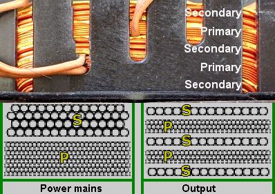

You see, when I wind a transformer I do a style called interleave. Let me show you a picture:
The top photo is an output transformer with the layers separated with Mylar laminated paper (PMP) for approx 2Kv insulation (4layers). 800V Hi pot tested
But I'm thinking of trying this new stuff that higher temp, approx10Kv/ layer (DMD) and go down to 2-3 layers.
Bottom Left shows the winding layout for a typical power supply, This is a power transformer.
Bottom Left show the typical interleave wound output transformer. This is a signal transformer.
I guess if they build with a power transformer style, I could see it having issues later that way.

I was just stating that I hi pot test my output transformers at 800V that I make. Most only test theirs to 500V.Also output transformers may have well in excess of an 800V working voltage, and require something like 2-3kV hipot testing.

I gave been building and repairing guitar and HiFi amps for a long time. Much of that time was spent in the heat and humidity of South Florida. Most of the power and output transformers made in the tube era used paper for the insulating layers. Some are still built this way today due to its low dielectric constant which reduces the parasitic capacitance. Paper will eventually absorb some moisture. It is not uncommon to find an old OPT with a measurable leakage between the primary and secondary. In my past work I have run across two OPT's with a direct short between the primary and secondary windings. Both were in commercially built guitar amps and both resulted in an inoperative amp BECAUSE the secondary was grounded, resulting in a blown fuse or fried rectifier tube.I would come up with some other way. Never had transformer failures. Never heard of center tapped balanced used for grounding, just phantom power and that is always been a non referenced to ground.
More recently there have been two BRAND NEW Hammond power transformers discovered here on diyAudio that had a direct short between the 6.3 volt heater winding and the 5.0 volt heater winding. If this kind of short can occur in a brand new Hammond power transformer, it can also occur in a Hammond OPT, though I have never seen one.
Leaving the speaker winding floating does present a possibility for a shock hazard to a user, especially in a guitar amp situation where 1/4 inch jacks are often used for both the guitar and speaker connections. There is no reason NOT to ground one side of the OPT secondary (or a tap) except for a few extra pF in stray capacitance to ground reflected on the primary. Everything I build will have a path from the speaker circuit to ground capable of blowing the fuse or otherwise shutting down the amp should a short occur. Note that some push pull amps that use balanced GNFB ground the 4 ohm tap in a 0-4-8-16 ohm secondary.
