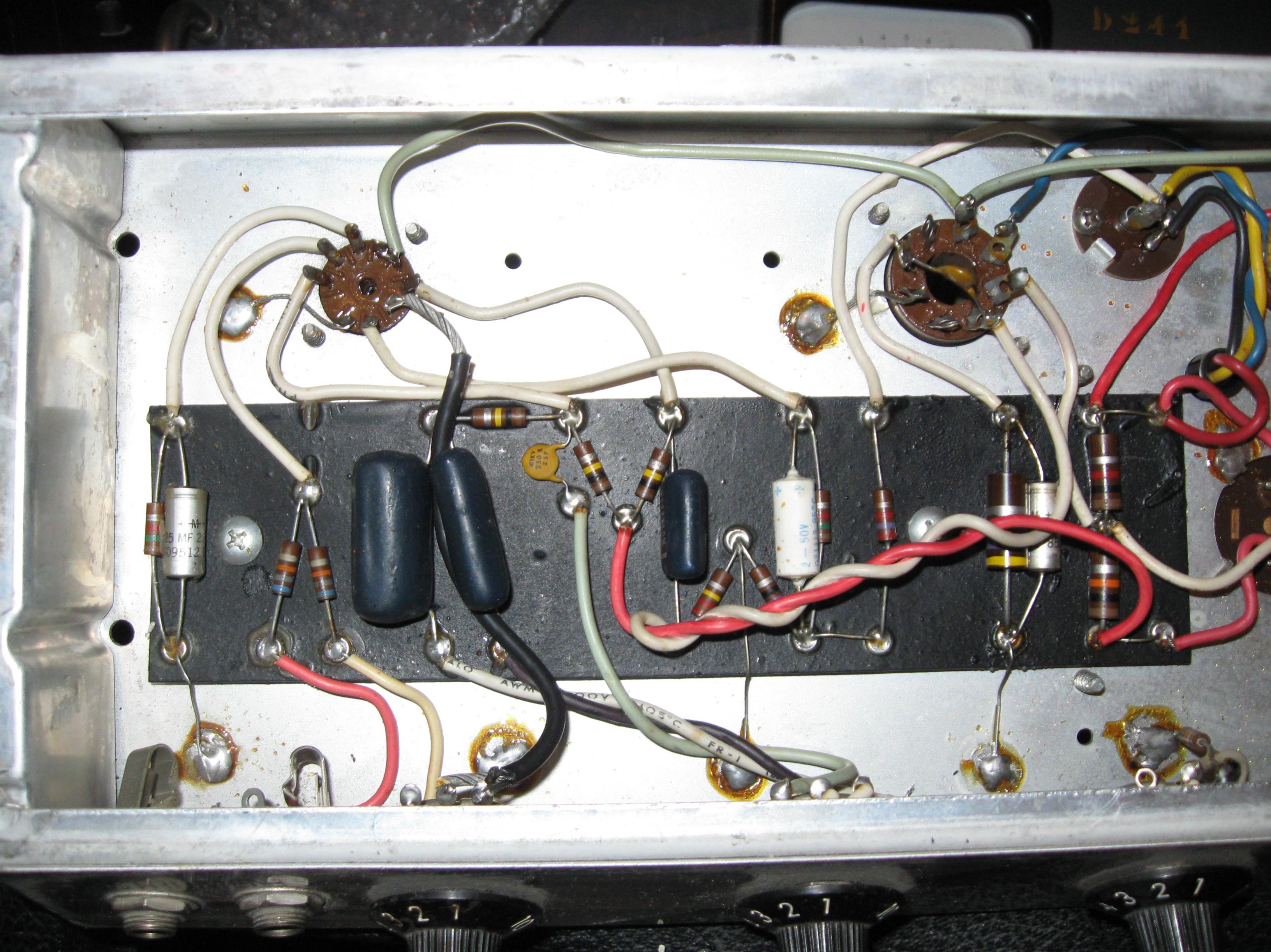

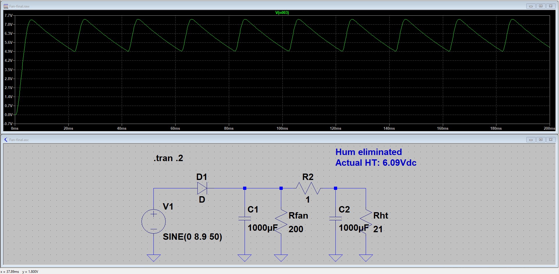

While I agree using the chassis as connections is evil, it's not always the culprit.
My 50 years old Fender Champ does just that, see photo; also note the very amateurish wiring typical of that era. With everything full up, the hum is annoying. I added a very basic half wave rectifier and a CRC filter as per the screen shot: now the hum is way below the hiss of the 1st stage.
