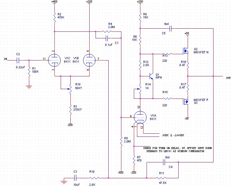

Hi, Frank -
Do you know how bad secondary emission can get in what would be considered a 'good' miniature tube with a heater/cathode potential up to 100VDC over its lifespan?
This may impact how I configure the driver stage in my hybrid amp. If as a voltage/current gain stage, its cathode will be sitting nearly two hundred volts below ground, so I'll probably split the cathode potential halfway between that and ground, but I'm afraid that secondary emission might then deteriorate my dc offset stability.

That's correct, at +/- 175VDC, and the input stage of the 6K11 will have its cathodes at ground potential. I have some concern that secondary emission may degrade long term dc offset stability in some cases with the filament at, say, -85VDC if this topology is used.
You're quite likely pretty safe.
Emission starts to occur at 30V potential difference, do you happen to have a diagram of the cct for us to look at?

This is probably more or less how it would look (I am using the driver as an inverted gain stage instead of a follower here) except that I'll be running the supply voltages somewhat lower, say +/- 170VDC instead of 200VDC. However, that still comes rather close to the maximum cathode heater ratings for the 6K11 with the heater potential centered between ground and the negative -170 V supply. Do you think secondary emission might adversely affect bias points over time?

Since I can only guess the voltages on the cathodes, I suggest you build it as you want, measure all cathode to heater voltages on all sections of the 6K11 to start with.
The problem you'll be facing is that the potentials are likely to vary rather wildly from one section to the next so we'll need to find some compromise.
Sorry, I can't be of more help to you right now.
Maybe someone with more insight into semi-conductor than i do can help you out on this one.

Thoriated: Looking at your diagram, you seemed to be in semiconductor mode when assigning values to your global feedback loop. You can cheerfully scale your resistors by a factor of at least ten, allowing you to use a much smaller capacitor than that 10uF you currently have.
You definitely need separate heater supplies for the input pair and the voltage amplifier. Expect DC problems if you don't.
