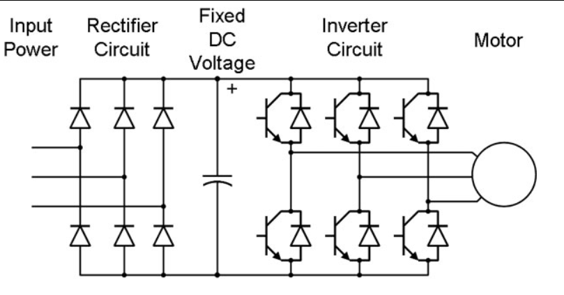

I see they have the so-called "inverter" units, where they actually vary the speed of the compressor, instead of turning it on/off. I assume there's DC somewhere in that "inverter", perhaps like the VFDs for AC motors; roughly
Most of the ones I see are 3-phase output, which sorts rules out a cheap window AC unit. Who knows if you could stack your batteries to equal whatever the "Fixed DC Voltage" is, inside one of these, which would save the inefficiency of DC to DC converting 48V up to whatever it is, maybe 10X.

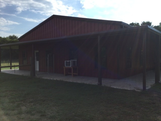

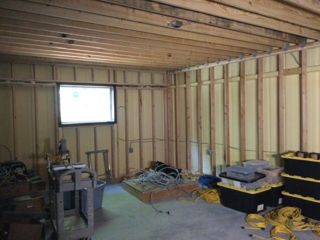

Define “boat load” - From what I’ve seen those mini split systems are quite reasonable, and being DIY-installable saves $10k+ in installation fees and stacked margins. I’m planning to use them for my build in progress. The back room in the shop is going to get a 1.5 ton, rather than replace window units every 3-5 years like in the old place. I was on the fence between 1 and 1.5 ton, but since it’s only getting hotter every year I ought to get one that I won’t run to death. Going to put in R19 everywhere. I’m probably going with two units to get six zones in the house. And a separate ducted propane furnace. The cost of the house system will still be under the 20 grand I paid to have a single 4 ton dual fuel system installed at the old house. No single point of failure, and won’t need grid power when the grid goes down in the winter. The house is still ”empty”, except all our stuff is packed into it with two window units keeping everything from getting ruined. It’s well enough insulated that these things were cycling through the whole heat wave (compressors not running 24/7).
The roofs were silver/gray from the beginning. I asked the builder which one holds its reflective properties better over time - the “polar white” or the galvalume. The white roof on my old shop turned gray after 12 years.
