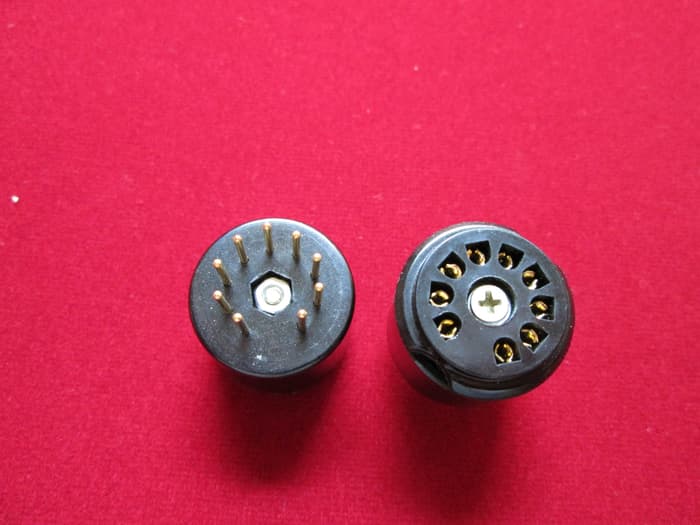

Returning to the possible modding to be made I'd replace the PSU capacitors with Nichicons KX, thay are good without spending a fortune. In case I would change the tube socket too, being very close to each other and resting on the metal platform...I suggestion could be to raise them with this socket:
Same as above. Why replace the tube sockets? What is the goal? Some other 9 pin PCB mount sockets won't sit in those same holes. What will you do when the traces fall off the board when you're reworking it?
Why do you want to use a socket saver? How much tube rolling are you going to do?

I begin from the end, I have a friend of mine runnin this amp and told me (a little con but I don't mean a grief) that it has the tendence to heat with such a disposition of the valves itselves. That was an observation, maybe depending on (intensive) use or not.
