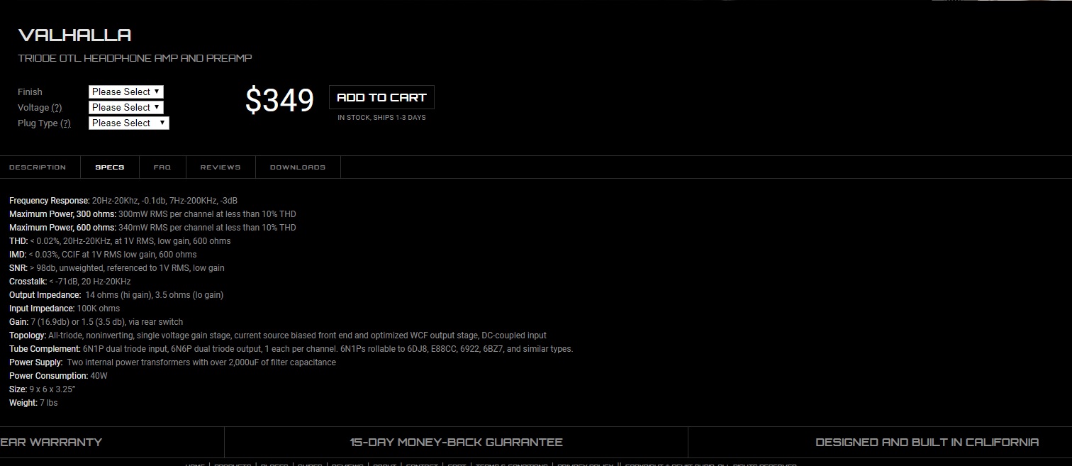

Schiit lists the SNR at 98+dB, so there's likely an external influence causing the issues that you're having.

Actually 98+ is the valhalla 2. Mine is version one and the oficial STN is 43+dB. Which matches with what im measuring here.

I just looked at the specs on the website for the Valhalla 1, and it's still 98dB referenced to 1V.Actually 98+ is the valhalla 2. Mine is version one and the oficial STN is 43+dB. Which matches with what im measuring here.

Yes those specs on their website are from valhalla 2. The site doesnt mention the number two but its the New one which they are selling nowadays. Valhalla 1 has a higher noise floor indeed.
The tubes are the same in both versions. What they probably did to reduce that much the STN?
