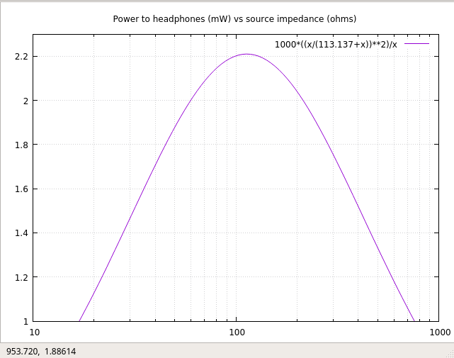

I just had a minor epiphany.
If you feed 32 ohm and 400 ohm headphones from the same voltage source (meaning zero source impedance), the 32 ohm phones receive much more power.
But if you feed each of them with the same current source (meaning infinite source impedance), the 32 ohm phones receive much less power.
That suggests that there must be a crossover point somewhere in between. In other words, there must be a specific value of source impedance, somewhere between zero and infinity, which will deliver exactly the same amount of power to either 400 ohm or 32 ohm 'phones.
So I wrote down equations for the power delivered to a load, stuck in 32 ohms and 400 ohms for the load, and solved the resulting quadratic equation with a little algebra, to find the magic source impedance that would deliver the same power to both types of headphones. The answer is 113.137085 ohms, or rounding to a sane "close enough" engineering value, about 110 ohms.
Now we have a super-simple solution to the "How do ensure safe SPL levels if the user might use 400 ohm or 32 ohm 'phones?" conundrum. Simply put 110 ohms in series with the 'phones, and you're done. 🙂
There is a downside: bass response of headphones varies with source impedance, and there is no guarantee that your phones will have their flattest frequency response when fed from a 110 ohm source impedance.
But at least switching headphone impedances won't blow out your ears!
To do a sanity-check on my algebra, I also used Gnuplot to plot the power delivered to the headphones from a 1-volt source with a 113.13708 ohm source impedance. The result is attached; the x-axis is headphone impedance in ohms, the y-axis is power delivered in milliwatts.
Note that x=32 and x=400 both receive the same 1.5 mW of power.
Note also that any headphone between 32 ohms and 400 ohms will be safe to use; power only goes up from 1.5 mW to 2.2 mW at the loudest headphone impedance (which, of course, is also 113.13708 ohms, as per the maximum power transfer equations we've probably all seen.) This is only a 0.7 dB increase, which is negligible as far as ear safety goes.
-Gnobuddy

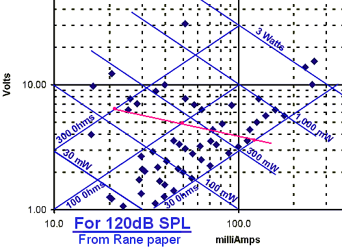

You found an electrical optimum.
Headphones also vary in sensitivity, and for reasons mostly historical, the low-Z phones tend to be less sensitive and more rugged than the hi-Z phones. And MANY outliers.
I've written this, with much data and graphs, at least twice this week in the Headphones section.
It worries me that the lowest power level on that particular graph is 30 mW, already capable of 115 dB SPL with typical (100 dB@1mW) 'phones. 🙁...data and graphs...in the Headphones section.
Some four years after joining diyAudio, I didn't even know we had a headphones sub-forum!
-Gnobuddy
It worries me ... 115 dB SPL ...
Actually the graph is labeled "for 120dB SPL". There's a story. Not relevant. I *know* you can do math for a less dangerous level.
